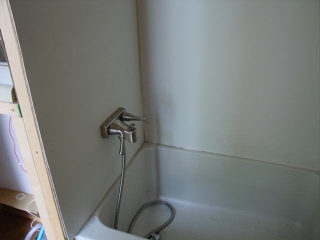

Bathtub/shower with surround installed.

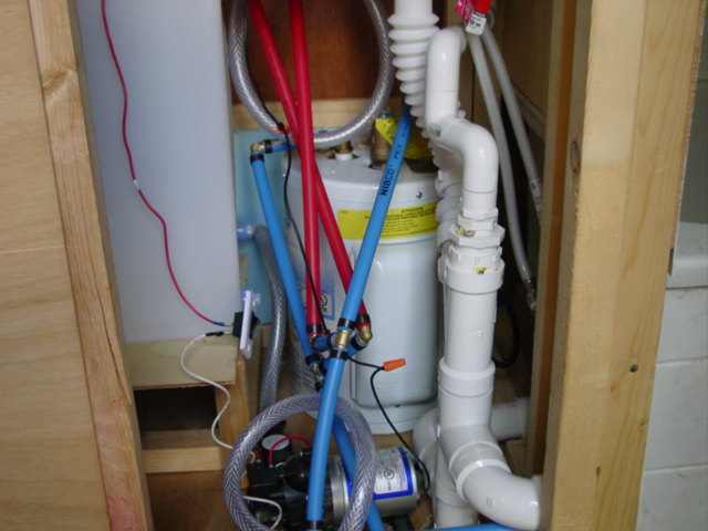

Plumbing under the sink. Haven't tested for leaks yet.

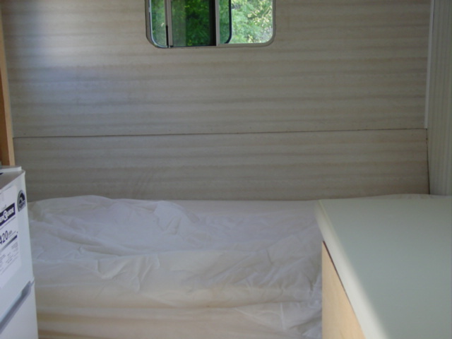

Bedroom with the bed in place.

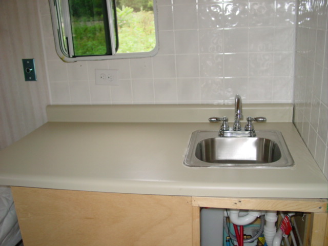

4' kitchen counter. I like lots of counter space and have found you can never have too much!

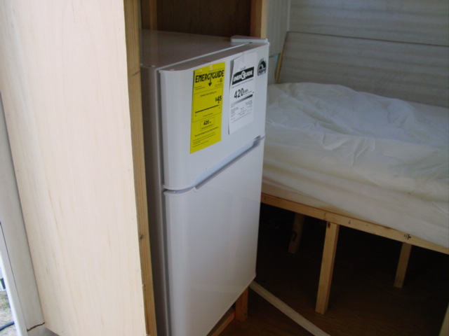

Refrigerator with separate freezer. Works much better than those tiny dorm refrigerators and their worthless freezer compartments.

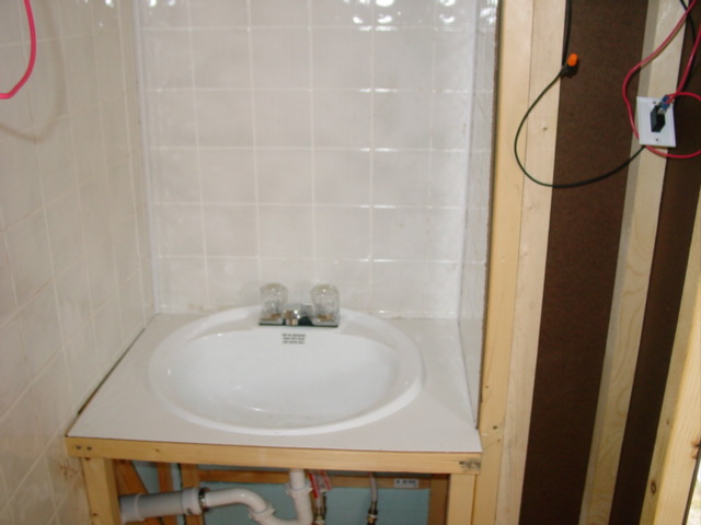

Bathroom sink. I used the surround material for the top.
