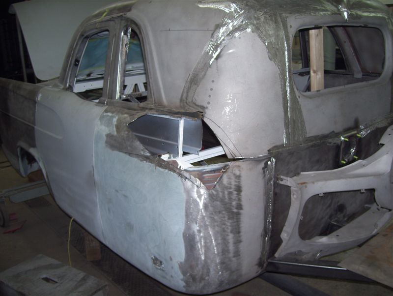

Re: Building Miss Piggy
Postby Vedette » Sun Jun 17, 2012 8:55 pm
More progress93667936669366593664
Had to go find another set of Studebaker rear doors to build the quarter windows.....wanted more side light.
So another quick trip to the USA. Thanks Allen!
