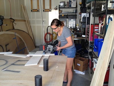

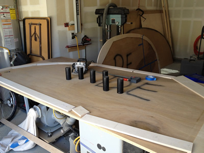

Time for a wall update...
After I used my new profile template to draw an outline of the profile on a 1/8" ply side, I began piecing together 1/2" Baltic birch plywood (no voids) to form an edge around what will become the profile.
Unglued raw plywood edge.
2012-07-28 16.18.44-small.jpg (65.13 KiB) Viewed 3743 times
My lovely assistant Alana (youngest daughter) cut biscuits in all of the contact points where 1/2" ply touched 1/2" ply. This greatly improved the strength of the sides and made them much easier to move around after the glue dried.

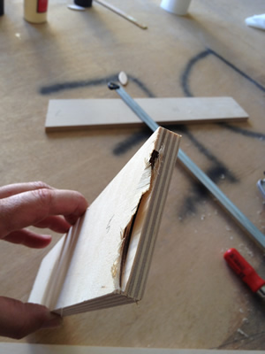

But sometimes mistakes are made...
Oops...
2012-07-28 16.58.38-small.jpg (34.9 KiB) Viewed 3743 times
On to gluing things together.
