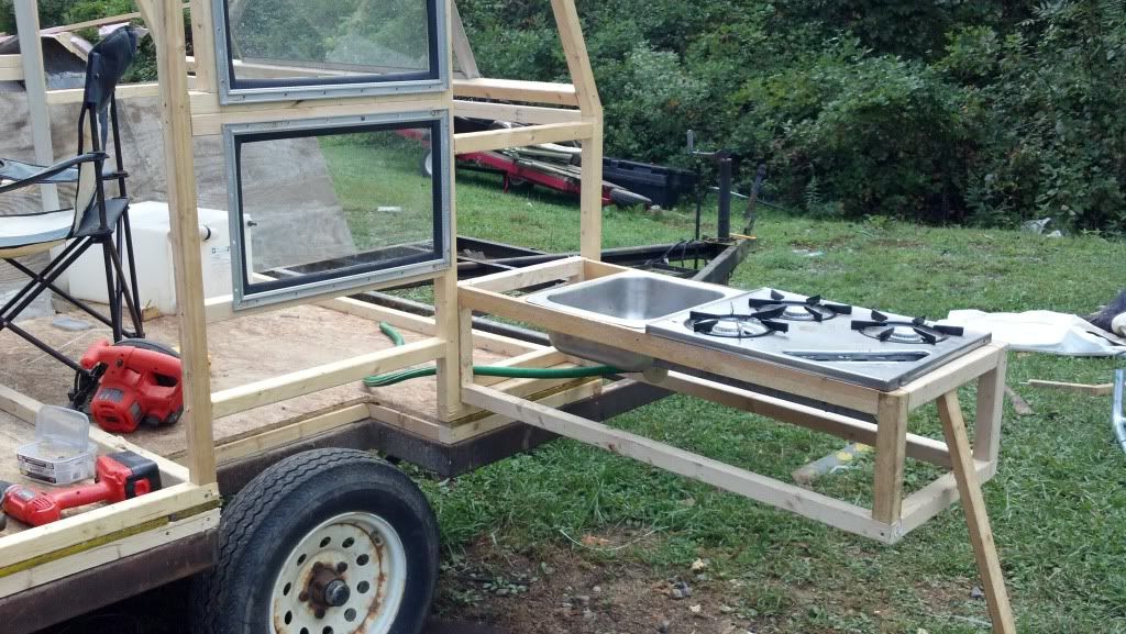

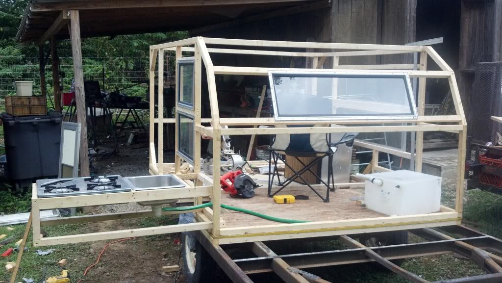

Postby sumo » Sun Sep 02, 2012 7:14 pm
This is what I am thinking about doing withnthe galley. After getting a little more done I realized I didn't want to use up the floor space in the rear for the galley.

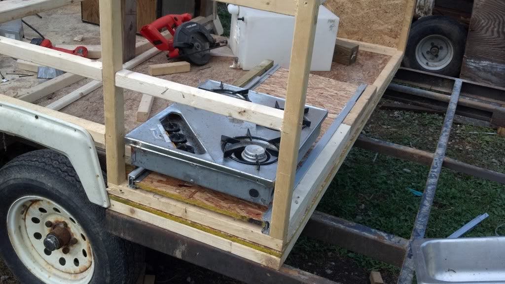

Postby sumo » Sun Sep 02, 2012 7:36 pm
Here are a few of it pushed in, there will be a bed over this on the inside.

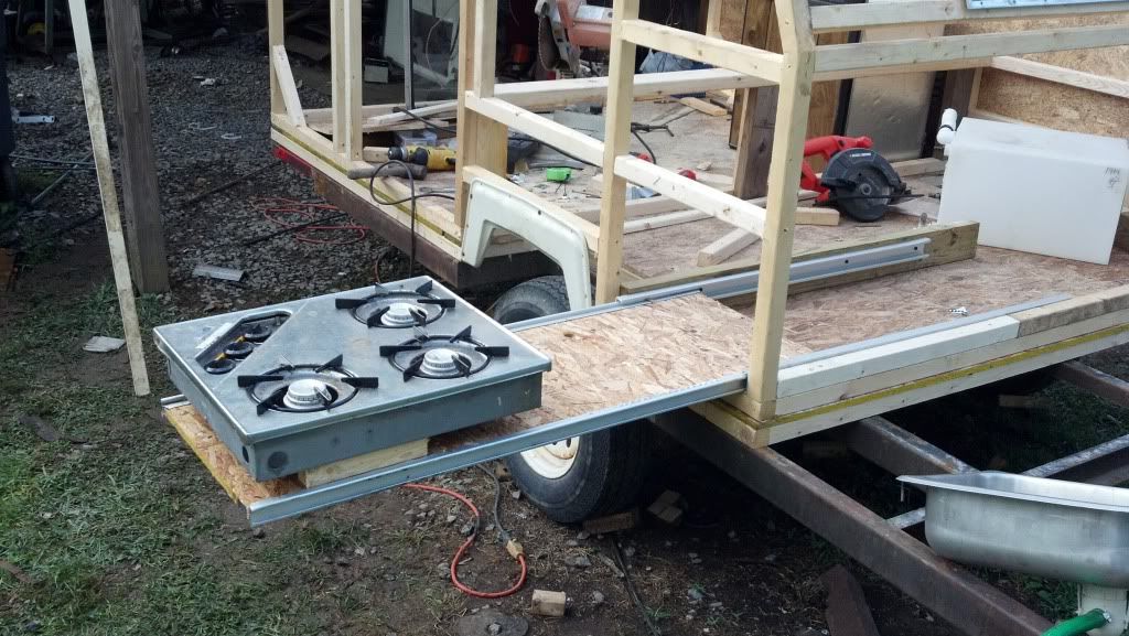

Postby sumo » Mon Sep 03, 2012 6:35 pm
Added sliders

Postby Martinup » Tue Sep 04, 2012 4:56 pm
I like your sliders Sumo:
Where did you get them (Link?) and what are they rated for, Do they come in different lengths . . . Bearings etc?
I am doing something the same but different. I targeted a 36" top of counter hieght for mine.
You could easily replace that OSB with a nice peice of metal of some kind, fire-proof /durable out door finish and rust proof . . .
Also curious on that fender flare piece : where from, what material etc.
LQQking good,
Martin
Martinup
Posts: 115
Images: 36
Joined: Sun Feb 26, 2012 9:15 pm
Re: teardrop toy hauler
Postby sumo » Tue Sep 04, 2012 5:29 pm
The sliders are the bed sliders from the pop up camper, I will probably replce the osb with something else, I was mainly mtrying to set the internal parts of the sliders.they are very strong.

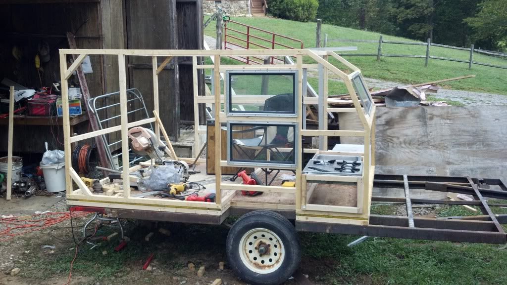

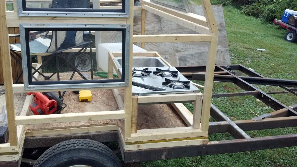

Postby sumo » Wed Sep 05, 2012 6:43 pm
Little more progress

Postby Forrest747 » Thu Sep 06, 2012 10:44 am
What are teh dimensions of your trailer body. NOt the frame but what you are building. i see its about 6 feet wide but sondering how long. If i al looking at it right you have the bed toward the front and over the galley slider which i think is brillant. how much head space above teh bed will you have.
Forrest747
Cowbell Donating Member
Posts: 1327
Images: 447
Postby Junkboy999 » Thu Sep 06, 2012 10:59 am
Nice LAS's
( Long A** Slides ) :R
Junkboy999
Posts: 1259
Images: 52
Location: Wichita, KS
Postby sumo » Thu Sep 06, 2012 11:39 am
The camper part is 6' 1 inches x 8 ft. the whole traielr is 6' 1 inches x 12 foot, You are correct the main bed is over the sliding galley, I put the bed in the front in part because of weight, i wanted to keep as much weight forward as possible. THe main bed will be 4 x 6 ft and the other bed will be 2x6. the hight of the bed is about 15 inches without and padding. I can sit up without hitting my head on the roof spars. I am probably goint to put some sort of raisable roof on it .
