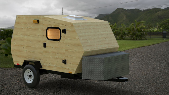

Re: Nano Weekender
Postby mikeschn » Sun Oct 14, 2012 6:49 pm
Painted with white paint! :D
That's it for this weekend!!!
Re: Nano Weekender
Postby S. Heisley » Sun Oct 14, 2012 7:06 pm
That's a nice looking trailer. ...Good Drafting Job! :thumbsup:

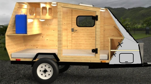

Postby jonw » Mon Oct 15, 2012 4:44 pm
Hi Mike -
Have you thought of making the front more of a V nose instead of a flat panel(s)? I've found a lot of new vehicles bring the wind close in behind themselves as a way of increasing gas mileage, but when towing a TD the winds hit smack in the front of it.
On my CRV I lose about 10 mpg towing my small 700lb. teardrop. Behind my miata (which is much shorter in height) I only lose about 4-5 mpg. Both vehicles have 2 litre 4 cylinder engines. The difference is the wind management (or lack thereof).
I'm currently working on building a detachable "nose" for the front curve that will deflect the wind around the sides of my teardrop.
You could accomplish the same thing by making the front surfaces of your weekender a mild V-nose, maybe as Jenn suggested bringing the front top section angle (with a nose) all the way down to the tongue. Inside of it could be storage. Without a curved front this should be pretty easy and straightforward to do.
Just an idea... :D

Postby mikeschn » Mon Oct 15, 2012 4:51 pm
It's a good idea actually, Jon. I was thinking about trying to do a tongue box that integrates that feature.
What I don't want to do is add too much detail to the cabin body. I'd still like to be able to build it in a "long" weekend.

Postby jonw » Tue Oct 16, 2012 10:13 am
I roughly modified Mike's rendering to illustrate what I was thinking about for a nose. The nose would simply be flat panels of plywood (or whatever) that goes to a mild point to divert the wind. These could be in addition to or instead of (my choice) the flat front top and bottom panels.
Some additional possibilities shown in this drawing are:
  • adding a door on one side of the bottom of the nose to provide tongue box-like storage for fold-up chairs, side awnings, etc.
  • putting a shelf/floor above the storage area to give more usable and accessible storage space to the headboard storage compartment(s)
jonw
Titanium Donating Member
Posts: 525
Images: 163
Location: Marlboro, Mass.

Postby mikeschn » Tue Oct 16, 2012 5:08 pm
Jon,
That looks pretty good.
Here is something I modeled last night, but I'm not real happy with it. (Which is why I didn't post it last night)
I plan on modeling your concept to see how it looks!

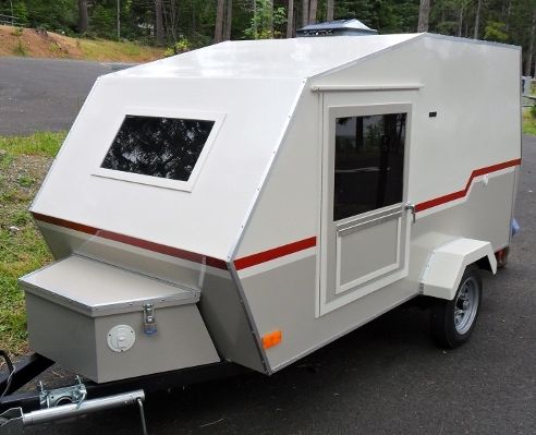

Postby rmclarke » Tue Oct 16, 2012 9:01 pm
this is what I did....Image
the top is not hinged; it lifts off, held in place by two padlocks. Inside is a marine battery, an inverter, all my electrical cables, short garden hose, wheel chocks, jack stands, and miscellaneous tools....it's not real big but it works for us
Richard
