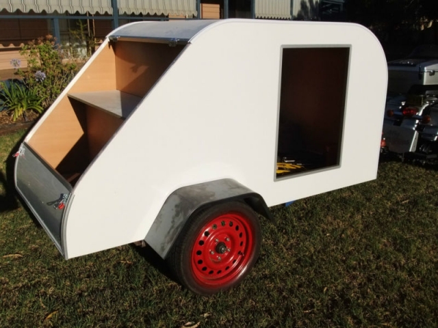

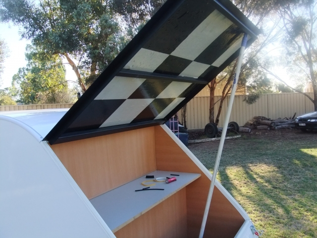

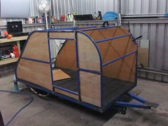

Hi all - well I have something to admit. I cheated! I have purchased an unfinished project teardrop. I will post a few photos of it soon. It is a steel frame construction with timber sheeting interior, foam inserts in the wall and Alcopanel on the outside. The guy looks like he has done a pretty reasonable job to this point. All I need to do is do some wiring, add the side door/window and fit a mattress - and perhaps do some finishing on the kitchen. Then ill be off to exploring. Cant wait. I still have to work out a way to get it moved from Victoria to the Qld but im sure ill work that out. Perhaps a road trip to collect it is in my near future!
Regards,
Hamish

Re: A Teardrop to tow behind my new Kia Rio SLS
Postby Hamish121212 » Thu Jan 31, 2013 11:34 pm

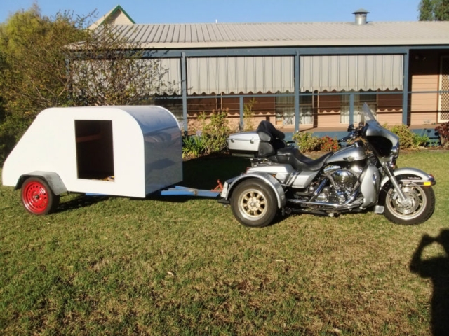

And no that is not my trike!

The insulation going in.

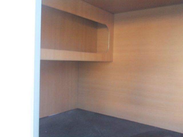

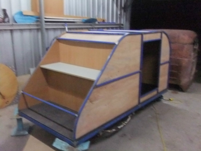

Postby Hamish121212 » Thu Jan 31, 2013 11:42 pm

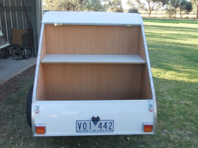

The internal joinery - needs some doors on those shelves - and a window I think. The black floor is aparently a sheet of some sort of high density plastic - something like wheelie bins are made of. I guess the good thing is it will never rot!

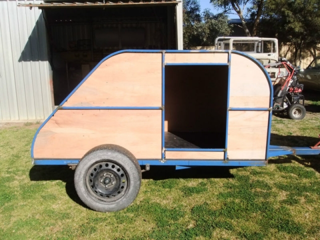

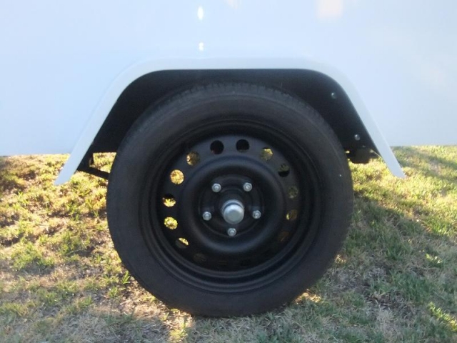

Postby Hamish121212 » Thu Jan 31, 2013 11:44 pm
The wheels and mudguards painted. Im tossing up between replacing the steel holden wheels with mags or just adding baby moon hubcaps and rings to the wheels.

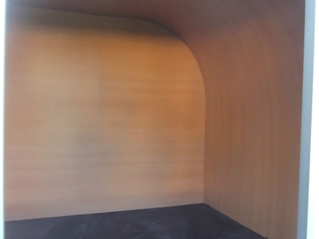

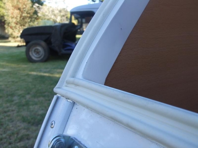

Postby Hamish121212 » Thu Jan 31, 2013 11:45 pm
I really hope the seals will keep the water out. Anyone got any tips on how to correctly calculate the correct gas struts (NM rating and length) to keep the door open and help lift it. And also how to find the best location to mount them?

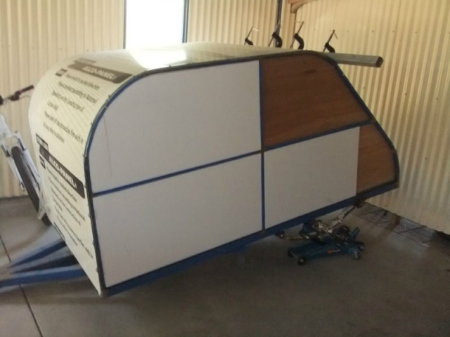

Postby Hamish121212 » Thu Jan 31, 2013 11:47 pm

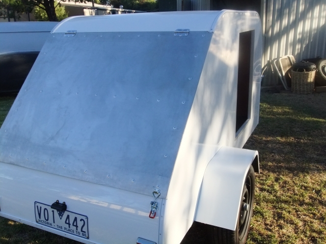

This side of the van needs a window to create some cross flow ventilation. Although the big blank space could be used as a moving billboard for my soap business and backdrop for the markets! The side pannels and the roof is glued to the metal frame using sikaflex on every part of the frame and trailer - so it will be well insulated and water tight. The aluminium molding is pop riveted into place along the edges and the front. The back door is made of a frame covered in a 3mm thick piece of plate aluminium pop riveted into place. This will probably be painted white to match the rest of the trailer - think it will be too much bother to polish it. Thoughts?

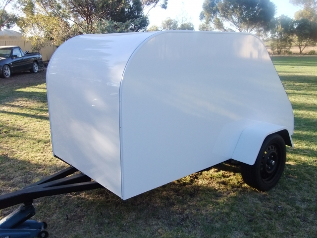

Postby Hamish121212 » Thu Jan 31, 2013 11:49 pm
Its not the prettiest teardrop out there but it is well built and super light weight and I think it will be really comfortable once I add a nice mattress and some finishing touches. Cant wait to pick it up.
