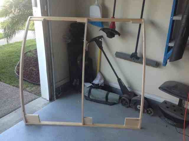

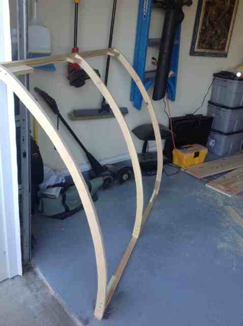

Postby stanimal » Sat Mar 30, 2013 10:26 pm
Moved on to some other work today. I want to start making the shelving, and the foot area of the inside. In order to do that, I need to get an idea what my clearances for the hatch will be. Did a general frame out for the hatch. I cut the ribs from 1X12 pine boards. They are two inches wide, and are secured on top and bottom by 1X2 boards.
I made them intentionally narrower than the internal dimension of the hatch opening. When I got them in, there was still a clearance problem. They weren't quite square, and there was a slight bowing outward in the middle. The blocking you see cleared up 90% of the clearance problem, and once I start running spars across the center, that should eliminate any minor outward bowing.
Outside will be birch ply, just like the walls. inside of the hatch will most likely be peg board material, so that when it is open I can hang things such as a lantern, cookware, etc from hooks.

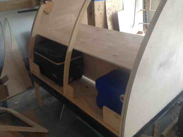

Postby stanimal » Sat Mar 30, 2013 10:32 pm
Here are pictures of the hatch door clamped in place to gauge tolerances.Looks like I will have enough room.
The other photo shows a dry fitting of the rear shelf. I'm not going to do rear cabinets. We will most likely haul all of out gear inside the sleeping area of the trailer, then set up the rear area when we arrive.
It was good to get back into building things that are really visible. Helps the morale. Last weekend was lots and lots of sanding, especially of the floor.

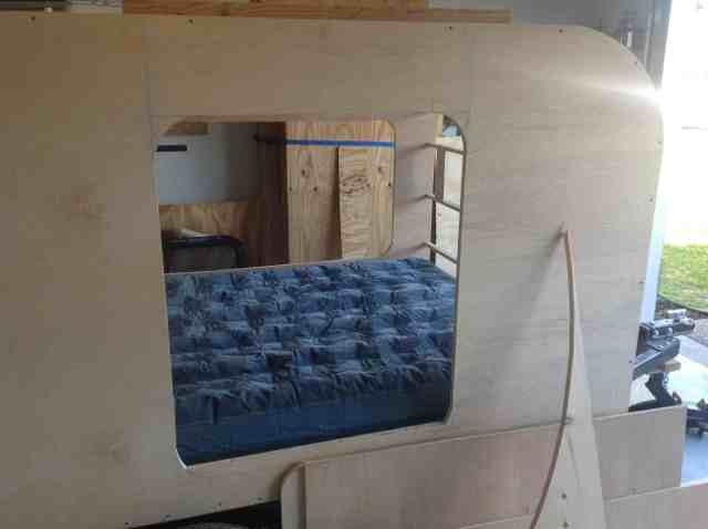

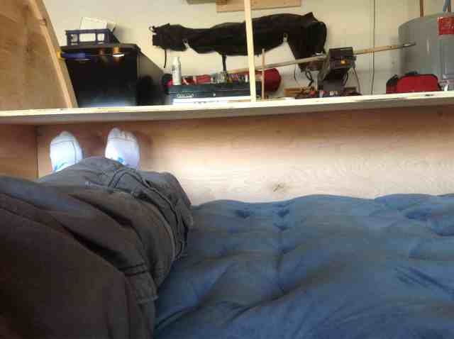

Postby stanimal » Sat Mar 30, 2013 10:42 pm
Almost forgot. First picture here is a picture of the fix for the door clearance. I ripped two inches off of the bottom of the door, then picked up a doweling jig. Four wood dowels some glue, and three screws later, and the two inches I ripped off the door bottom are back attached to the wall. Some sanding before paint and you shouldn't be able to tell too badly.
The second photo is checking the foot clearance of the rear shelf, which will also serve as the bottom of the interior cabinetry.

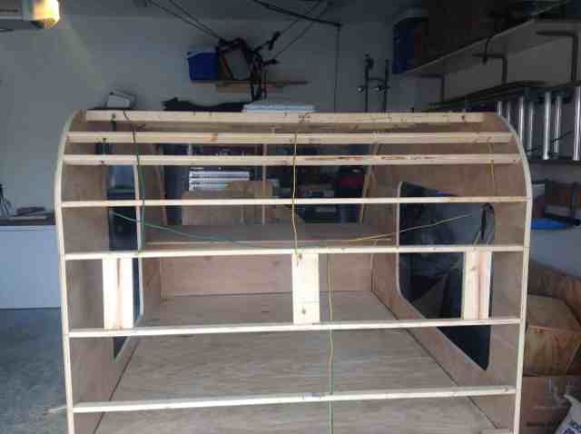

Postby stanimal » Sun Mar 31, 2013 4:23 pm
Just a few more things done today. Installed the rear shelf, framed out the opening for the roof vent, and drilled out holes to run the wires for the brake lights.

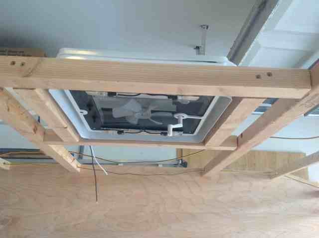

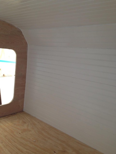

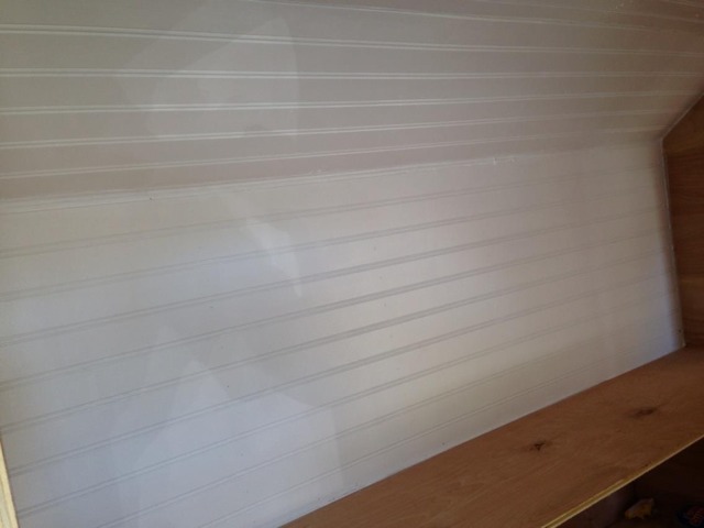

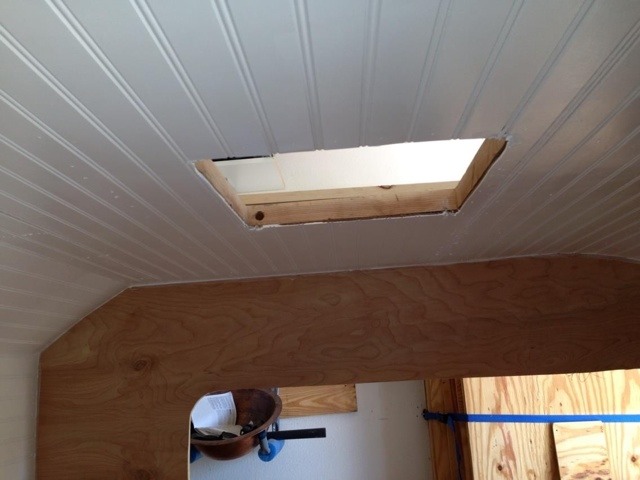

Postby stanimal » Sat Apr 20, 2013 5:48 pm
Been a couple of weeks since I was able to get anything substantial done.
I installed beadboard ceilings, They did not bend quite as well as I wanted, so the inside is a little more angular than designed. I got it all caulked and painted this morning, and cut out the ceiling hole for the vent and fan.

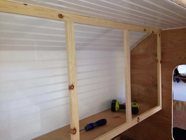

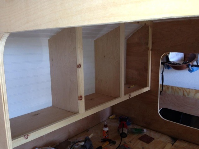

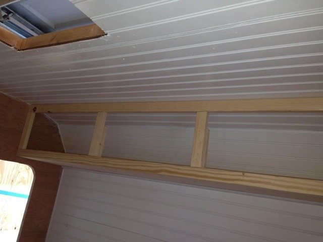

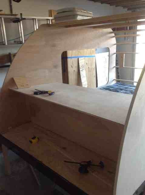

Postby stanimal » Sat Apr 20, 2013 5:51 pm
Also started to build and install the cabinets. I bought a finishing nailer to install the beadboard, and have used it so much on other things. I'm really not sure I could have done the rest of the trailer without it.
I'm going to have to make the cabinet doors sometime. The small cabinets will have hinges at the top. The larger cabinets will have two cabinets with doors, and the center cabinet will stay open for an Ipad to be mounted for video.
