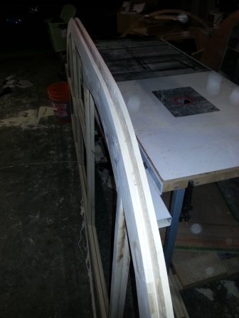

I now have a left and a right wall frame! I routed the 1/4' rabbit around the cabin where the ceiling will be installed.
The walls match pretty well

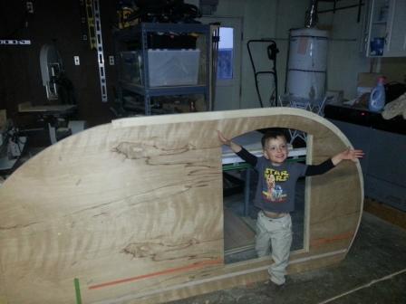

I finally got my mid-year bonus and was able to get the NT trailer. I didn't get any pics together but I figure you guys have all seen a NT trailer in its basic assembly.Of course I missed the sale AGAIN and had to pay full price. I decided that I wanted to use a single piece of ply for the base. I checked out the local lumber and they wanted $158 for a 5x8 piece of plywood :shock:. I looked around and found a discount retailer that had 5x10 plywood seconds for 37.50 so I figured it was worth the 60 mile one way trip to check it out.The store also had a couple of sheets of pre-finished maple ply for 30 bucks so I picked that up too. The wood itself seemed pretty good with some knot holes on what will be the bottom. The seams on the top were filled but not sanded so I did what any good parent would do.
Can we say hurray for child labor. :D

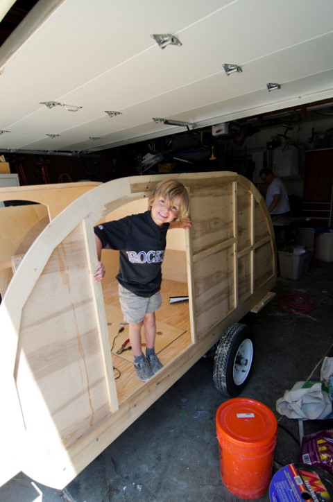

I dry fit the side walls and trimmed the floor to the correct length.The fresh cut piece looked good with no voids or anything so I think that I will go with it. I will have to make sure that I get a good seal with the black goo.
here is a pic of the side walls temporarily clamped to the trailer.I put in the insulation in so I can get a better idea of the space:
Next I will have to remove everything, connect up the lights, Install the fenders and take a trip to the DMV.
In the meantime I needed to do the hard work of cleaning up after myself.

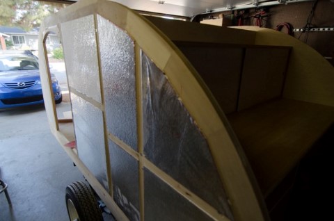

Postby jeporter25 » Tue Jul 15, 2014 3:48 pm
Well after a long hiatus I am back at it. To be more specific I got back at it in late May and I have been chugging along at it since. too busy to post and all. I will make several posts so and try to make this sequential.

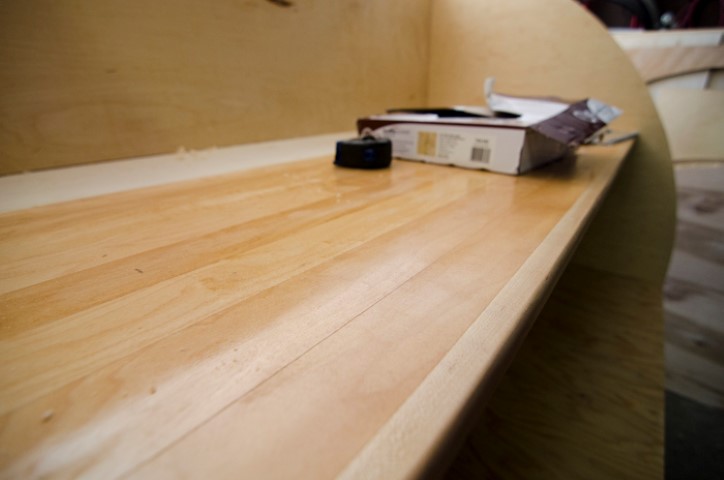

I skinned the interior walls with 1/8 pre-finished maple in the middle of May. I built the bulkheads out of 3/4 pre-finished maple.. The walls were glued and screwed to the trailer along with the counter and bulkheads. The counter is made of maple flooring that I sanded and re-finished.

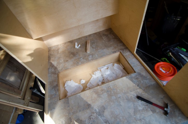

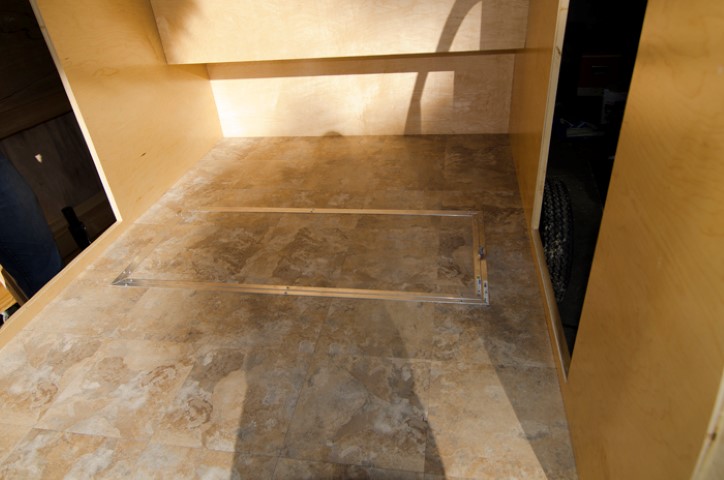

I next installed the flooring. Just cheap peel and stick but It goes under the bed and should be easy to replace if I got that urge.

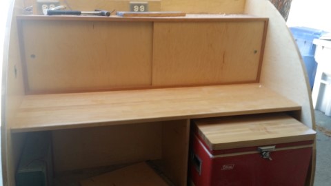

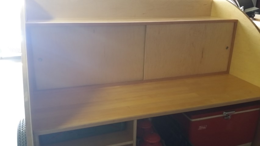

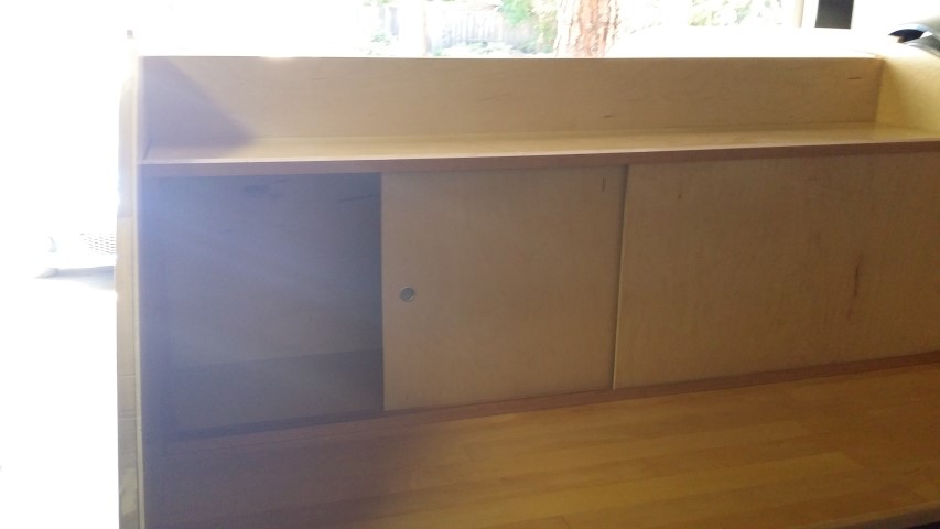

I next built the upper cabinets for the Galley. I decided to make the doors sliders so that I don't have to clear off the counter top in order to get to stuff in the cabinets.I am still toying with the lower cabinet layout.

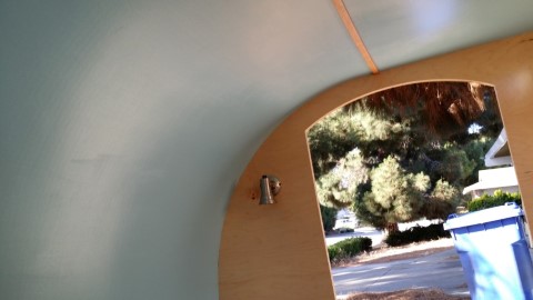

Postby jeporter25 » Tue Jul 15, 2014 4:36 pm

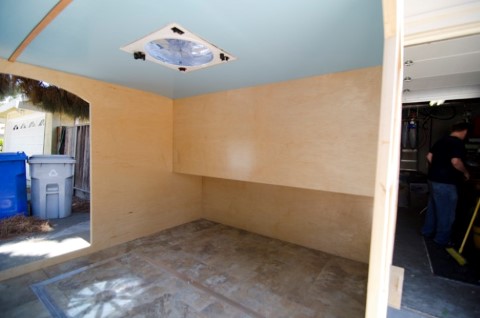

Next came the headliner. I my hardwood supplier didn't have Pre-finished Maple in 1/8 so I decided to go with unfinished birch. I sanded, primed and painted the headliner and installed it with the spars. I used cherry to trim the seams in the headliner. I also installed the reading lights.Please enjoy

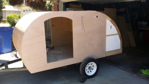

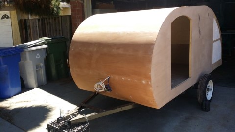

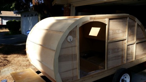

Re: TransPorter build 5x9
Postby jeporter25 » Tue Jul 15, 2014 11:13 pm

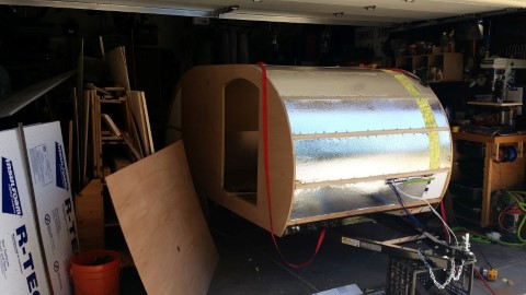

Next came exterior skin.
