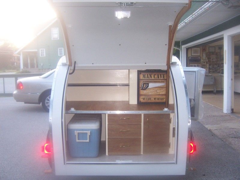

Postby len19070 » Wed Apr 03, 2013 5:05 pm
Junkboy999 wrote:What happen to the one you built last week?
:lol: Ha ha hahahah :lol:
You doing anything special for a seal on the sides of the hatch?
I do, but I can't find pictures of it at the moment.
I always run the outside molding through the hatch area, a continuous run, front to back and build the hatch area in about 3" each side.
Another trailer but maybe a better view.
I run a second insert molding on the inside of the hatch on the body of the trailer. This becomes the seal for the hatch.
I make the Hinge, and I use an offset hurricane hinge" 2/3" shorter than the distance between the 2 outside moldings which is a 1 1/2" on each side overhang. (+-)
This gives the water a 1"(+-) channel for it to escape.
For water to get into the galley it has to run down, make a right or left turn, run up hill and jump over a 3/8" barrier.
Be at one with the gravity! Waters like talkin to a teenager, no matter what you say, it'll do what ever it wants. And then say Duh!
Photos to come.
