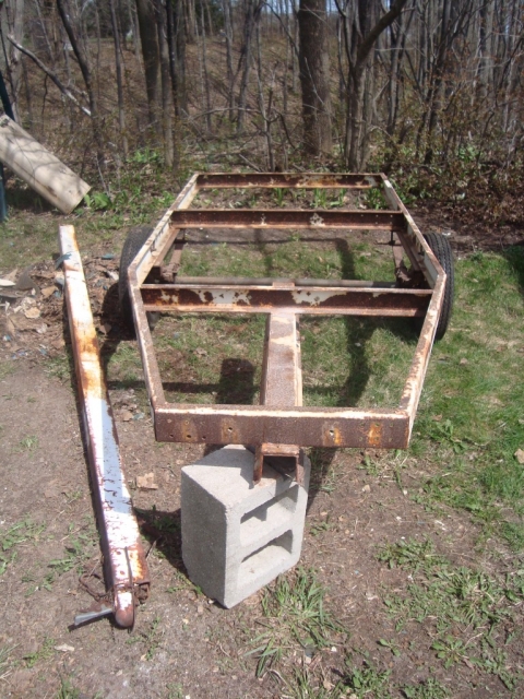

Alrightee then! You are making progress!
That frame looks to be in decent shape. Should clean up nice. Sturdy, too. Boat trailers have a lot going for them from a TD perspective.

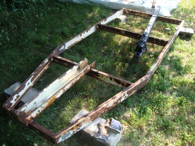

Postby Dirke » Thu May 23, 2013 6:10 am
Well, the Spring pick-up was this week and much to my delight they picked up all of the pieces of the boat. That officially makes the trailer absolutely free (if you don't count all the work of cutting the boat up into managable pieces). I took the frame off of the axel and my buddy is going to check and clean up the welds. There is one crack weld for sure but he says he can fix that no problem. He is also going to add a piece of metal on the corners for extra strength. So, sometime soon I will be able to start cleaning it up and get things painted.

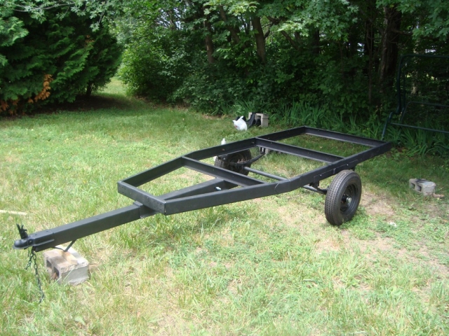

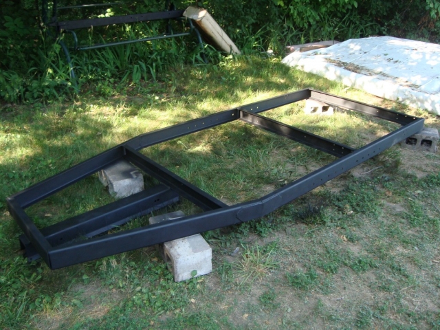

Postby Dirke » Tue Jul 09, 2013 1:27 pm
Well, it has been a while since I have posted. I had too many things going on and didn't have time to work on my project. A buddy of mine did some welding on the frame and things are ship-shape now. I got out my angle grinder and cleaned up all the rust then painted it with some "Rust restorer." Don't know if it is any good but it was easy to spray on, leaves a nice flat black finish, and will be easy to touch up. I don't think I will paint it with anything else. Here is a pic of what I used.
Here are some before and after pictures of the frame:
Before:
After:
Overall, I am pretty happy with how it turned out.

Bearings
Postby Dirke » Tue Jul 09, 2013 1:35 pm
I got an early start this morning and managed to get new bearings installed and everything put together. It looks pretty great. Now I can actually start to build the frame and add the box. Time to hit the lumber store for some treated 2x4s.
Here is another before and after shot. I had my buddy shorten the tongue quite a bit as it was extremely long and heavy. Much better now.

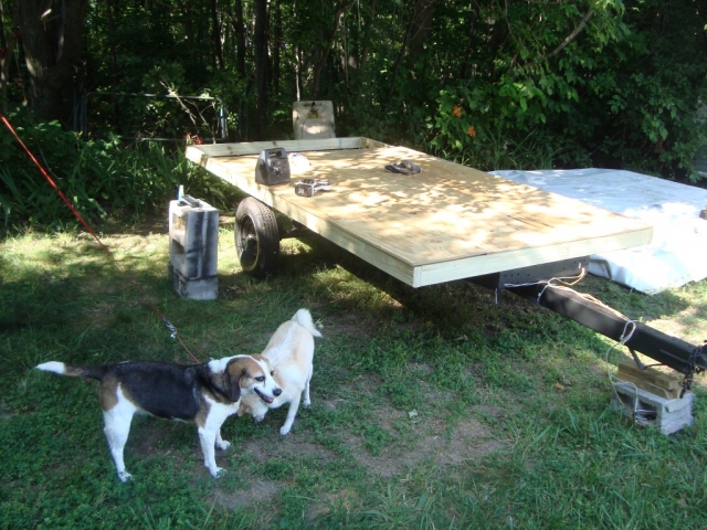

Postby Dirke » Thu Jul 25, 2013 10:31 am
Well it has been very slow going but I am finally making some progress. I now have a flatbed! I took it to get weighed and it weighed in at 480 lbs. Not bad considering the boat trailer itself is most of that weight. I should be able to keep things well under 1000 lbs.

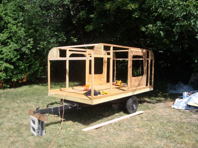

Postby Dirke » Thu Jul 25, 2013 10:34 am
Yesterday I managed to get the other window framed in. I think they are going to look pretty good once I get them in. Still not sure how I want to finish the sides. I am tempted to do the titebond and canvas to keep things light and simple although I am leaning towards using FRP still.
Here is what I have so far:
The scrounger
Dirke
Posts: 129
Images: 59
Joined: Wed Feb 13, 2013 5:30 am
The walls are up
Postby Dirke » Thu Jul 25, 2013 10:37 am
Well, I am making some mad progress today. I got the walls up and everything even looks square! I haven't glued the spars in yet and I have a few more to add. Time for some tea and head scratching to see where I want to go from here. Very encouraging so far. I would love to get out at least once before summer ends and the baby is born.

Postby Dirke » Mon Jul 29, 2013 11:55 am
Here are some updated pictures. Right now I am working on the door and bending some plywood over the ends so I have some time while I wait for the wood to take shape.
Here is a side view. You can see the bunk I made in the front (5' x 2') for the little one to sleep on (until he is taller than 5'). I threw the futon mattress in there just to see how it fit. Works so well I was tempted to take a nap.
Here is the view of the sleeping area and the galley wall. At the top of the wall I put a screen window for extra ventilation when the hatch is open. Above that is a storage area (no doors yet).
Here is a view from the other side. I put the window in just to see how it would look. The door (only one) is next to that.
I hope to get things on the outside finished up to go camping in about two weeks. Can't wait!
