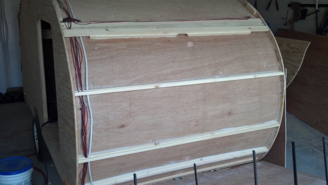

Skinning the outer shell. I messed up the sequence but here it is anyway...
I ran the wiring through the space in the roof

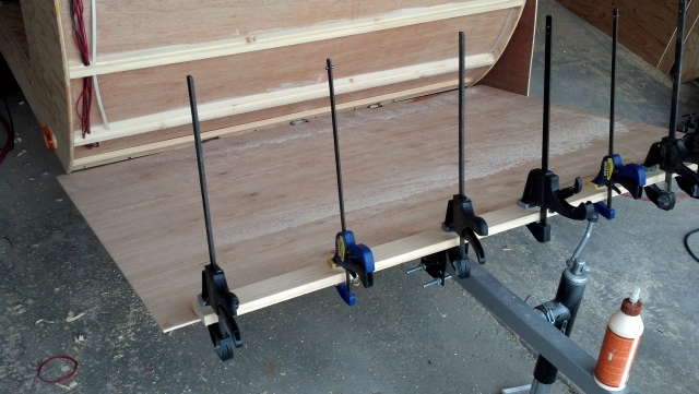

I used the same method for the outer skin as I did for the inner skin. I glued a cross brace to make the edge stiff and straight and so I could attach it to the "next" section

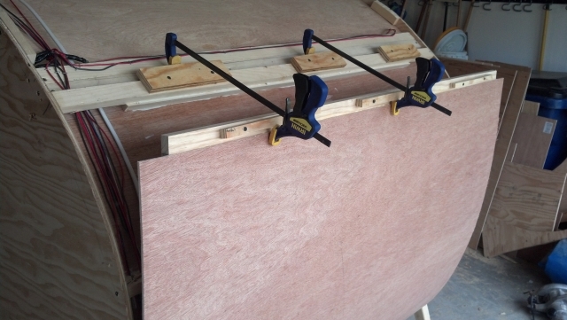

It was a bitch to get this sheet bent around the curve. I had to get creative.

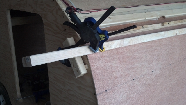

One cheap clamp wasn't enough.
I didn't get a pic of it, but I glued a cross brace on the next sheet and attached them together. Then when I drew the next section down into place, it pulled the two sheets as though they were one. I ended up clamping a section of 2x4 across the joint until the section dried as it still wanted to bow out a little bit.

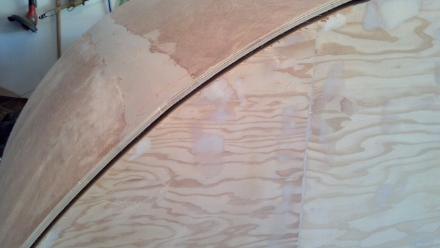

There are a LOT of steps I've left out, but at this point, I am almost ready to prime my wagon. This pic is just after I updated the edge to get it ready for the trim and weather stripping.

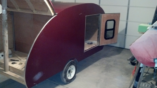

Monday morning. Just about to start another day. This is after a very busy Saturday and Sunday. Saturday was all about sanding. This is after the first coat of paint.
After a LONG day, the camper is painted, hurricane hinge is installed, trim and weather stripping on the hatch is installed and the first door and window are installed.
I hope to get the other door and window installed tonight.
