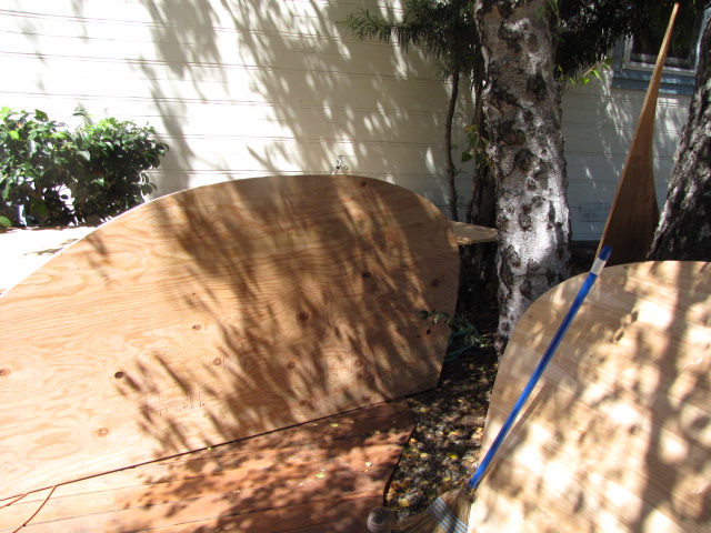

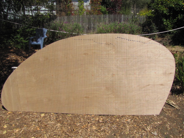

Rough cut my sides today and purchased the wood for the base. Haven't ordered a trailer yet but will do that when I get back from vacation.
My lumber yard had 4 x 10 sheets of structural grade CDF plywood. So no splicing. Without the door cutouts, they weigh about 58#'s rough cut so maybe 40# with the doors cutout. My plan is to use 1/8" birch laminated to the inside. I will seal the outside with epoxy and float aluminum.

Got my Whiteside bits. I splurged and got a top and bottom bearing. Thought I wouldn't need both but I needed them right away because of the way i pieced my template together! I found it easier to route one side from the bottom and one from the top.
I am finding out how difficult it is to execute each step perfectly and already made a couple of mistakes doing the routing of the sides. My respect grows for those beautiful woodies out there.
Tomorrow, I'll work on the splicing the floor sections and maybe cutting out the blocking for the top. I also want to lay my plan out on the sides to see how it feels full size. Then I am stalled until I get back from Belize and order the trailer!
