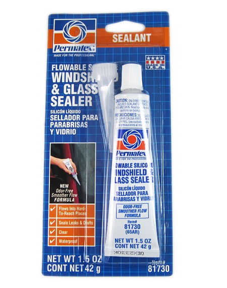

TODAY'S UPDATE:
I used "the mix"/ "magic mix" to seal the walls (i.e., all the 2x3's that aren't the subfloor) as well as the part of the floor plywood that I didn't seal the top of yet.
I also scraped all the old foam gasket off of the underside of the truck/camper cap. I also tightened up a number of the short screws inside the camper cap that hold the paneling in place and confirmed that the cap IS insulated!! :applause: 8)
BUT...I also confirmed that there are a couple of places that leak by running hose water over the top as I used some soap to scrub around anywhere that I may use silicone to seal.
One place leaking is in the front sliding rectangular window. I spent some time taking a LOT of screws out (stripping a few heads) just to remove the paneling-frame around the inside of the window to see what was inside the walls and see if/where I might be able to seal and maybe where that leak comes from. After playing with the window sliders and pulling out some of the rubber seals I switched the top & bottom seal as the bottom one was kinked or folded in and not sitting against the glass very well and MAY be letting the water in and channeling it. I'm not sure if this will help or not as I won't water test it again until tomorrow. I will silicone any non-moving parts and give it a few hours before I leak test it again.
Another leak area is the left/driver's rear corner which is likely due to the exposed holes left by screws that went all the way through for what was likely a cap-mounted set of racks. A former owner was a beach camper so it was likely they had some utilitarian thing on it...but now with exposed holes, water can easily find its way in......I siliconed the 4 obvious holes near that leak and will see if that helps/solves it. We'll see!...and what I hope I don't SEE is any more leaking...but I'll deal with it as it happens!
NO PICS of today's stuff....nothing that visual...sorry! ;)
I got some camper foam gasket material in a roll from HD which is about 1-1/4" wide and 30' long and 3/16" thick. I'll double it up the foam for the uneveness that is still in the wood as well as the cap...and put that on the inside perimeter...and some rope-caulk on the outside. I'll apply both on the wood and then put the cap on top of it...then drill holes from under the wooden toprail and bolt it down in about 4 places per side and not sure what to do in the front wall as there is nothing to drill up into.
more to come....but I'm mostly there in terms of getting it functional and basically campable!

Are you using regular household sealant type silicone to seal around the leaking window gaskets? I've had better luck sealing around automotive windows/gaskets with small leaks with "flowable" silicone.
flowable silicone sealant
It's thin enough to fill in cracked or torn spaces in old gaskets...I've used it many times on my old cars, that had tiny water leaks not worth pulling the windshield or other window and totally replacing the gasket. In the case of my Chevelle, the leak at the upper left hand side was more than tiny, but I didn't have the time to do the replacement, so I used this product (or maybe another brand?, I forget). It never leaked again ...that was in '95. It works for me.
Hi StillWorkin, I'm not sure if it is household or not...here it is: http://www.homedepot.com/p/Loctite-Poly ... h38QT_pxvY
I actually just came in from putting this stuff all along the many seams and into some of the open drill holes.....one of my concerns is the glass on the front window needs to slide...and so can't be permanently affixed to any seal.
I'm online chatting with a customer service rep from A.R.E and they don't even have my serial number on file anymore (it is that old) and the facility that built mine is no longer in operation....BUT they did say I could take it to a local dealer and they would at least have the rubber seals and gaskets that can just be pulled out and popped back into their grooves (via friction).
But, I WILL check out the stuff you just told me about.....ONE Q: once you apply this stuff...can you still move anything it is affixed to????
Thanks! :thumbsup:
