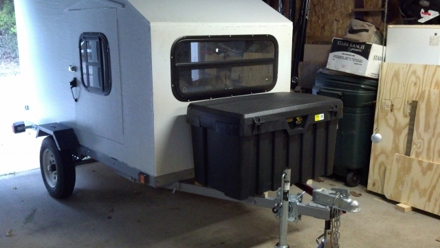

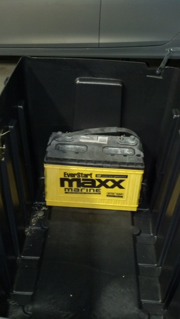

Got my Tongue box mounted.
That big old battery is looking pretty small

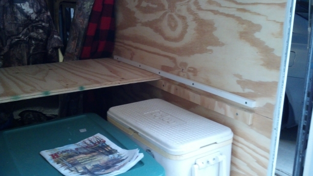

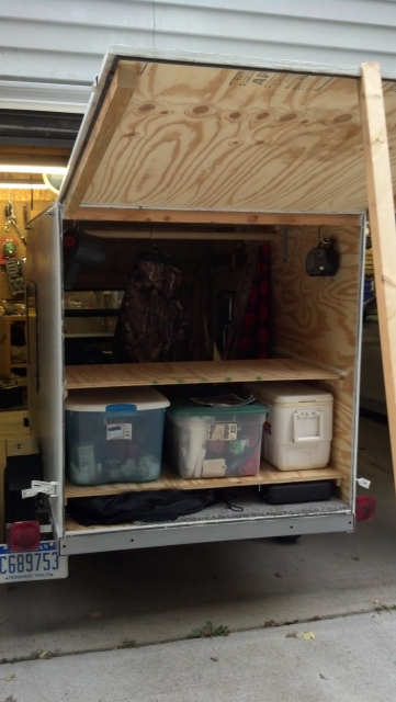

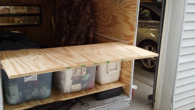

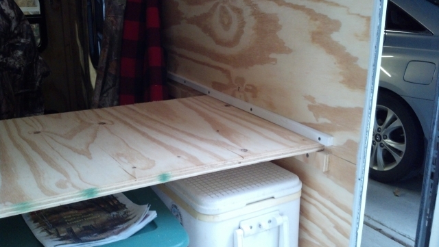

Here is the shelves I added.
The upper shelf is mounted in rails to slide
All the way in and I can sit on my bunk as a table for eating or working at my computer.
Or it can stick out a little
I cut a hand hole in it to get a better grip.

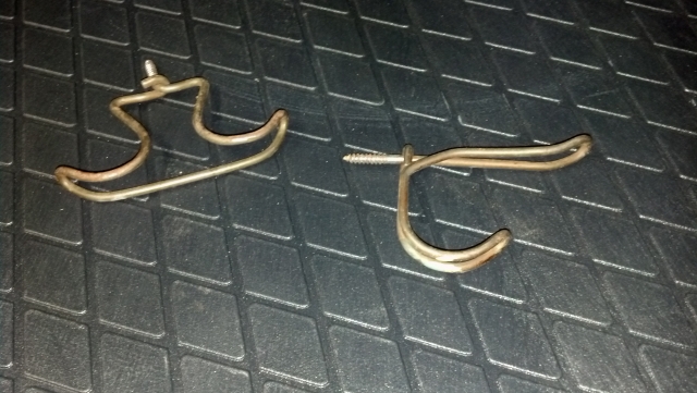

Found these cool twisted wire hangers in my stuff. These will get used somewhere.

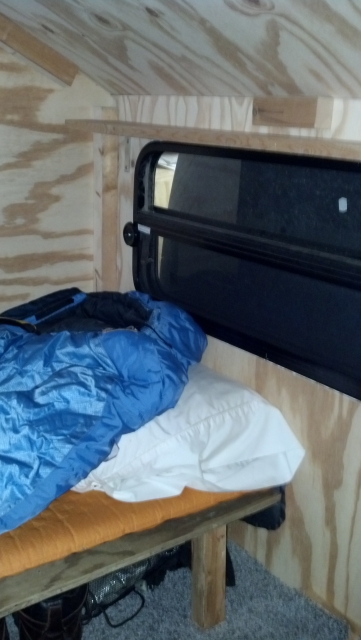

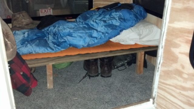

Pedastal for my bed instead of the cot. Hinged on the wall side for access.
Added a shelf above my head for glasses and phone.

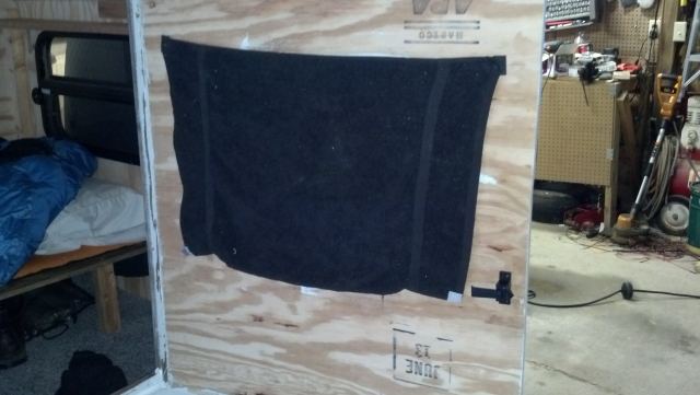

My drapes are just black towels help up with Velcro. 3 hand towels and a bath towel. Dual purpose.

Multi-tasker bath towel/curtains! Very bachelor and yet very practical. I like it. :thumbsup:
Re: Siver Sword - Very Basic Build
Postby Cantputt » Mon Sep 23, 2013 2:59 pm
KCStudly wrote:Multi-tasker bath towel/curtains! Very bachelor and yet very practical. I like it. :thumbsup:
You betcha, this is the man cave. To be truthfull, Unless I spill my beer on my sleeping bag those towels will probably never get used. Thanks for the spelling heads up also. :beer:

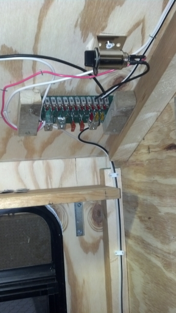

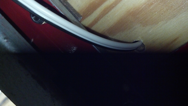

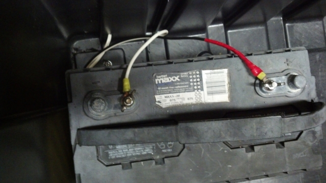

OK, so the electric is mostly done. Ugly but effective, I will clean things up and cover my panel. Battery, 30' of 12-2 wire, distribution panel, 2 lights, outlet(soon to be two). Total $85
Battery in my tongue box(need holddown)
Wires hooked up to battery

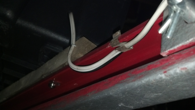

Out the lower side of my box and along the frame
Along the frame and up through the bottom of the cabin

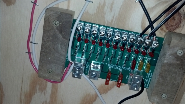

Up the wall to my distribution panel
Hook your wires to positive and negative terminals. My panel - from local RV, stripped out of an RV with bad inverter, 11 circuits, fused with indicator lights

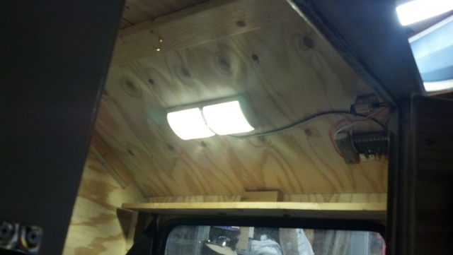

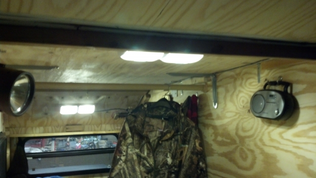

I put a light in the front and the back. Positive from each circuit terminal and common negative block.
