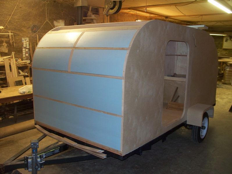

Postby oakinteriors1 » Thu Nov 14, 2013 7:13 am
Galley hatch sides ready for spars...
I didn't cover the entire side wall with the 1/8'' spacer and the 1/2'' ply. like Steve Frederick does...
The door seals came in from a horse trailer supplier.. 32 feet for $26.
I ordered enough to do the hatch also..
The gusset on...

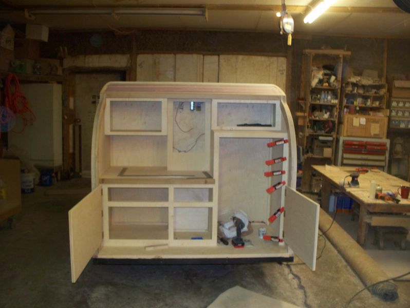

Postby oakinteriors1 » Mon Dec 02, 2013 8:26 am
More progress...

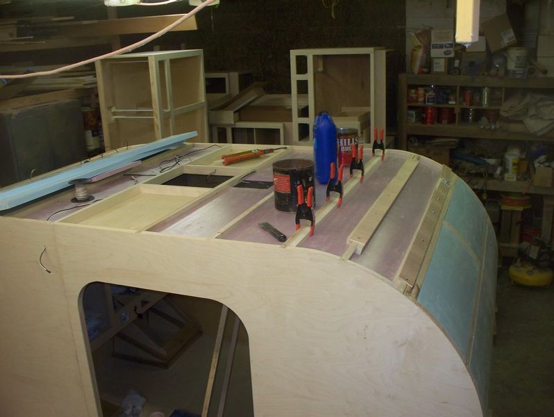

Postby oakinteriors1 » Sat Dec 07, 2013 2:21 pm
Routing the 4 wires needed for the AC control...

Postby oakinteriors1 » Tue Dec 10, 2013 4:42 pm
Finally got the galley figured out...We have one of those big refrig. we have been taking camping with our pop-up for some years now so I'm using it... That is why the tall height on the back before I started the radius.....
The refg. opening height is 34'' and the counter height is 36'' from the ground.....I plan on putting the stove on a flip up swing out table...The other swing out will be a sink....
