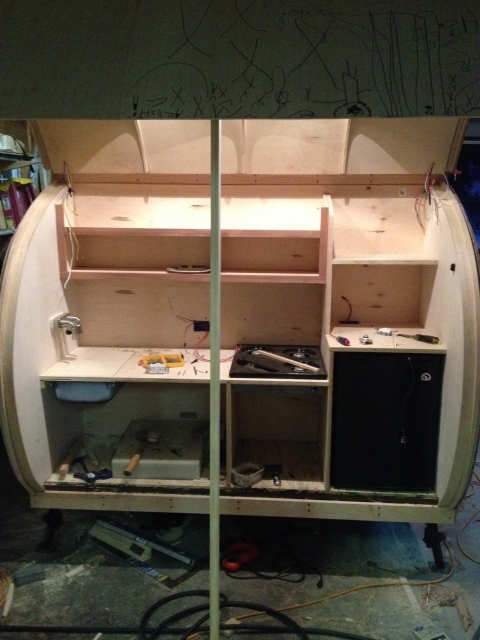

Junkboy....thank you! i am not sure about an AC....kind of designing this thing as i go, and i am not sure where i would put one, though i do like the suggestion (at least i think this is where you were talking about) under cabs behind wheel well bench....and thanks for the heads-up with regards to the battery.....permanent would be preferred. this is a pic of the galley as it is starting to take shape: under-mount sink on left, stove top (and eventual oven underneath depending on $) middle, and fridge right.
originally, i was going to reuse my water tank from pop-up to house grey water, and hook up to campsites fresh water, hence side-mount faucet. thinking now of storing wheeled grey water tank to park under trailer while camping and let sink just drain right in, and have gravity-feed water to faucet cold, with eventual hot-water solution (either solar or propane) to feed faucet hot. also considering 12-volt pump to get to faucet....i really like faucet being out of the way.

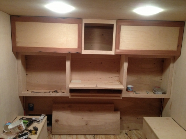

well....not much more done, much to my chagrin....but here is how the interior cabinet doors will look, have the top two outside ones done, have one in the middle still to do, and two more beneath those....galley doors will be similar, I believe...
The black spots on the door styles/rails, as well as several other places on outside of trailer are from nails/staples (this is reclaimed wood), so I am leaving them all in...too wasteful to leave out, and I like the aesthetic it gives....
