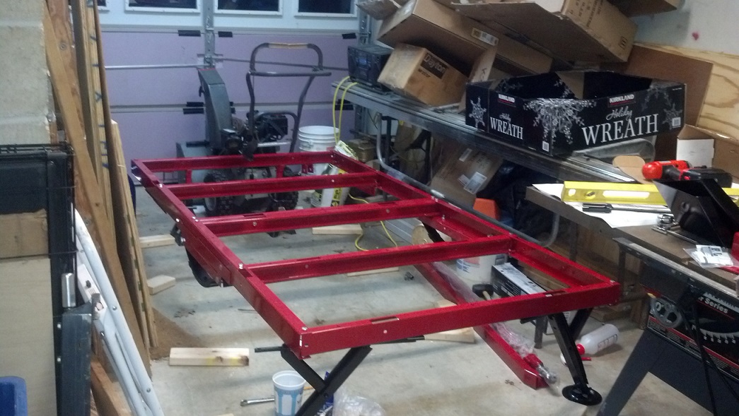

Postby Kharn » Mon Jan 20, 2014 5:19 pm
I really need to get this brake out of my garage and back to my friend, it and the snow blower are cramping my style.
But my wife and I got the frame flipped upright, so now I need to add the axle.

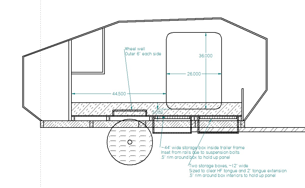

Postby Kharn » Sat Jan 25, 2014 5:38 pm
So I had to scrap a bunch of work I'd previously done, I realized I'd stretched the cabin too far forward in relation to the vehicle. I spent today loading the trailer frame into CAD, along with determining the right size for the wheel wells and sketching out the under-floor storage. Looking at the original profile, I really appreciated how much time Mike had put into saving plywood, when my stretched idea threw that out the window and wasted a significant amount.
I thought about going lower on the under-bed storage boxes, but my driveway has a rather dramatic convex lip to it when I get up to the street, I don't want to take it out for the first time and lose all of our extra blankets or find it high-centered. :oops:
The profile in the pic is the original Weekender, I may raise the rear galley roofline a bit, depending on how the cabinets and space claims work out.
Bed support, wheel wells, under bed storage planning
Trailer planning 20140125.jpg (128.16 KiB) Viewed 4027 times
Technical challenges and design choices ahead:
1) 3-door galley hatch or deal with the complex shape and the head-banging potential? My wife isn't the strongest, nor the tallest, so I have to remember to make it easy for her to use and not just me.
2) Front storage, I want to add extra storage by making the front vertical panel extend all the way down to the trailer tongue, inset maybe 6" from each sidewall, so that we don't have wasted space behind the tongue box. I also need to determine how to handle the air contioner, with the current nose design, the AC unit may stick over the bed about 3" when in the retracted position, if I continue with my plan to have a fully retracting AC.
3) Trolley top? Losing 2" of headroom to the raised floor doesn't seem like much, but my wife's insisting we plan on a traverse bunk for a future addition...
Kharn
Posts: 655
Re: 4-Day Weekender
Postby KennethW » Sat Jan 25, 2014 8:40 pm
I used mixing tubs between the frame members for under floor storage with 1/4 plywood on the floor to enforce the tubs
110011
The bottom angle on the hatch should not be a a problem. It will allow your counter to extend out so you have nice knee room.
110010

Postby Kharn » Sun Jan 26, 2014 7:17 am
The main problem with the bottom recurve is that I would need a lot of support to tie all three panels together, increasing the weight, complexity and intrusion into the galley area (plus I have to work out how high it would need to open for head clearance vs the available range of gas shock options). With a 3-piece hatch, the two lower doors would be just plywood boxes and the hatch would stop at the countertop so space would be saved plus making the hatch lighter.

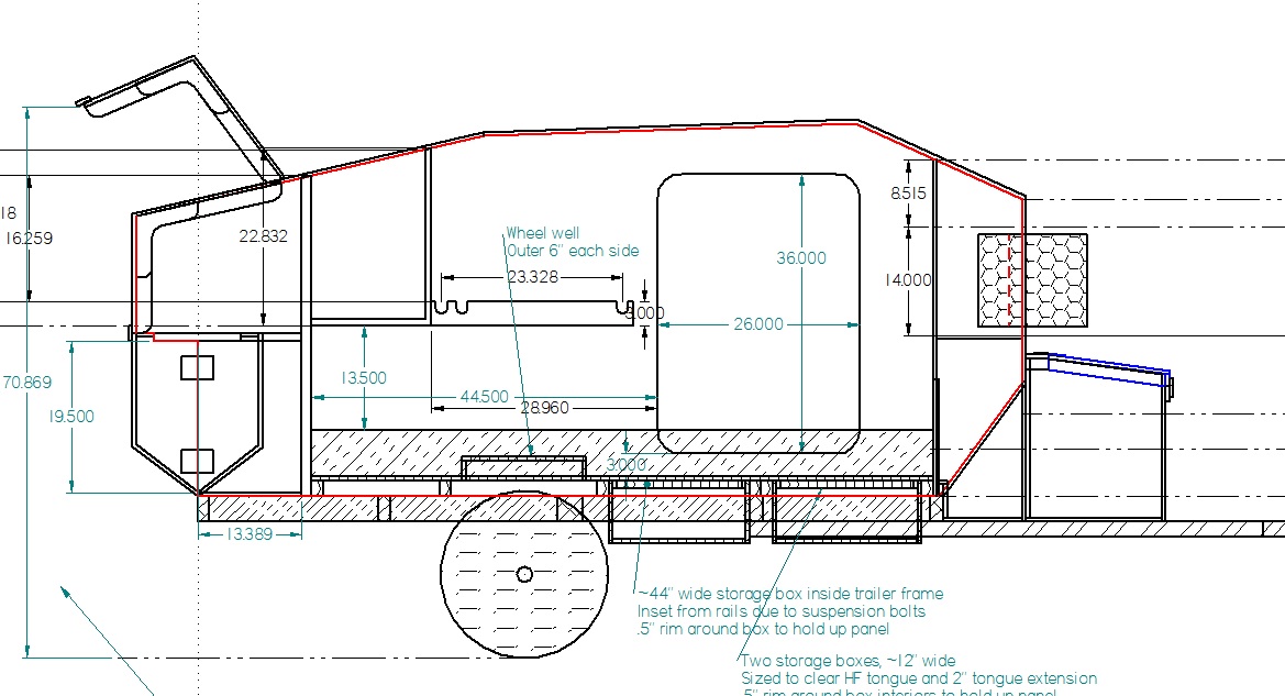

Postby Kharn » Sun Feb 02, 2014 1:31 pm
I wasn't happy with how the rough weight calculations worked out for the hatch, especially after I raised the rear 6" to give more height over the counter top while it is closed. I'm not very happy with how shallow the lower shelf of the galley is (~13 3/8"), but the main countertop is 19" deep so our larger items will have to be stored up there and the lower doors can be left hollow so bigger items can protrude into them. The biggest disappointment is that our current cooler won't fit in the galley, but I haven't been happy with it, and I'm open to replacing it with a different one (or two) that will fit.
The red line is the shape of the 4x10x3/4" plywood side, the galley hatch will be one upper hatch and two lower doors that swing 180 degrees. There is additional space ahead of the trailer frame and behind the tongue box that will be open to the front cabinets. The tongue box will be 4' wide where it meets the main tear body, tapering to a width TBD (I have to get the tongue extension on and see what I'm comfortable with vs my truck's bumper for tight turns, I suspect it will be about 12" wider than the HF A-frame tongue at that point).
I'd originally planned for the PD4045 converter to be located below the air conditioner (honeycomb rectangle, shown in the deployed position, the red dashed line is the interior/exterior boundary on the unit) in the middle of the front cabinets, but I've realized that is a horrible use for the space so I'm debating moving it in to the tongue box with the battery.
