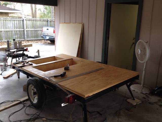

Postby Tommy2tone_1999 » Sun Feb 16, 2014 6:13 pm
Holes cut in the floor for the storage compartments.

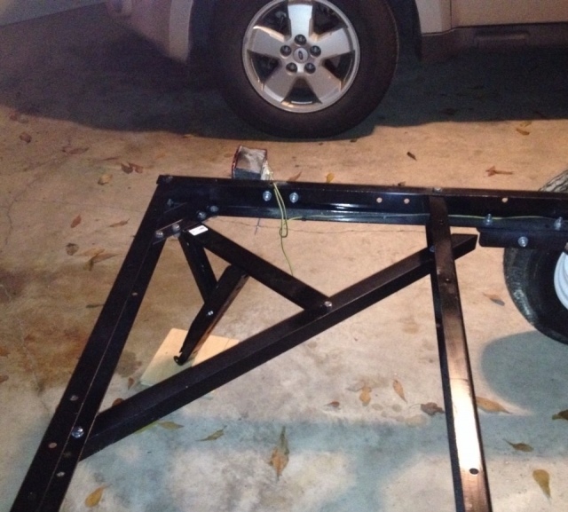

Postby Tommy2tone_1999 » Mon Feb 24, 2014 11:40 pm
Just installed the staibilzer jacks. Had to make cross braces from some angles to mount them.

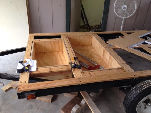

Postby Tommy2tone_1999 » Sun Mar 16, 2014 2:45 pm
Fitting the floor storage compartments.

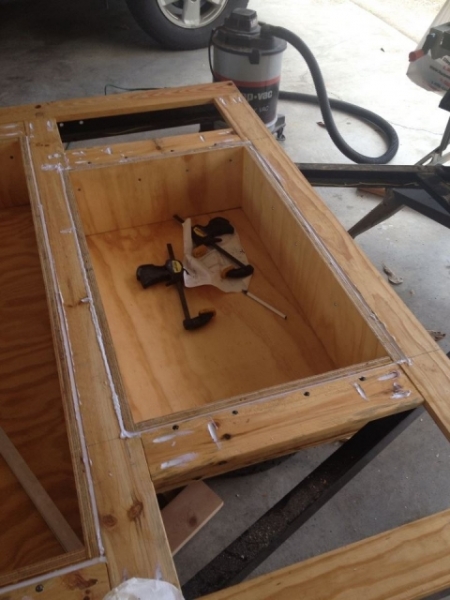

Postby Tommy2tone_1999 » Sun Mar 16, 2014 2:47 pm
The edges of the floor storage compartments and the pocket screw holes sealed with calking

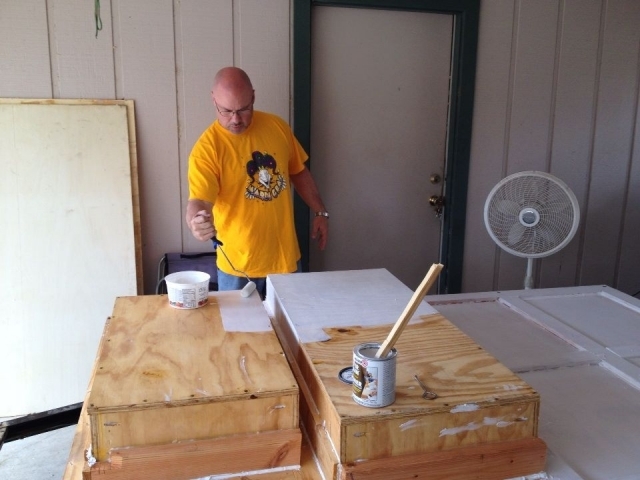

Postby Tommy2tone_1999 » Sun Mar 16, 2014 2:50 pm
Applying Zinsser oil-based primer to seal the plywood before painting on the roofing asphalt. This will prevent any possible delamination from the asphalt compound.

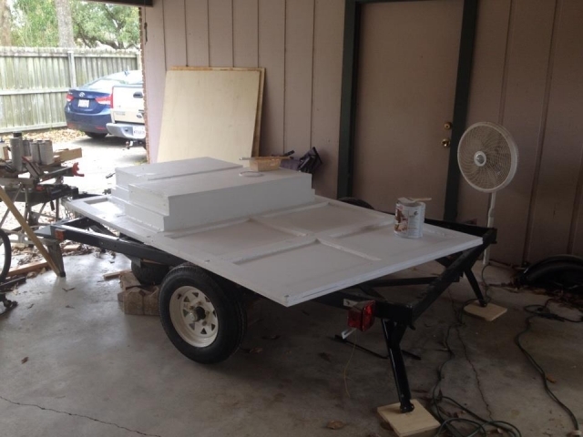

Postby Tommy2tone_1999 » Sun Mar 16, 2014 2:51 pm
The floor turned upside-down, and 3 coats of Zinsser oil-based primer to seal the plywood

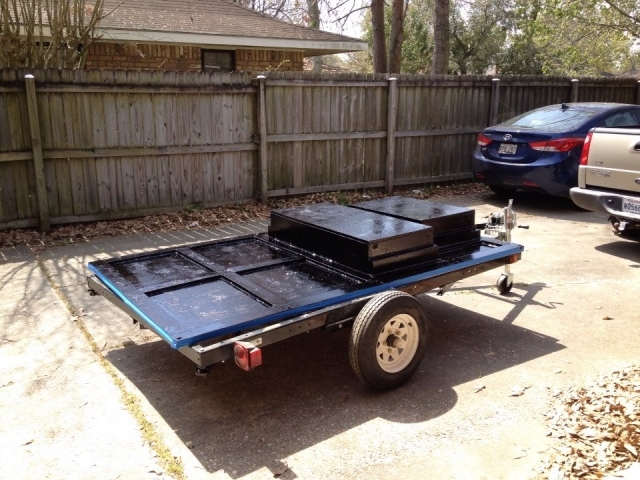

Re: Mobile Fit Club Build - Tommy2tone_1999
Postby Tommy2tone_1999 » Sun Mar 30, 2014 4:42 pm
Roofing Asphalt Compound applied to bottom side of floor for waterproofing.
Using these fanged washers to allow me to tighten the carriage bolts that secure the floor to the trailer frame.
