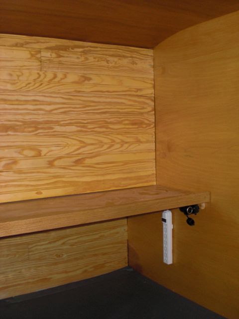

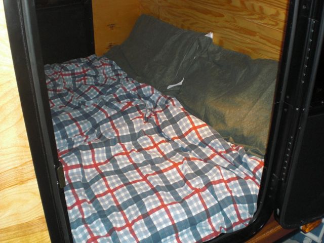

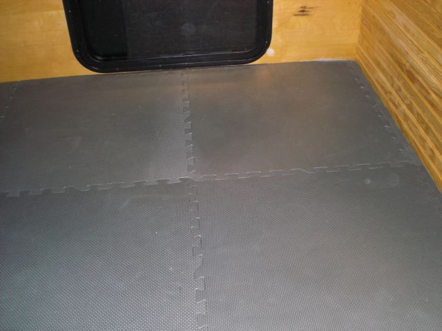

Finishing up the interior. I used the Harbor Freight anti fatigue mats to cover the plywood floor. I am using on old futon mattress with a 2 inch foam mattress toper to sleep on. My wife and I tested yesterday and it feels super comfy!

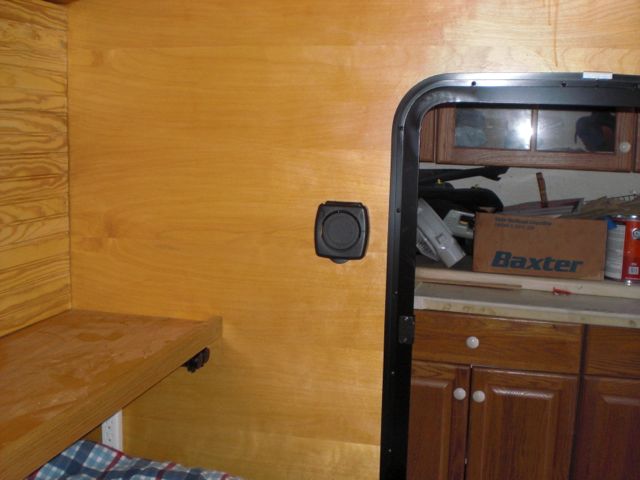

110v electric and 12v plug when off grid

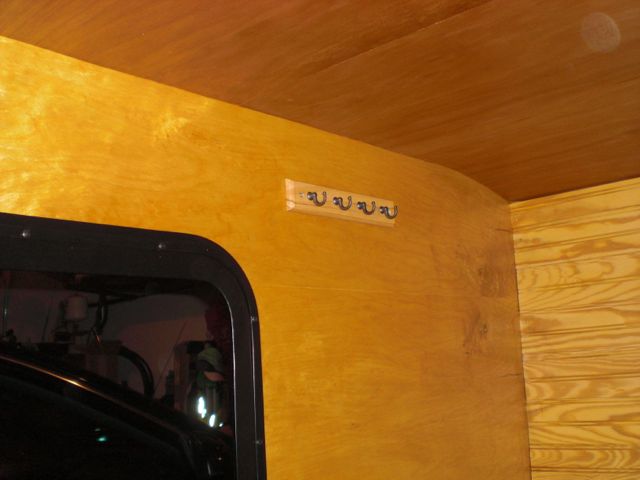

Jacket hooks

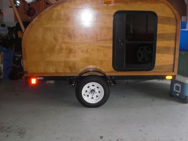

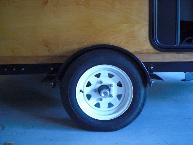

Weekend first camping trip got rained out. :x So doing so more fine tuning of the Benroy. When I built the trailer, I followed everyone's advice to place the axel above the springs to lower the height. When I mounted the fenders in their stock location, I only had about 1 inch between the bottom of the fender and the top of the tire.
I'm not comfortable with the tire that close so my alternatives are to mount the fender higher or flipping the axel back beneath the springs. I did not want to drill holes in the side of the wood so I opted for the second.
Fortunately the galley height is still fine.

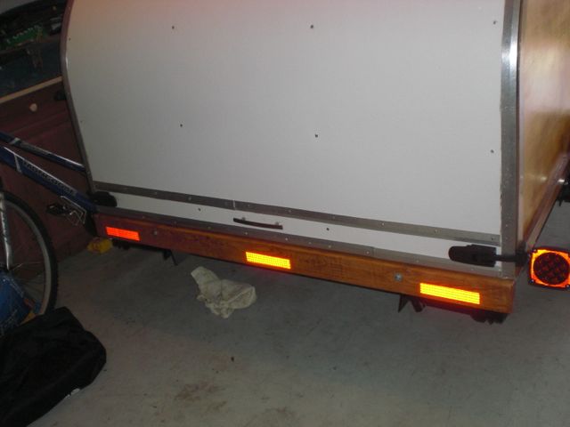

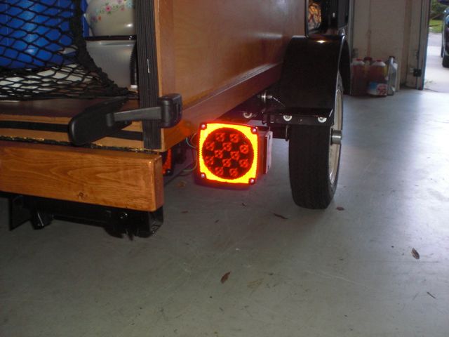

Next was new LED tail lights from HF. Used my 20% off coupon. Much brighter! :) For added safety, I added reflecting tape to the bumper.

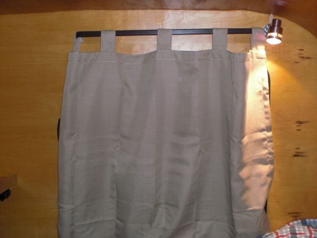

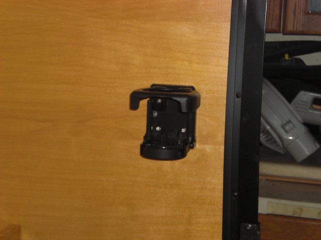

Finally, some added conveniences for the inside. Cupholder and curtains. Found the curtains at Target. They are "Cafe" style and are the perfect length for the door. One package has 2 curtains. :thumbsup:

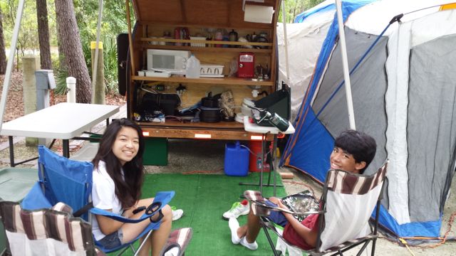

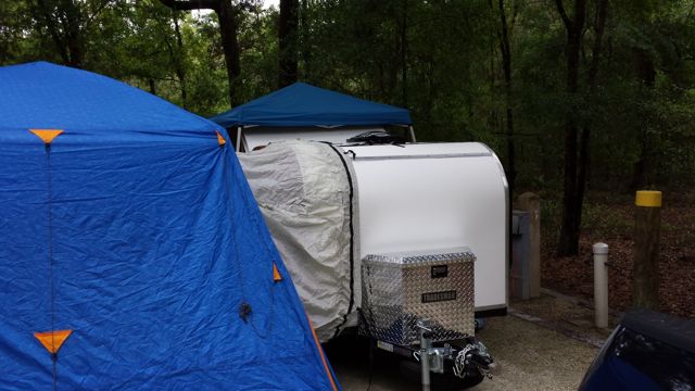

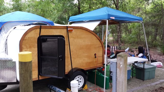

Thanks I really had a lot of fun building the teardrop. Weather finally cooling down enough for some Florida camping. Here are some photos of our first trip earlier this year.

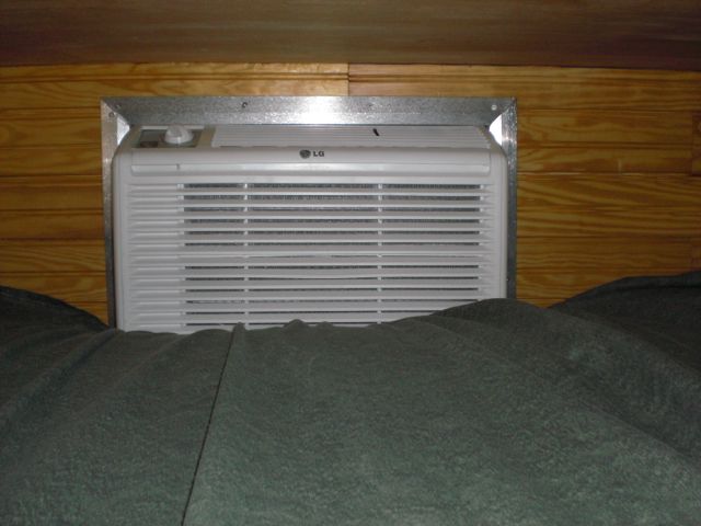

Postby flbikejunkie » Sat Jan 24, 2015 8:43 pm
After using the tear drop a few times have decided to finish up the galley.

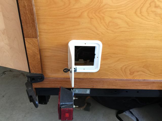

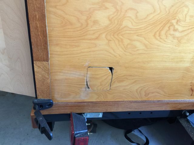

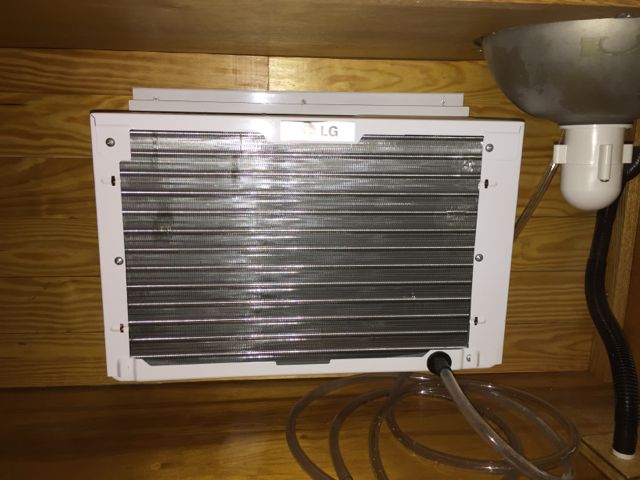

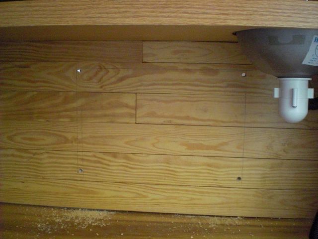

Added AC, cutting out the hole
AC mounted
Cold feet
AC vent door for side of camper. I hated cutting a hole in a perfectly water tight wall.

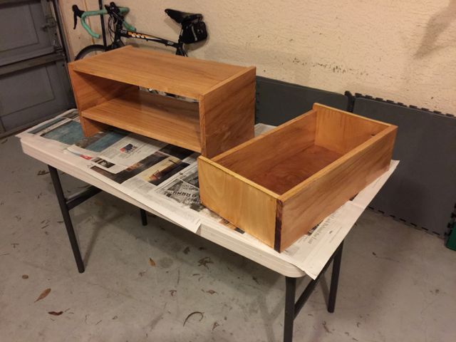

Door test fit

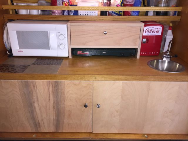

Built Doors for the storage area, a drawer for the silver ware and storage for the stove.
Used kitchen cabinet hardware to mount
First coat of spar urethane. Got some drips to clean up.

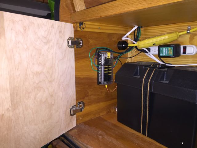

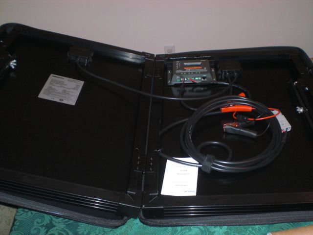

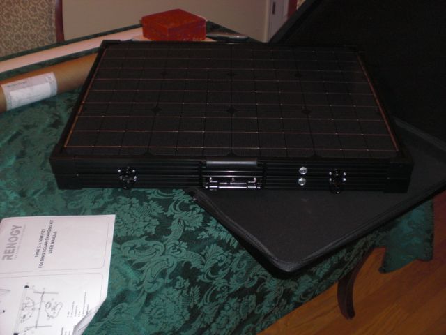

Finally, I got a 100 W portable solar panel to charge the battery. Comes in a nice carry case.
Unfold open and all the wires and charge control unit were mounted and ready to go. Can't wait to try it.
