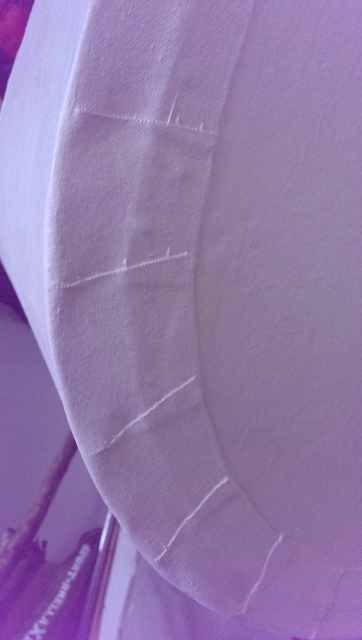

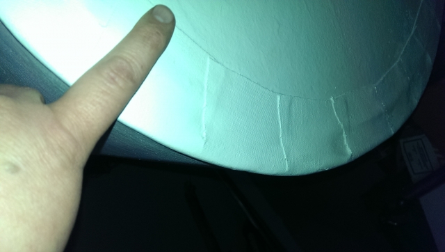

How did you figure out canvassing over curves?

Postby lthomas987 » Tue May 06, 2014 4:13 pm
I did it more or less like you would on a big teardrop. I canvased the inside and outside of the walls, then I canvassed over the top. I think the tiny tight curves I had on the bike trailer 9" radius made getting smooth curves harder. I just cut slits in the canvas from the edge to the vertical part of the wall on the top, then folded them and made little lapping triangles every couple of inches. You can still see them under the paint since I wasn't super committed to good finish work for a dog box. I'll see if I can get a picture or two tonight. I overlapped the roof pieces about 2" onto the sides. Which on the tiny curves was kind of a lot, but I was afraid scaling down the laps more than that might go poorly.
If I had been thinking and in possession of a razor blade instead of scissors the night I was working on it I probably could have cut out the little overlapping triangles and had it finish flatter.

Postby lthomas987 » Thu May 08, 2014 9:29 pm
scuba1978 wrote:What a fun project! Now I'm looking at my bike and dreaming. I guess I did it backwords, practice on a full camper, perfect a bike trailer?!
Here are my little overlapping triangles and one with a finger for scale.
