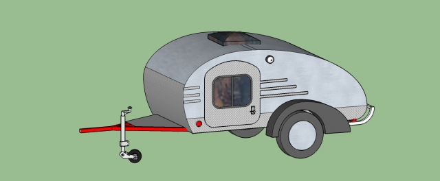

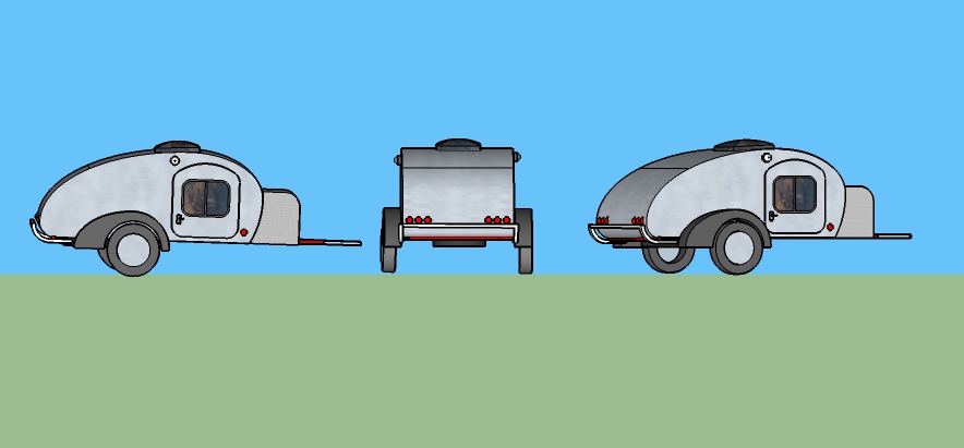

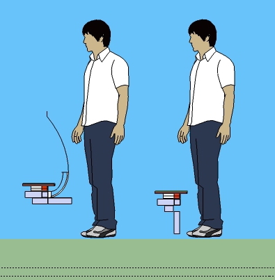

I'm thinking (at this late stage) that I would like to build some kind of bumper that would protect the TD the dings and dents that will come from your's truly as I attempt to park and reverse at low speeds. So I'm just looking for something which will protect the lights and corners from me :NC
There used to be a car over here in the 1970,s called the Triumph Spitfire. It had a lovely rear bumper set up. Here it is:
So .... using that as my inspiration I'm going to attempt something like this: Obviously the thing will hinge and drop down out of the way so I can open the galley lid.
I'm thinking I will make it out of light box iron that I can bend and paint. The bumper will also be a useful handle for jockeying in and out of tight spaces when the Tigin is off the towbar.
Anyway that's the plan. :)
Larry

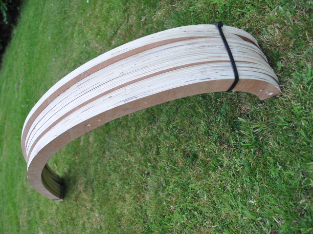

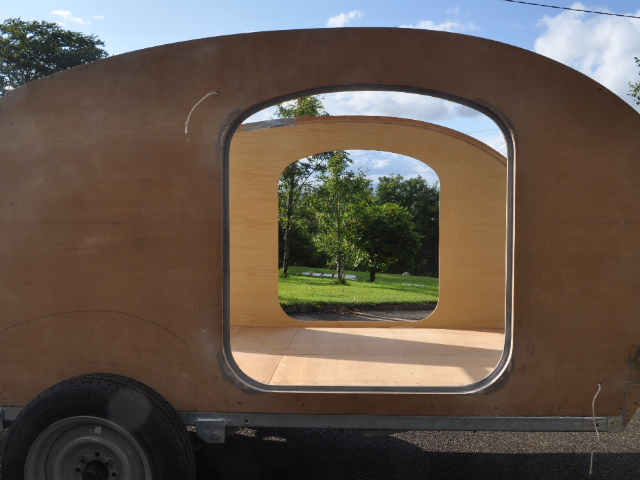

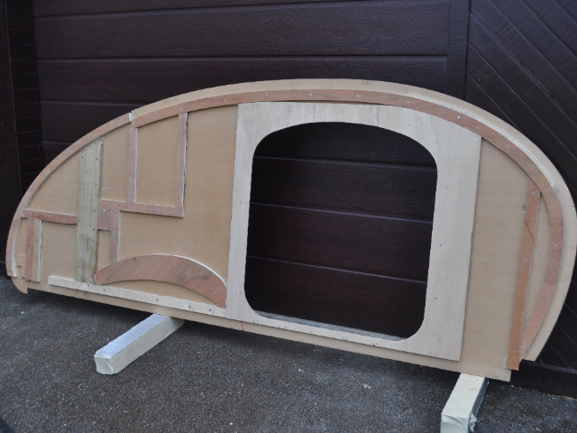

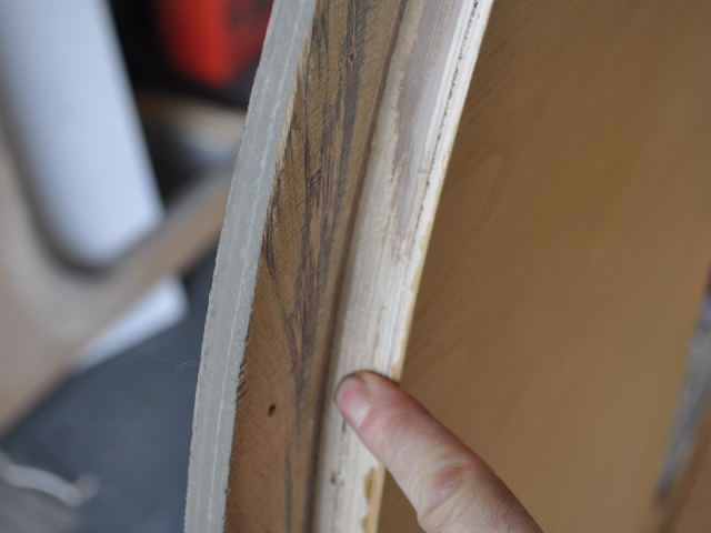

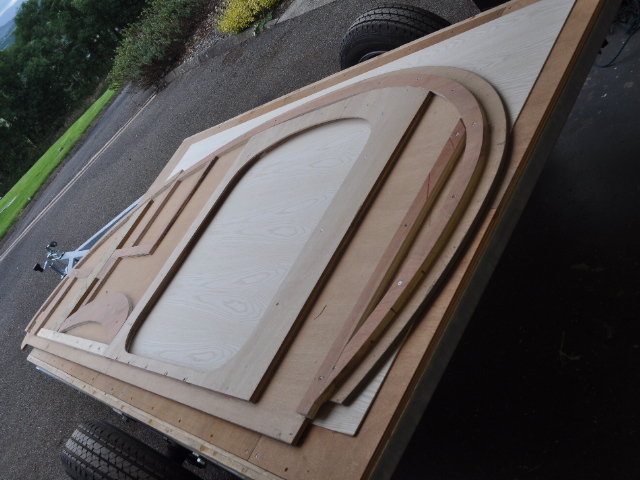

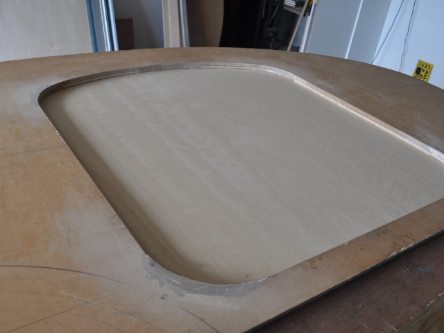

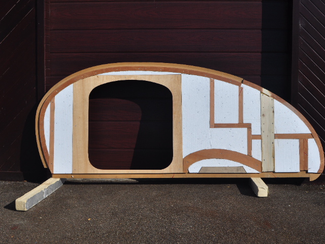

Got the door frames (re) sorted. I originally made the corners with a 4" radius (too tight for "T" molding bending) so I softened them to 6" corners. Basically I added another leaf around the door frame of 1/2" ply, got the new one right to 6" then used auto body filler and plastic wood to make new corners on the original sheet. After that I had to cut and shape a closer in 1/4" ply . It took a long time to do but the results are getting kinda OK:
Then, got the filleting pieces installed on both sides. This is one completed side with the door closer installed (1/4" marine ply) cut and shaped so as to make it 3/4" of an inch smaller the whole way 'round. The additional fillet pieces attached to the side are held with gorilla glue and s/s screws and will be used to give the cabinets and mudguards etc something to bite in to.
Here I am marking out one of the ash sheets which will form the inner skin of the Tigin -
I gave up at this point having marked it out there will be a lot of jigging and sanding to get this sheet right. I wanted to put coat of varnish on this sheet before I begin cutting so as to protect it from hardship. Also - Made the spars for the hatch. Thought it best to do this before the the sides are up permanently.

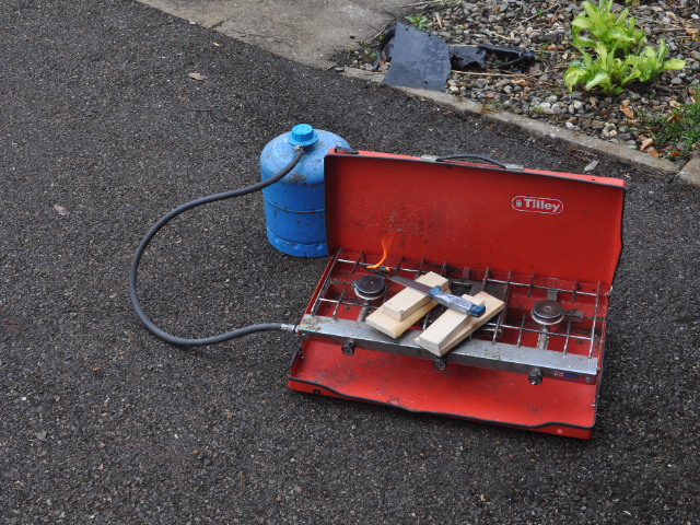

Here is the first side with the polystyrene istalled.
I used a "hot knife" technique:I got the information on how to do that here:
https://www.youtube.com/watch?v=Yjfwor-BUd4
which gives surprisingly accurate results once you get the hang of it :D. Here is my setup

Nice method, but I wouldn't want to do this with a good knife. Temper will be lost in the steel, so a yard sale blade would be in order. Does leave a nice finished edge and none of those white crumbles to deal with.

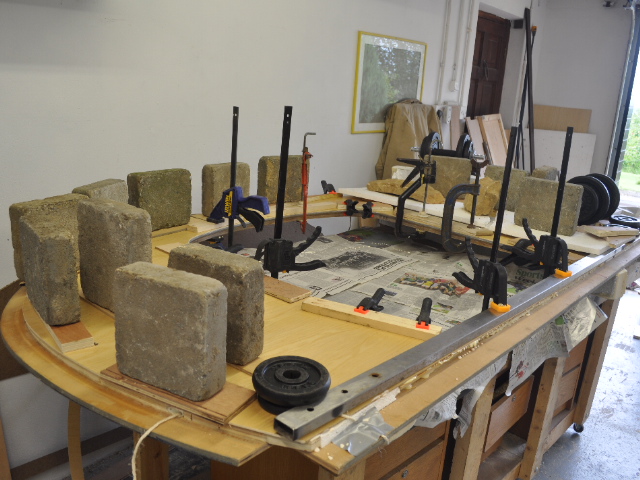

Hi All,

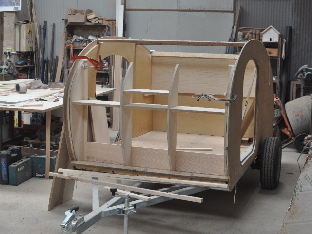

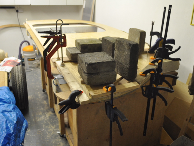

Gluing and clamping up the sides - ran out of clamps and had to revert to more primitive methods...
The ash veneered sides got a bit of scraping with all the tooing and froing but nothing a light sanding and a coat of varnish won't fix. Can't wait to get the sides up I<m really tired of tripping over everything in the garage it's time now it was all being screwed together...hopefully Monday :)
Larry

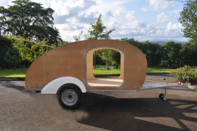

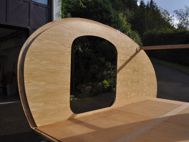

Just as I was getting things finished up and the sides glued on at long last, the rain stopped and sun came out, so... I wheeled her outside for some snaps.

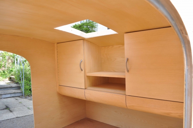

Here's a shot of the ash veneered sides after four (yes four coats of matt varnish). The chunk of wood going across from one side to the other is of solid ash and will eventually hold the H/ Hinge to the hatch.

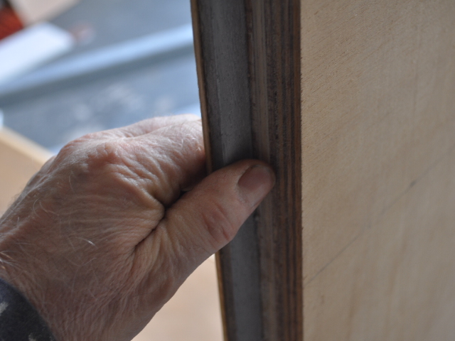

This is what took a lot of the time. Getting the inside curve right with the ash veneer so it leaves a lip the whole way 'round the inner walls. I got this shape with a Stanley knife and a belt sander. Taking away a couple of mil at a time:
This was another difficult one. I had to layer up the doors so they would be smooth on the inside and still have a 3/4" lip for a door stop. This is 1/4" ply which I sprayed with galv paint.
Here is a shot of the door stop from a few feet back. On the skin nearest you can see the silver stopper. On the farthest away skin you can see that the ash veneer is flush.

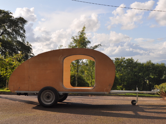

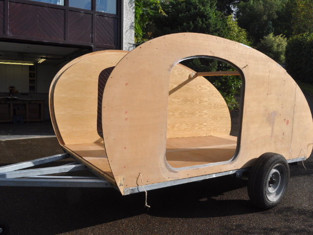

Here's the overall shape now, the bits of string are for pulling through electrical cables later which were channeled in walls. the plywood sides now come down to the bottom the chassis box. I used gorilla glue and a row of stainless steel screws to secure each panel onto the sides of the trailer they bite into the two lathes of solid ash which run from front to back.

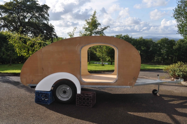

Finally, here's a mock-up of the Morris Traveler fenders where they are likely to end up. I would've liked the bottoms of the mud guards to be flush with the underside of the chassis but because of where the centre of the hub ended up this was not possible.
Hmmm..... :thinking: :thinking: .maybe I'll trim the bottoms of the fenders so that they are only a couple of inches below the chassis. Something like this perhaps.
This looks a bit better - If only I could do all the building in Photoshop :)

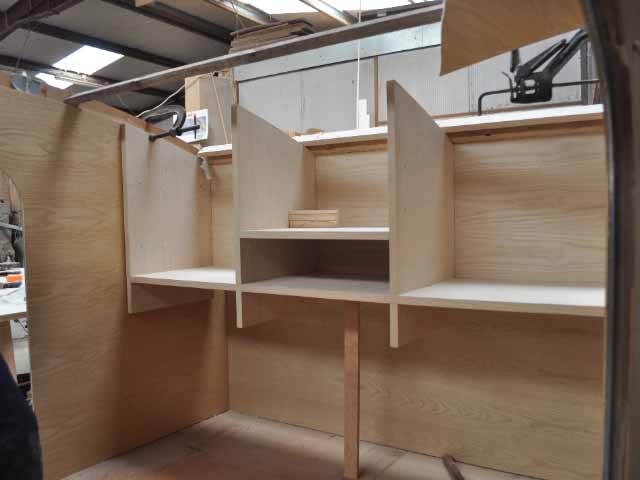

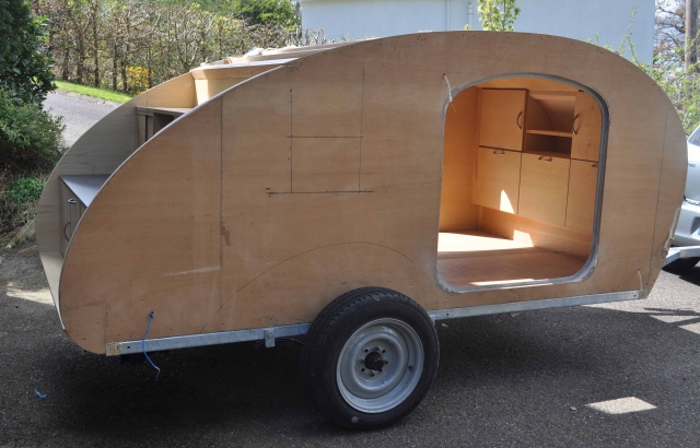

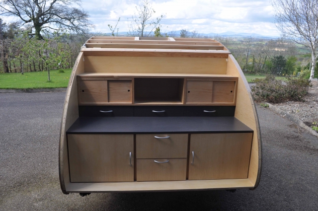

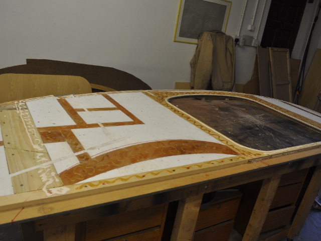

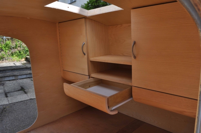

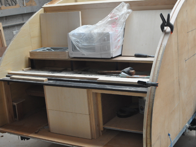

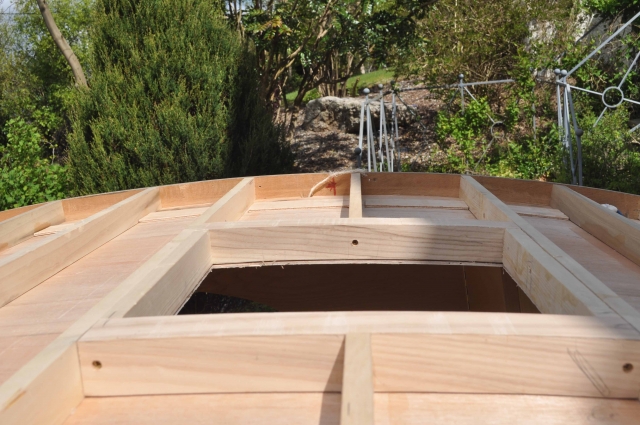

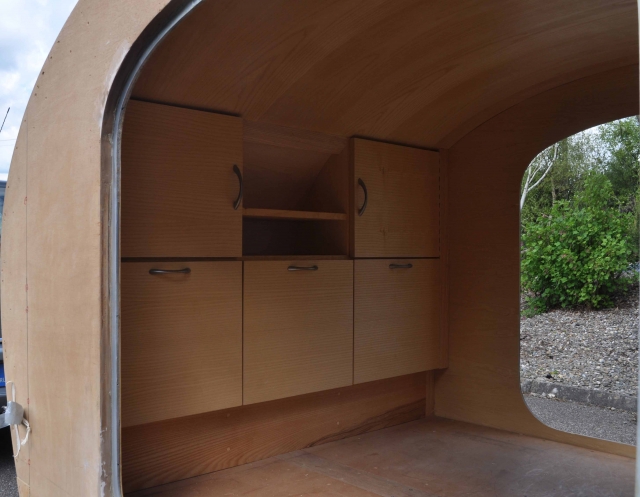

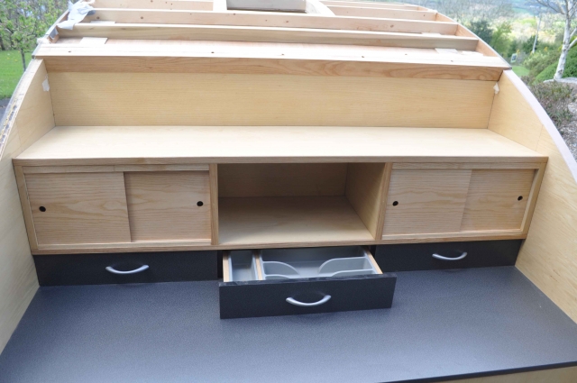

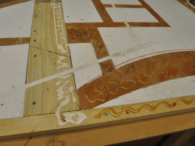

It has been over a year since I started building our teardrop. Slow going. I've been chipping away at it for months ... then yesterday things took a giant leap forward! A couple of months ago after I fixed in the worktop in the galley, installed a couple of IKEA drawer units and worked out what way I wanted the galley layout then I took the Tigin to a local cabinet maker so he could complete the cabinets - I was afraid that I would make a bags of them :NC I also asked him to skin the inside ceiling too. I hoped that this could be done in a continuous curve of ash and this would require jointing some 8x4 sheets - skills WAY above my capabilities. Anyway, I got it back yesterday. Here the cabinets are fleshed out (this was about a month ago):
When all the bits were made I took 'em home and after days and days of varnishing and sanding a I brought back all the bits for assembly. Then I got the Tig back yesterday here she is at last beginning to look like something!
gallery/image.php?album_id=3472&image_id=131220
He also did a nice job carving out the fan frame:
Here is a detail of how he spliced the roof so there would be a continuous arc of ash veneer inside (the biggest sheet width we could get was 4 feet). It looks so nice I'm not going to clutter it up with down lighters.
Moving on to the wiring next - then insulating the roof.
