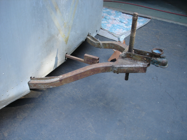

After a couple of e-mails with Andrew, this is what we came up with for the new design on the frame. The original had 2x2 square tube with a lifted front end. The problem here is that the 2x2 tubing was fairly new back in '47 and they decided that a rib welded on the top web was a good idea. On this trailer, it failed on 1 side and had been repaired, and was cracked on the other side. Also...dig the funky jack...not useable at all, rusted up solid. I plan on a much more sanitary front end. The rest of the frame only had the 2x2 running full length and used 3/4 square tube for the cross members. While that may have been great given the travel conditions back in '47, I don't feel it's worth repairing the existing frame, which has several repairs on it and besides, the stub torsion axles are beat, and it's got a super short tongue on it now.

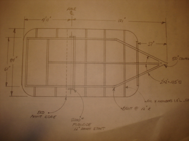

My plan is to go ahead and scratch build a new frame with a Flexiride axle in it, which is already here. Nowadays, we travel at speeds much higher than the typical speed back in the day and besides, it's 67 years old. I will feel a lot more confident dragging around a trailer with a new frame rather than a patched up/ pieced one. Just me. Thank you Andrew for your "educated" eye in checking out my frame design. Hopefully I'll have some new iron to weld up this next week.

existing front end, note repair plate on top side.
new frame design. Yes..I'm old school, much quicker with a pencil and a T square/triangle combo than I'll ever be with a computer. thank you Mr. Rios, my high school drafting teacher. 43 years ago and it still works for me.

Looks like a great plan. I am with you...a good frame is such a peace of mind. What is the larger opening in the frame drawing behind the axle for...a dropped floor? Or is it just a illusion that it is bigger?

In an earlier post and on you drawing you show the rail being bent. Maybe you could elaborate a little more on this please. I assume the bend is in the same plane similar to the main rails for a boat trailer.

Yup Tom...just putting the 1 bend in each side to meet at the 50 degree coupler. I'm not doing the lift that they originally had on the tongue. I don't see much purpose in it other than to keep it original in appearance, and it would drive up costs and time.
Dan, I left that part open as it's just going to be under the bed. I tried to run iron down the middle as that's where most of the stress from people standing is going to be. I figured I wouldn't need any iron under that portion.

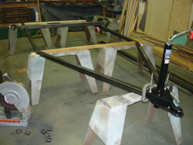

My idea was great, in theory, to get the iron bent for the frame. Unfortunately, the machine shop that assured me that they could do the bends and make them accurate was incorrect. In addition to being off by 3 degrees on one side and 2 on the other, 1 side wasn't in a straight plane. I ran them through the chop saw and removed the bends. I'll weld up the frame in pieces. Today I got a jig made up, cut some of the main pieces, checked to make sure the flanges on the axle would fit and got the trial fit up all done. Hopefully I can burn some wire tomorrow. Doug

Ran into similar probs with local shops here. Amazing that these shops make engines, airplane parts and other super technical items but cannot weld up a frame straight! The old saying ...if you want it done right...

Hey, before everyone says what a trailer wizard Doug is, who has noticed that he's got either the coupler or the axle on the frame upside down?
Yeah, yeah, so he was using the axle to jig the frame and will fix it on the underside when the time comes..... That's what I would say if I was Doug, too!

Andrew....the axle that was sent was for the Southern Hemisphere. I'm waiting for a Northern one to be shipped out, then I'll do the install. Doug
