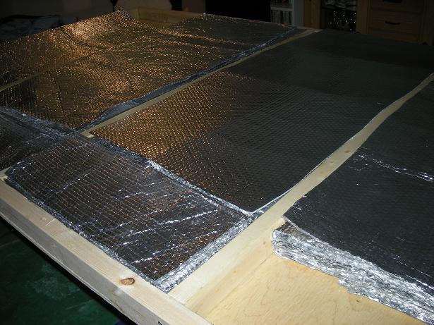

Thanks Laura, I will go with putting it in the floor! It will keep something from the landfill, save me $100, and make my guy and his buddy from work very happy (since they have been collecting it for me all winter). If it ends up not working very well...then Mark and I will freeze our butts some cold summer night in Alberta, and I will say, "I told you we should have used foam." :)
KC, yes, I know that 2x3s and 1/2" ply are heavy and mark me as a rank amateur. I just lacked the courage to go smaller than that. :cry: All my previous experience has been with sheds, and I am still addicted to the security of "having something solid to put screws into". I will learn. My original plan for a wood build would have weighed (I calculated) just under 1,000 lb. I am confident that this foamie build will do much better than that, despite my over-heavy floor. I am comforted by the thought that I will have no galley in this thing.
Here is the silver insulation being layered in the floor spaces.

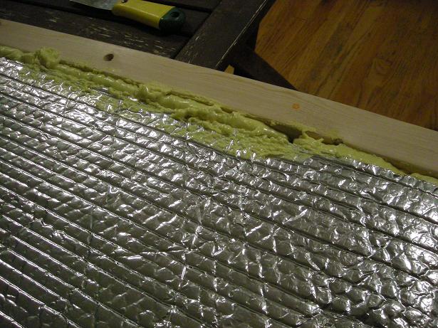

Tonight's work consisted of using GS to glue the sheets of insulation in place, on the underside of the floor frame. I had the insulation layered 10 deep, meaning that there were about 80 pieces (various sizes) of the stuff altogether, and I just wanted to prevent them from shifting around later. Mark said it wasn't necessary, and probably he was right, but it only took an hour and made me feel better. Some folks on the foamie thread advised me to test the flammability of the stuff, so I took a couple of little pieces outside and tried to set them on fire. They didn't burn. One of the flimsier pieces melted a little, that was all. The can says the GS will be cured in 8 hours, so I will wait till tomorrow to skin the bottom of the floor.
