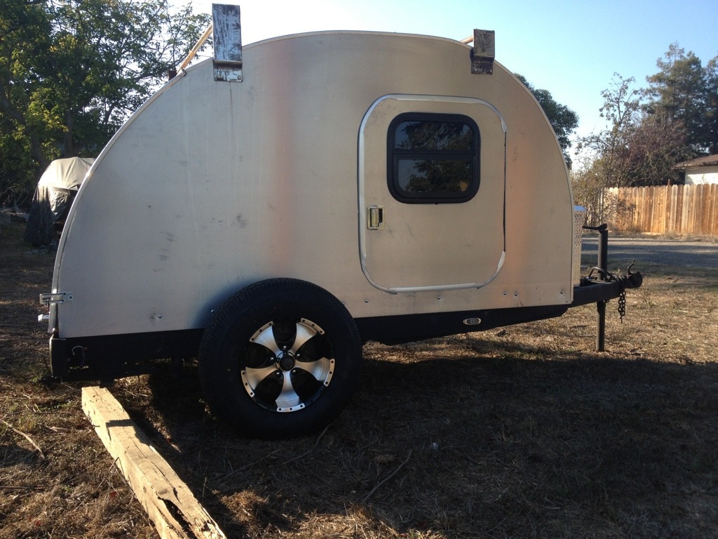

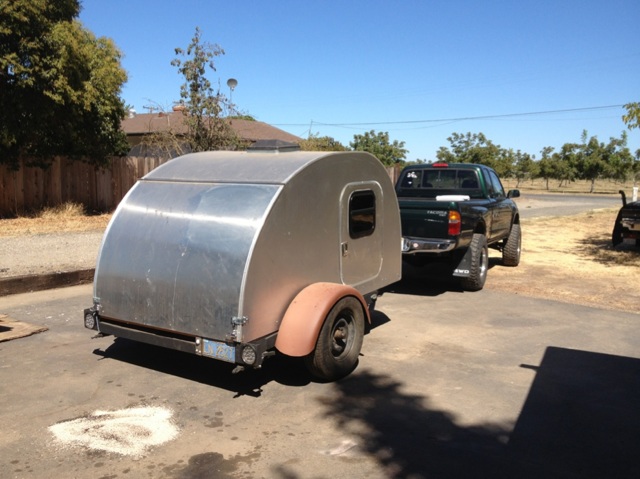

Little update... Got the windows both installed and sealed up. I had to build a trim ring for the pass side door since it didnt come with one. Also re-secured my walls... I found out through my first trip with it my mounting idea didnt work. I had my own idea of securing the walls setting them on top of the floor and securing with 16 3" L brackets and four 3/4" screws in each one. Well after the bumpy road conditions I lost most of the screws and made the ride home a little unnerving. So I fixed that by adding a 2x2 with cartridge bolts through the walls and roofing screws into the floor.
Took the tear out for the weekend on a little 2 hour drive. And found out my fenders rub... O well good to find out now before I painted them... Also at some point it looks like I bent a rim as it wobbled like crazy! I also installed a fan in the vent at the last minute but turns out I installed it the wrong way so it was pushing air out, easy fix.

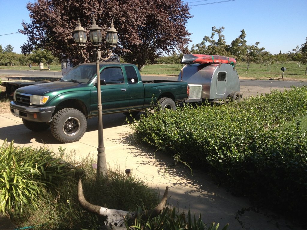

Built a rack for the kayak Friday and took it to the ocean for a night. Worked out nice, but I had to remove my fenders cause they rub. Saving up for some nice rims....

Finally got some new rims and tires and fenders re-primered (not installed in pic) took a buddy to anchor bay this weekend in it roomy for two guys and towed great on the twists and turns of hwy 1!
