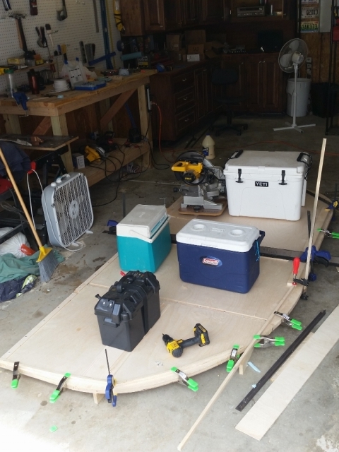

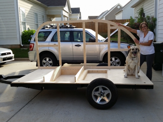

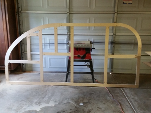

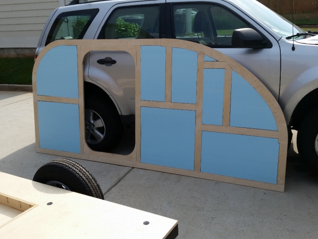

Basic frame taking shape! I decided to rip the 3/4" baltic birch into 2 1/2" wide strips to avoid buying pricey poplar boards. I was surprised how well it substituted! I used kreg jig pocket screws and barely had any splitting.
Fiancee Mary Beth and camping companion Layla help to model my progress so far!

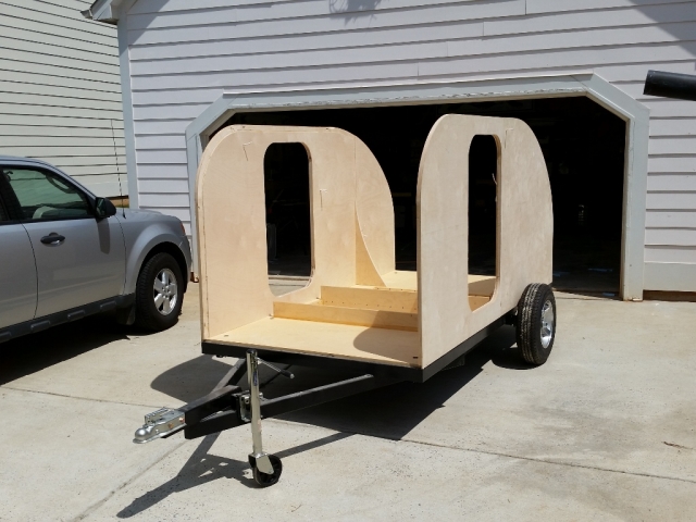

Got the rigid insulation cut out! I also got the door jams cut out and installed. I decided to go with the 6" radius for the door after all. I think that it will be work the extra effort. I willy probably change my mid later though haha.
Preparing to attach the outer skin to the frame. This was definitely a stressful procedure and Im glad that its over!

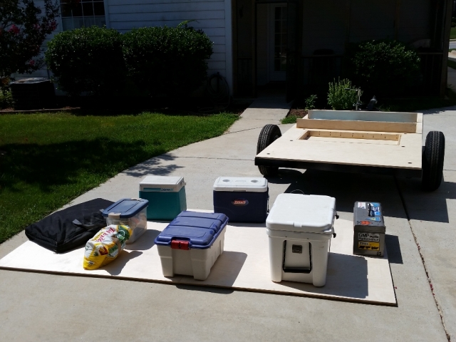

Looks like the current camping equipment isn't obsolete yet!
Traditional clamps, very handy to have around. Around here they often are shaped to look like bricks and bags of sand!

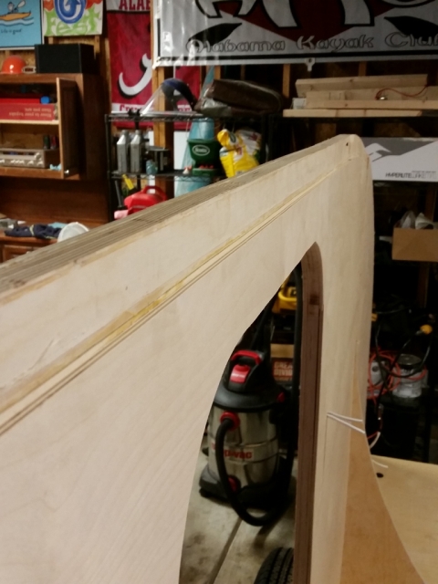

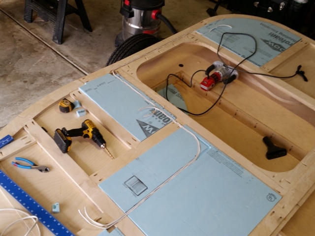

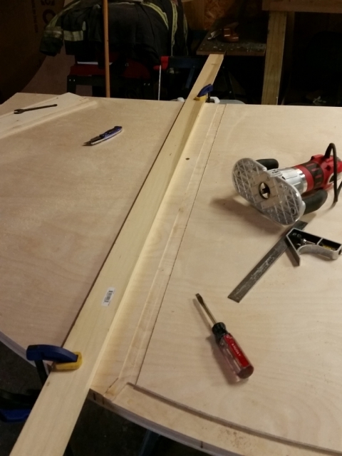

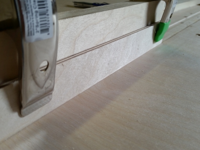

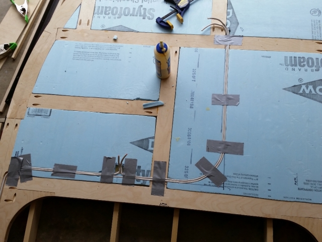

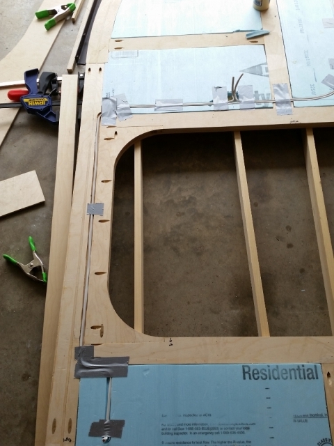

Starting to lay out the wires inside the composite wall. I used a 1/2" router bit to make a grove for the 14 gauge speaker wire that I am using for all of my DC.

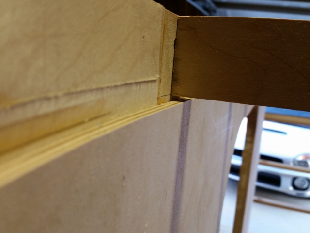

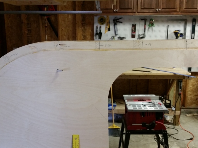

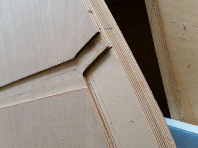

I routed my interior 1/4" birch skin to be offset the thickness of the ceiling from the top edge. This allows the roof spars to sandwich the interior 1/8" birch headliner to the interior skin and hopefully create a more seamless joint. For a more attractive finish, I decided to use a dado joint for the wall dividing the cabin and galley.
It gets tricky where these two routing procedures meet on top of where the galley hinge spar will be located.

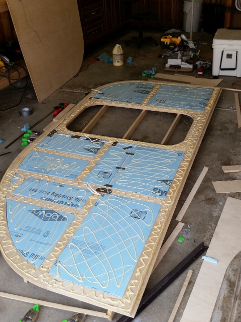

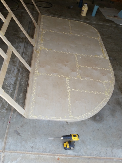

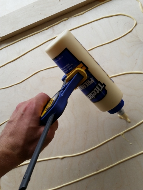

With the electrical installed in the walls, its time for some glue!
After my hands got tired of squeezing out all of that glue, I invented the redneck caulk gun! It actually worked pretty well!
This took a lot of planning and every clamped I owned. I quickly went out and bought more clamps..

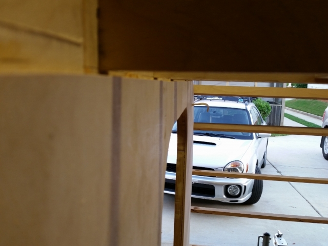

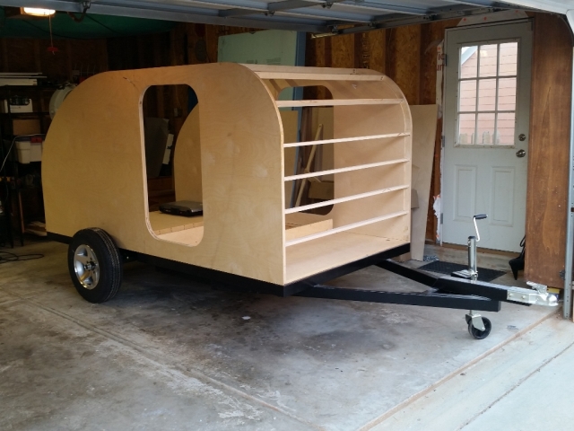

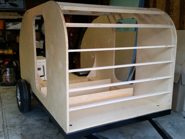

After the glue dried I mounted the walls to start dry fitting everything else on the trailer. It felt good to finally get into the third dimension!
Here is another view of my offset interior wall skin.

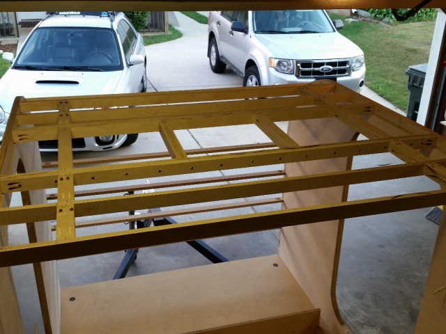

Planning where my roof spars will be.
All of the spars installed!
Close up of how the 1/8" birch headliner will be sandwiched in between the roof spars and the interior wall.
The spars for the top of the roof. I doubled up the sticks used to support the roof fan. I used the same technique to create a solid base on each side for the Yakima 42" roof rack rails to mount to. The bases can be seen running parallel to each wall. All of the roof spars were installed using pocket screws.

Once question. How are you going to get the roof in between the ledge and the bottom of the spars?
The reason I ask is I thought (at least initlaly) from the ledge you were designing, that you were going to put the roof in first, then the spars on top. It's been done before, aka. the "inside out" method of construction.
Just curious..looking good though.

Postby Babartlett » Wed Jul 30, 2014 9:30 pm
Gunguy05 wrote:Looking great. You are definitely moving along quickly.
Good luck and keep us posted.
Brian
Hey Brian!
Now that the walls are structurally complete I am in the process of dry fitting the roof and bulkhead. I like to have all of my screw holes set before I glue so that the members will find the same alignment that I had before. After I am happy with the fit I will take everything apart and then stain/ finish any relevant surface. Once everything has been finished laying down, I will reassemble with glue, and it will be set for good!
So yes I will install the headliner before the outer spars. I just used a small piece of the 1/8" birch to find the right gap so that I could get all of the pocket screws set without the headliner in the way.
