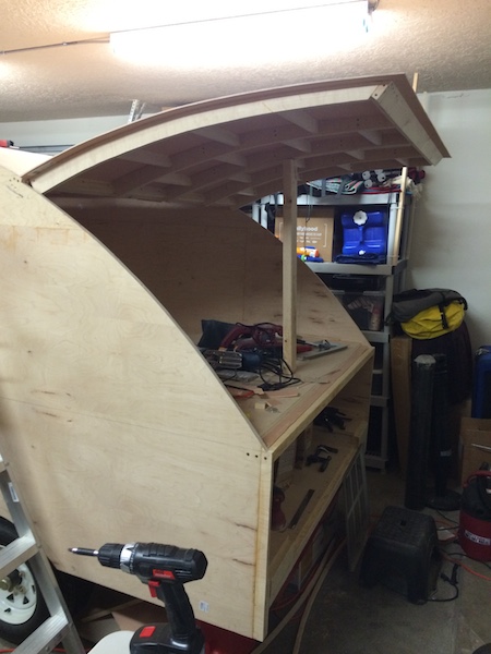

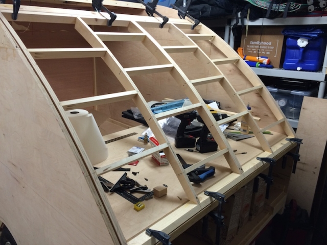

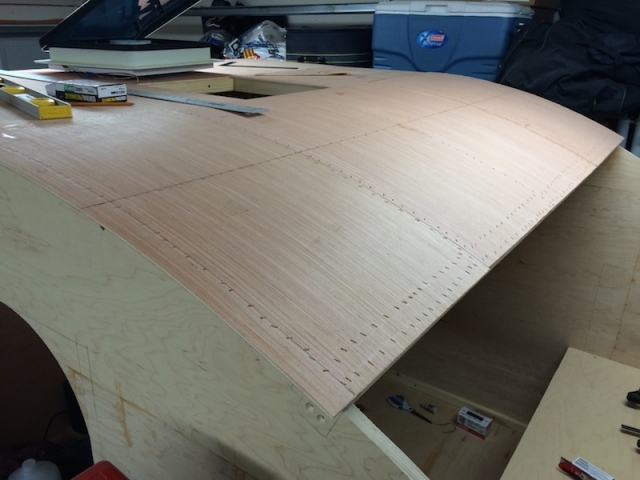

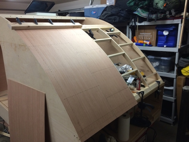

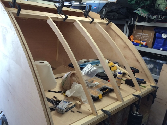

Postby Barak » Sun Nov 09, 2014 11:34 pm
I have put some work in to the teardrop this last month. Built the hatch and finished up the roof:
Built the hatch in to the teardrop using spacers as many have recommended doing
Used the same 5mm ply for the hatch, no issues with bending

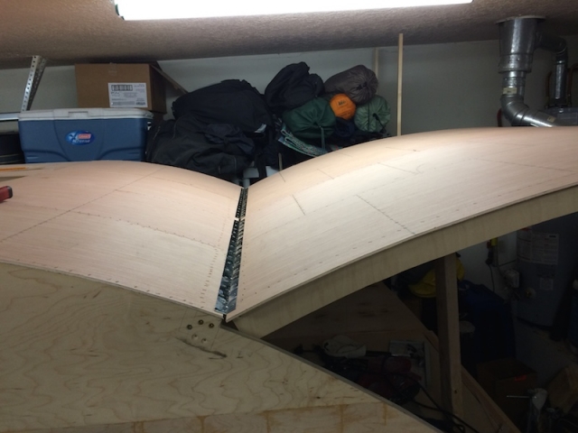

Then finished up the remaining roof section:
Fitted two 30" piano hinges. I will later insert a vinyl strip underneath for waterproofing and use longer screws.

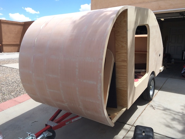

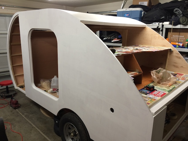

All major construction finished!
Postby Barak » Mon Apr 13, 2015 9:12 am
I'm happy to say that I have been making progress in the past couple of months. The winter was a bit too cold to work in the garage (even here in sunny NM) and I ended up getting a garage space heater, but late in the season.
So the next 45 images are what I have done since December. I am going to leave the inside as is for now and put all of my efforts and time to finishing the exterior and weatherproofing it so I can get this thing on the road, hopefully within a month or two.
So here goes:

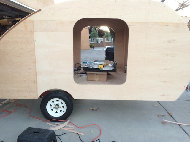

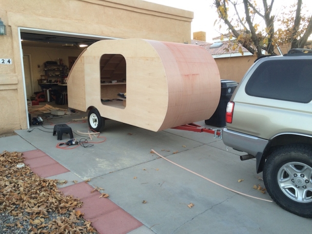

Back in December, after pulling the trailer out and having a look, I decided to install larger wheels on 13 inch rims to replace the HF originals. At first I thought I might have gap issues , but didn't need to use spacers. But did need to cut out wheel wells for the larger diameter tires. - These will not be visible from the inside as I will make cut-outs in the memory foam mattress.
The exterior cut:
Image2014-12-06 12.20.14 by bnaggan, on Flickr
The interior cut:
Image2014-12-06 11.20.52 by bnaggan, on Flickr
The NEW gap:
Image2014-12-06 12.21.58 by bnaggan, on Flickr
Old vs new tires:
Image2015-01-06 09.27.34 by bnaggan, on Flickr

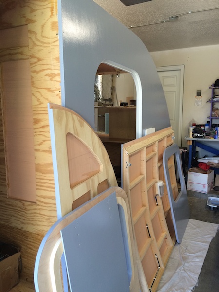

SIDE DOORS:
I decided to use the cutouts from the walls as my doors. Ordered two RV windows and wanted to build an internal lip that would serve as the door stop/seal lip. I added a 5 mm spacer inside to accommodate the future seal, but it was a long task and a lot of cutting.
Image2015-01-16 16.21.41 by bnaggan, on Flickr
Internal lip:
Image2015-02-22 16.53.57 by bnaggan, on Flickr
Cut out doors and windows:
Image2015-01-16 16.21.54 by bnaggan, on Flickr
Windows: The RV windows I got were meant for a much thicker wall than my 3/4 inch ply so needed to add thickness to match:
Image2015-02-22 16.54.07 by bnaggan, on Flickr

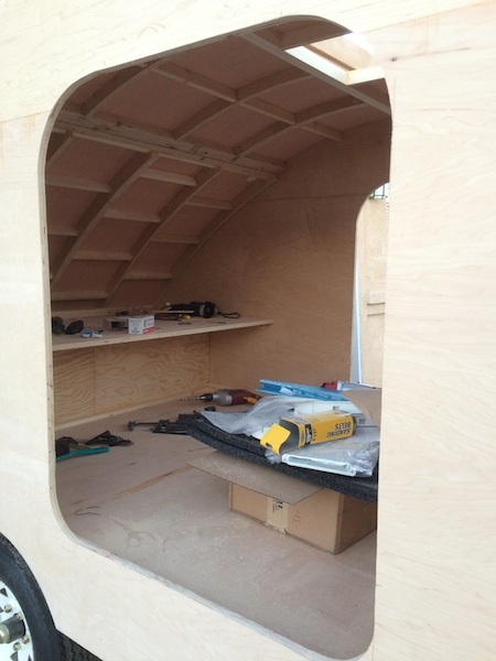

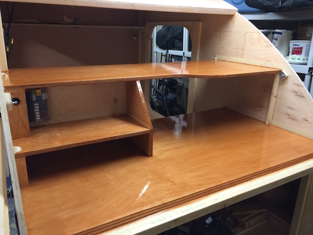

Galley
Postby Barak » Mon Apr 13, 2015 11:10 am

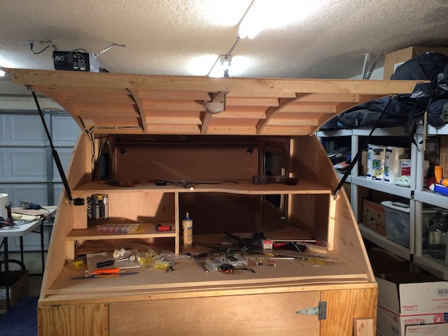

The galley, in this stage will be a simple secondary shelf, under which, on the right, my AC unit will fit (future), and on the left, have a small cub bard for the stove and a place to install my 12V electrical board.
I started with a plain shelf:
Image2015-03-07 17.44.29 by bnaggan, on Flickr
Image2015-03-07 17.44.42 by bnaggan, on Flickr
Built the stove slot:
Image2015-03-09 08.28.56 by bnaggan, on Flickr
Shaped the shelf for a more interesting look:
Image2015-03-09 08.29.03 by bnaggan, on Flickr
Installed 12V fuse box and two of the three 12V outlets:
Image2015-03-10 18.44.38 by bnaggan, on Flickr

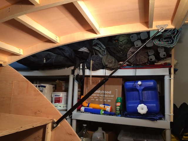

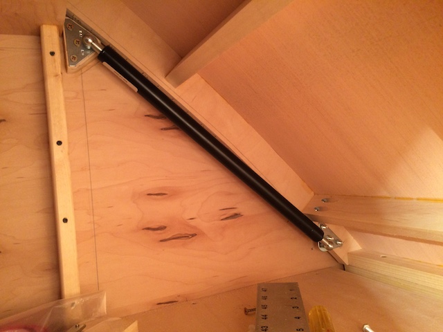

Purchased a couple of gas springs for the hatch and installed:

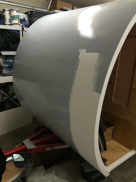

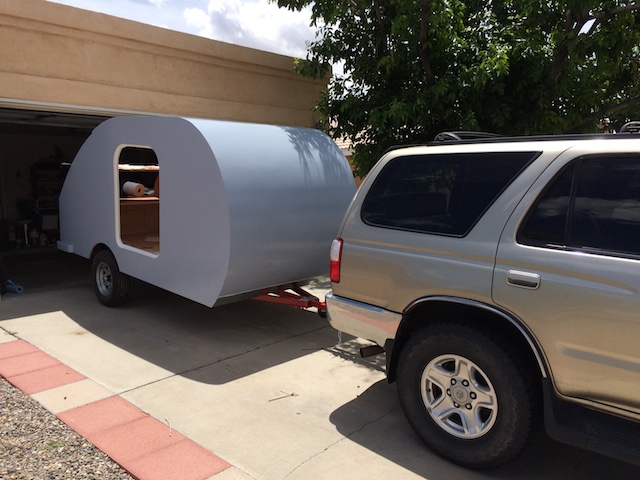

Then, took off all of the hardware and the filling and sanding process began:
And first of three coats of primer went on:
Then three coats of Behr "Twilight Gray" (I really liked the name of the paint hence the teardrop name)
Then out for a first look in the sun:

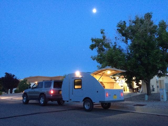

And finally, re-installed all of the hardware, lights, installed and wired up trailer lights, weatherstripping, waterproofing, cleaned, put mattress in and after a very very long day, went out for the first test drive.
Then the next day, went on a 150 mile, camping trip to the Jemez mountains, and even had some rain to test the weatherproofing. All was well.
The tow was uneventful, trailer towed perfectly, no swaying, and only lost about 15% on the fuel economy overall.
Kids didn't want to leave the perfect little play space and had a very comfortable night on the memory foam bed.
Very happy camper! :thumbsup:
