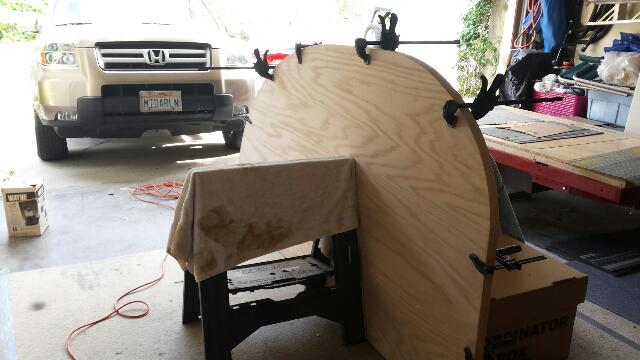

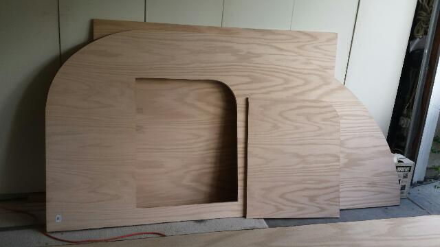

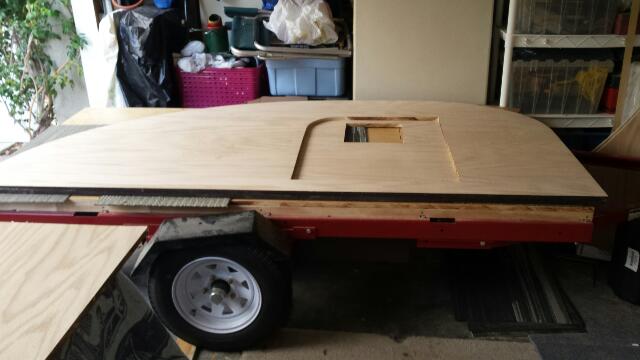

Postby Graniterich » Sat Nov 01, 2014 8:00 pm
Clamped and sanded. Doors and windows cut out

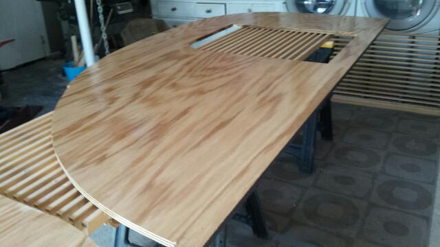

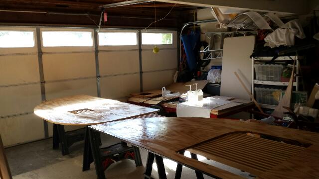

Postby Graniterich » Tue Nov 11, 2014 1:03 pm
This weekend I got three coats of aeromarine epoxy on,, was my first time with epoxy, turned out pretty nice. I also made a 120v power inlet/solar to be mounted under the trailer just forward of tail light. Recieved switches, ammeter, and built my own power center with fuse parts we throw away at work.

Postby KCStudly » Tue Nov 11, 2014 1:14 pm
Walls look nice. :thumbsup:
Is that a modular work bench system? I'd like to see/hear more about that.

Postby Graniterich » Tue Nov 11, 2014 2:31 pm
No, they came out of a building, some sort of ceiling office treatment. They may become spars, or sticks to build cabinets

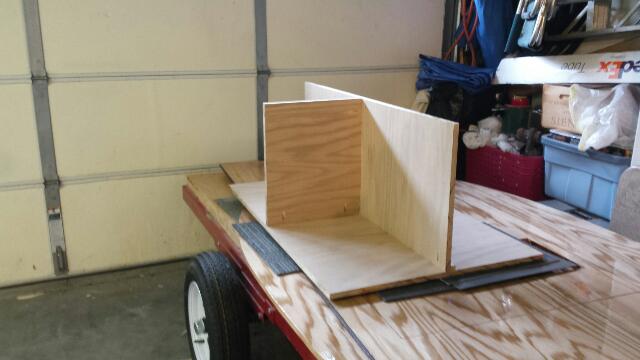

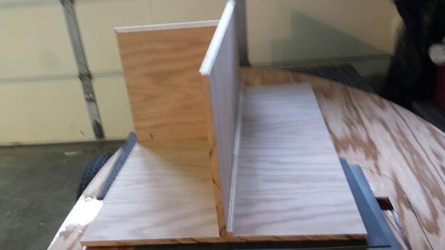

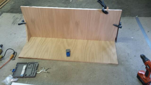

Postby Graniterich » Tue Nov 11, 2014 5:26 pm
And now for the bulkhead, first time using the kreg, and yes I now know what you guys know, best tool ever

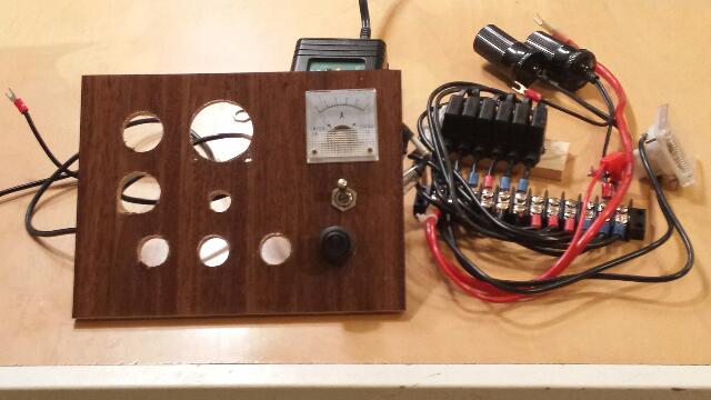

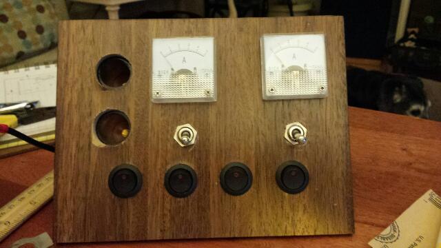

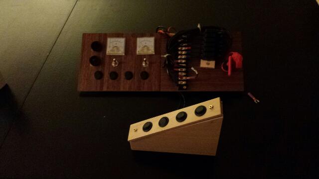

Postby Graniterich » Tue Nov 11, 2014 10:09 pm
Home brew electrical panel

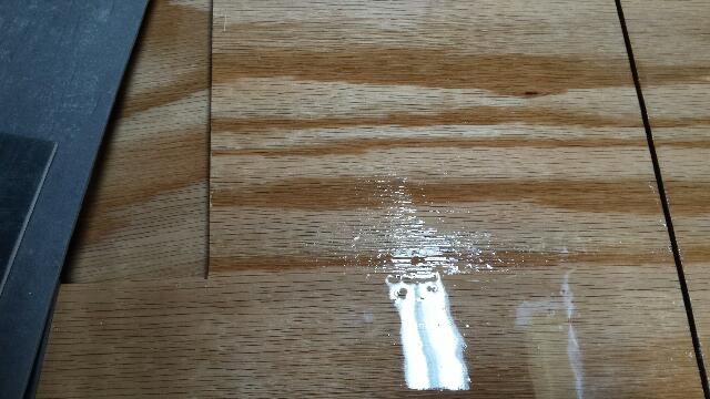

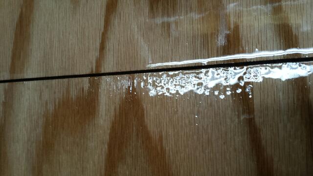

Postby Graniterich » Fri Nov 14, 2014 8:26 am
Some issues with epoxy, brush strokes, suggestions? Electrical finished, gonna be hidden. Last is my shelf corner right for glasses, and inside outside switches

Postby KCStudly » Fri Nov 14, 2014 9:32 am
Almost looks like something oily. What kind of prep did you do before applying the epoxy?
Re: Please to meet you, my name will be sugaree
Postby Graniterich » Fri Nov 14, 2014 9:51 am
Just cleaned with tack rag. I don't think it is surface stuff, it is like I didn't brush enough in these areas, lots of brushing in not a lot of time! Those spots look like the second coat, probably should touch up with epoxy. Is that fisible? Really don't want to do a whole four coat

Postby nevadatear » Fri Nov 14, 2014 1:35 pm
Yes you can do a partial coat. I just did a repair that way. But you will need to sand to feather it level afterwards.

Postby Graniterich » Fri Nov 14, 2014 2:48 pm
Thanks I will build up, and sand
