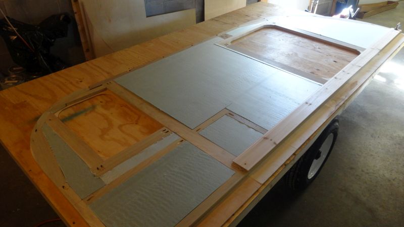

Well I have been on a close to two month hitch at work so I've been unable to get anything done on the camper, but I know that spring will be here soon and along with that camping season!
I framed up, insulated and applied the cedar planking on one side, hope to finish framing up the other side today. I feel I may have used too wide of poplar framing for the door and added some weight but I was concerned that the door would have to most stresses on it so I went overboard. Total weight of the side with door and window comes in at 70 lbs, how does that fall in line with other builders weights?
The insulation went in well, a nice tight fit with only one bad measurement near the door.
The cedar planking was super easy to put in. It was fairly cheap at $15/package and I used two so $30. Biggest benefit is I don't have to do any staining, painting, etc so much less work, plus I can use the camper as a cedar closet when not camping...guess I better buy that fur coat my wife's been asking for!
My next decision is on the interior ceiling. I planned on using the plank cedar tongue and groove but it comes in 8' lengths and my width is 52" so I'd have to put in spars or end up with a lot of waste cedar. Does anyone have any advice on ceiling spars? I was thinking one on side 2' in from the outside so that I would be able to use the left over cut but I'm not sure if it would be difficult. I was thinking of using plywood similar to how I've seen some make their back hatches. Then I was thinking of using canvas to make a headliner of sorts. I was thinking of ripping the cedar planks down to run along my roof joices to hold the canvas up. I'm afraid the canvas would sag, anyone ever make a canvas headliner? I plan on using 1"x2" stood on end as my joices with the space between filled with foam board insulation.
