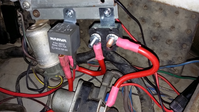

What size wire did you put though to the car bat?
Hi Marcus,
I am not sure what you are referring to when you say you got a guy to do it for me, I assume you are referring to the wiring. Also what is the charge to the car thing?
Yes I did all mine. I used 8awg wire, 85amp 112/0.30 marine tinned. But if you can go bigger, do so. If the wire is too small you get too much current drop by the time it gets back to the camper battery. From the battery I used an auto reset 50amp circuit break, then 70amp relay, so that it is only connected when the ignition is on.
2015-03-26 08.27.59 (640x360).jpg (193.94 KiB) Viewed 1401 times
( Above ) I have just wired our Super Snipe for our next trip away.
This is the Anderson connection (the grey one) on the back of the Capri.
