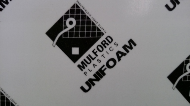

Hi Wayne, yes the door holes shouldn't be an issue, I didn't cut mine out until the doors arrived. The beams are about 40 x 20 (I think 45x22 might ring a bell) treated pine from Demolition Supermarket. I don't know if they are a regular stock item for them or not. They were 3m long, so cut in half were perfect to get two beams. Sorted through to get good straight ones without knots and ling strait grane.
The inner liner was at Arthurs, on racks to the left of the front door outside under the veranda. I don't know if they still have it, Dale said that last time she was there they had that area full of their picture framing materials.

Hi Frank, I remember the racks outside of Arthurs and I had a dig around in there, wish I was working on my teardrop then.
I have printed a copy of the image you posted, I will take to Arthurs and ask if they have any hidden away in the bowels of the treasure trove.
