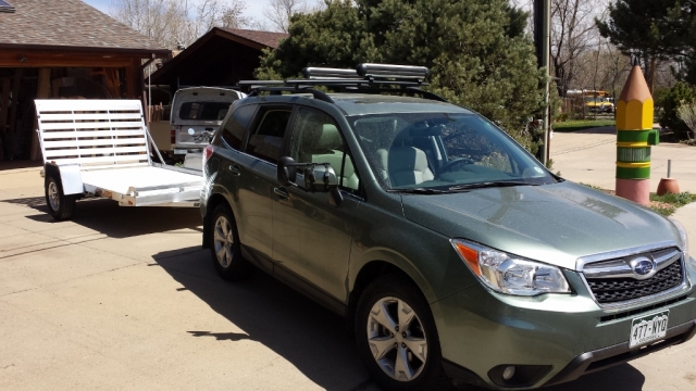

Yes this is something Im still trying to figure out ,.. The 2013 Subaru Forester has a towing capacity of 2400 lbs but the newer and bigger 2014 Forester was down graded to 1500 lbs ,, It seems as if Subaru is trying to discourage towing in the US while promoting it in Australia, the UK and Europe (towing caps in those countries are double or more what they are in the US.

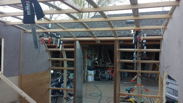

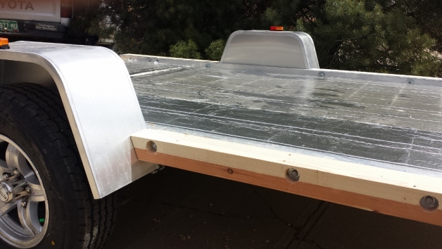

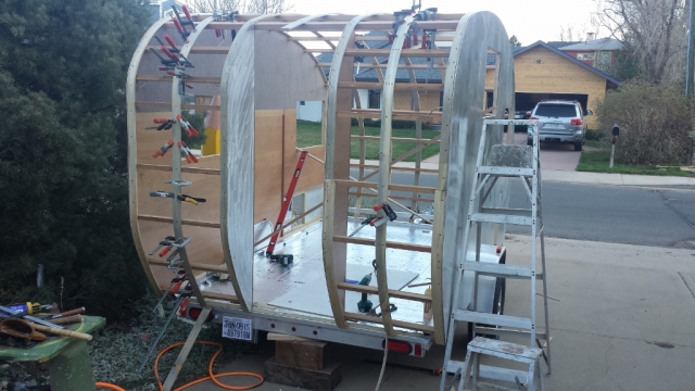

Finally the trailer chassis has arrived. I had fun hooking up the new trailer and fiddling with the brake controller on the way home.. First step was to remove the 65 lb rear ramp gate . I will try to sell it on Craigs list.. After leveling the trailer , I bolted on two wood rails to widen the overall box width from 72 inches to 79.5 inches. Saturday morning I hired my daughter and boyfriend to help me stand the walls and fit the spars into the wall notches. I had to do some custom fitting at the interface between the aluminum chassis and the wood structure . Image Image Image Image The trailer without the ramp gate weighs about #475 and has a tongue weight of #65.

I'm curious how you sealed the end grain between your extension rails and the fender? Hoping that you used some sort of sealer there to protect the end grain. Perhaps they got sprayed with the varnish, too?

Good question , in this case I smeared some silicone into the end grain and smushed it tight to the fender. If I do everything else right these bolted on side rails will only see water on the bottom side . I was thinking of using some elastomeric coating underneath like they use on trailer home roofs. also the bottom half of the rails are redwood.

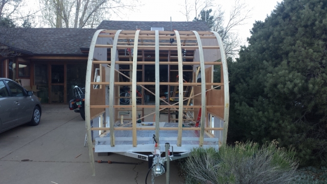

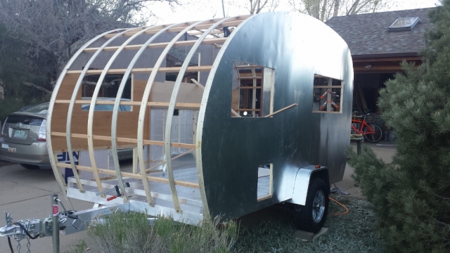

After the spars were installed I proceeded to bend 3/8 thick pine ribs running from the front to the back of the trailer. One of the curves in the rear of the trailer was too tight to bend the ribs and I had to laminate two 3/16th strips to make the bend. Image Image Image Image

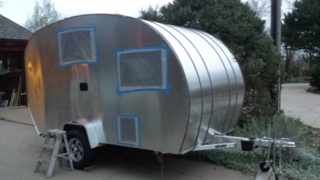

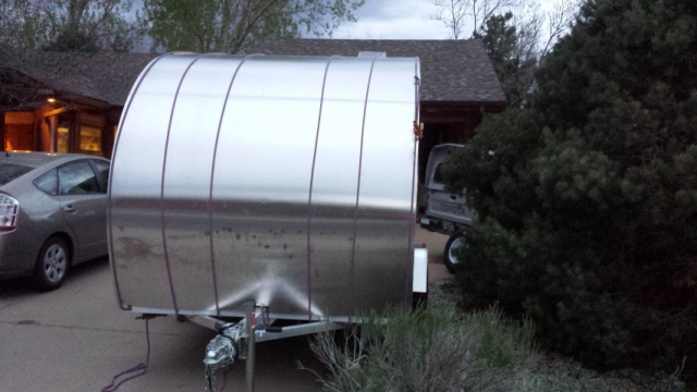

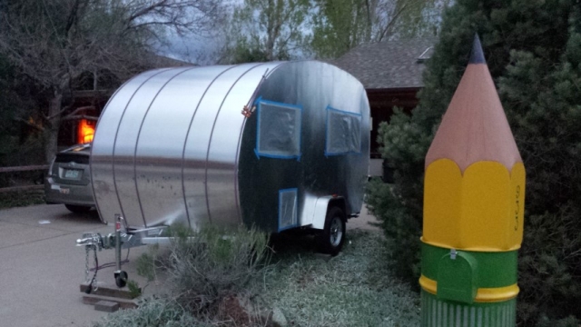

Here are some photos with the one piece .040 aluminum roof in place . We siliconed the edges and ran rope across the box to cinch the metal down to the frame. Image Image Image

Postby S. Heisley » Thu Apr 16, 2015 6:00 pm
Since that trailer is too big to fit in the garage, I think you've got the right idea, to get 'er weather-tight as soon as you can.
...Cute mail box. :thumbsup:
