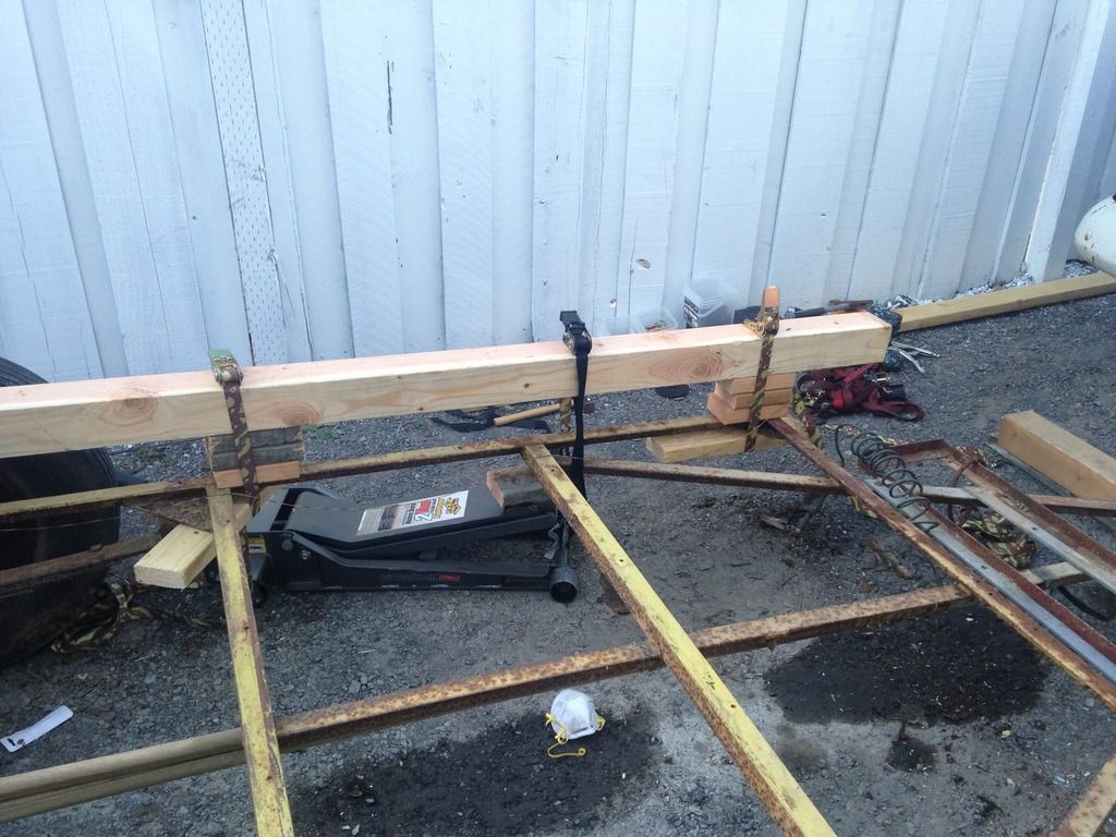

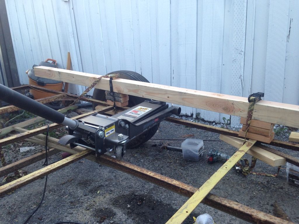

Thanks for the ideas on how to straighten the frame. Here is what I came up with using your ideas.
By putting the jack above and below I was able to take bends out in both directions. Spent a few hours going really slow moving the bending rig back and fourth and top to bottom to work the bends out. All the time using a string line to keep track of where things needed to go to get it flat again. Got it to within about 1/16" of being totally flat. Should be plenty good.
There is also about 1/4" of bow to the left side.
I am going to try to pull it out when I attach the frame to the ply wood. If it will not easily come out I will just live with it. I know I am not building a watch and things don't have to be dead square.

Postby noseoil » Mon Apr 13, 2015 12:02 am
Dave, excellent job on the frame. As long as it works, who cares how it's done? Great idea with the floor jack for working in both directions.
