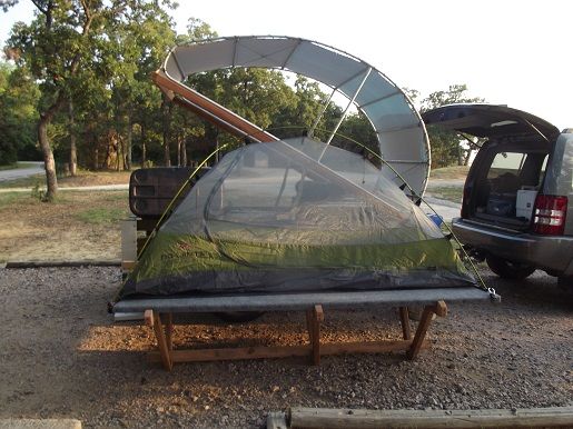

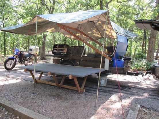

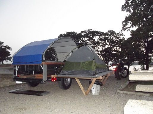

I don't think I've posted these before but here are some pics from the prior rendition with the teardrop shaped EMT and canvas top.
I had 4 watertight plastic truck boxes attached to the inside of the trailer; the back two hinged and swung up to load/unload the motorbike and served as chuck boxes. All were fully accessible from inside or out with the motorbike loaded or unloaded.
The bed/tent platform hung off the side of the trailer on a collapsible 2x3 cedar frame or could be placed inside on top of the truck boxes. I still have the option to hang outside on the current fully enclosed shell.
The shade tarp is supported by the teardrop frame and a few tent poles.
