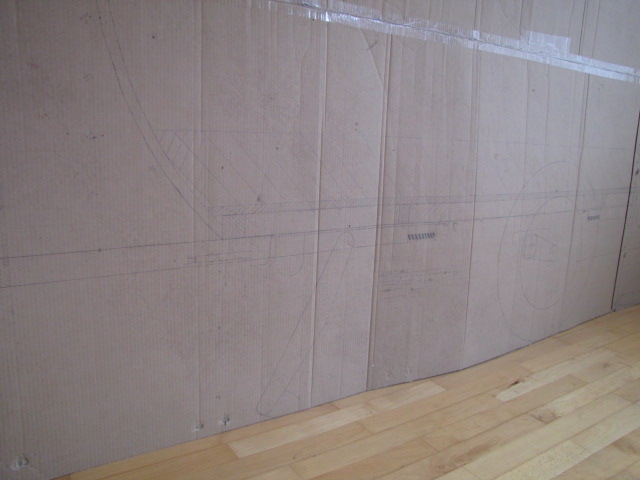

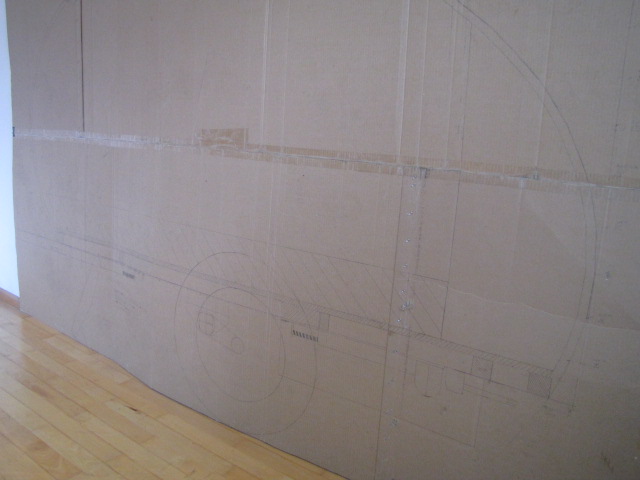

Postby smeerkees » Tue Sep 15, 2015 7:50 am
Hello everybody,
So, i have a small trailer chassis, and some photo's and a silhouette drawing of the Grumman 2 8x5 ft. model teardrop trailer.
Is there already some kind of plan in this madness?
Well, yeah, a 1:1 scale on a big piece of cardboard drawning by pencil, to be precise.
It's not realy finished yet, but gives a good idea dimension wise.
It's helped me a lot already.
My only problem here is that photographing a big piece of brown cardboard, with a pencil drawing is not that easy, regarding the type of light
there is available. But i give it a try.
Hmm, pretty difficult to see much of the drawing.
Any body an idea to enhance this situation? (, or do i have to re do the complete drawing with a big black magic marker...)
Greets, Kees.

Postby noseoil » Tue Sep 15, 2015 7:59 am
Kees, that's the right way to do a build!
This way you can see all the parts, joints & sub-assemblies first, then see where things need to be changed or moved. The best tool you have now is an eraser, not a pencil! Once it's a finished design, use a magic marker to make the lines permanent and it's ready to build. I like it.
Don't forget lights, wire runs, battery, or any other things which need to be added for the finished build.

Postby dales133 » Tue Sep 15, 2015 8:04 am
Dosnt look to bad at all kees.
Its faint but i see the shape and thats all thats important.
Go and find the generic benroy plans in the resources and follow that as a guideline for your build.
Ive made alot of changes but the basic construction techniqes are all outlined and its easy to follow.
Youll also pick up ideas or find new ideas as you go on

Postby smeerkees » Tue Sep 15, 2015 2:56 pm
Hello guys,
Thanks for your input.
Hmm, i know that my pensil drawing is not quit finished yet, also because of some design decisions i still have to make.
About some of those design decisions, i will probably ask for your opinions at a later time.
However about 90% of the drawing on the cardboard are already fixed lines.
Either, because of the already existing trailerframe, or because of the fixed lines of the Grumman 2. 8x5 ft. silhouet design, or even some already taken design decisions. (Think about the placing of the spare wheel under the frame, and the lengthening, and widening measurements
on the existing frame to meet the 8x5 ft. specs.
Already the drawing kept some concentration because of the intergration of several inch/foot measurements, into the further metric drawing.
Because of the (in my eyes) beautifull 8 ft. length, to 5 ft. width ratio , i kept those as they are.
I noticed that even slight differences in that ratio have already big consequenses in the result, looks wise.
(This decision has already consequences in the availability of the aluminum types, and sheetsize i want, here in the Netherlands.
I will tell you about that at a later time too.)
Ok, I will draw the already fixed lines with a black magic marker. Because the drawing is a partially kind of see through one, i will try to use
some differend types of thicknes in lines, this regarding the importantie of those lines.
For me it clears the drawing some more, and for the followers of this build journal i can make you some much more interesting photographs
of the drawing to upload here.
Maybe you noticed already that the planning, and work already done is not from a day or two.
Nope, from the time that i began looking for a suitable trailerframe till now, about 1,5 year already.
O.k., that includes finding my current build space. And time wise, off, en on.
So Noseoil,
you are surtainly right about the well spend time planning and drawing before the build....
I hope you give me some time redrawing...
Greets, Kees.

Postby pchast » Tue Sep 15, 2015 9:42 pm
Kees,
Do you want to see it better on your Cardboard or have a computer picture of it?
If just on the cardboard you will need to trace lines with black ink pen or marker,
as you suggested.
You should be able to take a photo of the drawing without flash cover your lights with
a cloth or gel to reduce the glare. Then use a program like Gimp to transform the colors
in your computer for a more readable copy.

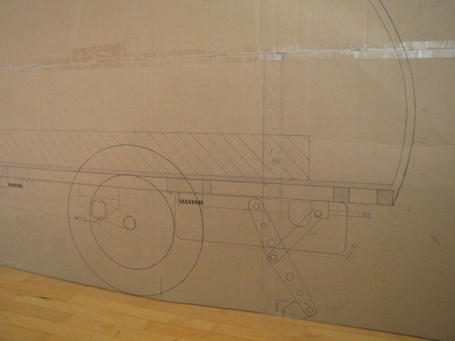

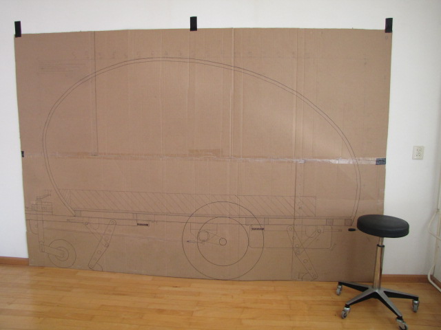

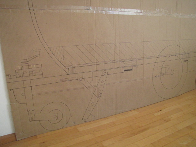

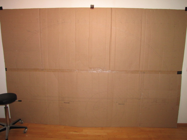

Postby smeerkees » Sun Sep 27, 2015 3:36 pm
Hello everybody,
At last some pictures of the teardroptrailer redrawing with a magic marker..
Let's see if this looks any better.
Hmm, i think it is.
Glad i did it over with a magic marker for 2 reasons.
1) i made the insulation space of the roof a bit wider. From 2cm. to 2,5cm. (2,5 cm is about 1 inch).
Now all the floor beams will be 5cmm x5cm x3mm (2 inch x 2 inch x 3/10 inch (?), and the walls, and roof space 2,5 cm x 2,5 cm (1 inch x 1 inch).
With wall thickness of the wallbeams of 2 mm, and the roof beams probably 1,5 mm.
2) At the redrawing with the magic marker i also drawed the complete nosewheel assembly, and there i had a little problem.
I had to move the nose wheel 2 inches to the front of the trailer, because i head to little room to turn the nosewheel lever around.
With a little bracket on the existing bracket there is just room enough.
On the drawing the new position of the nose wheel is already integrated.
With the build, i think i want to lower the wall hight (under the frame) some more.
1) To hide the levelling legs in upward position, and the spare wheel a bit, and the storing spaces under the floor (Not yet integrated in the drawing ).
2) For a better look.
The underside of the walls will probably be around the hight of the wheel hub, probably a bit higher.
So that would be around 4 inches lower. That is quit a bit considering that i don't want to mess to much with the silhouette.
Hmm....
Also not yet in the drawing,: innerwalls, door, hatchdoor, tube for the towing bar for a bike carrier, etc....
Greets, Kees.
