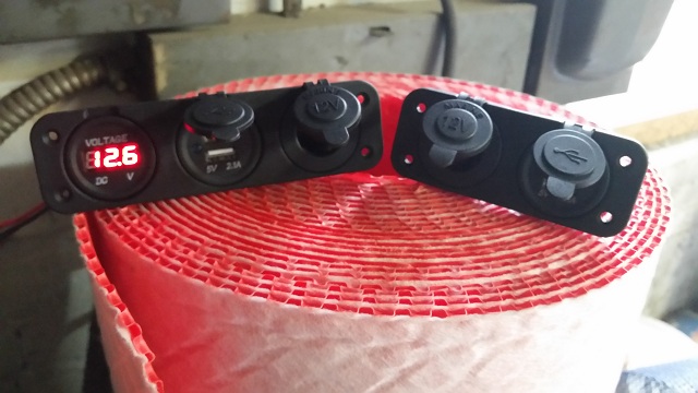

Postby Yukondave » Wed Oct 21, 2015 5:45 pm
Got a few of my DC components from China today.

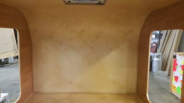

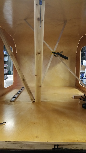

Postby Yukondave » Wed Oct 21, 2015 6:57 pm
Got the inside skin on, waiting for the glue to dry. :pictures:

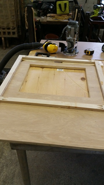

Postby Yukondave » Sat Oct 24, 2015 5:33 pm
Made up a jig for my router and cut the holes in the doors for windows.

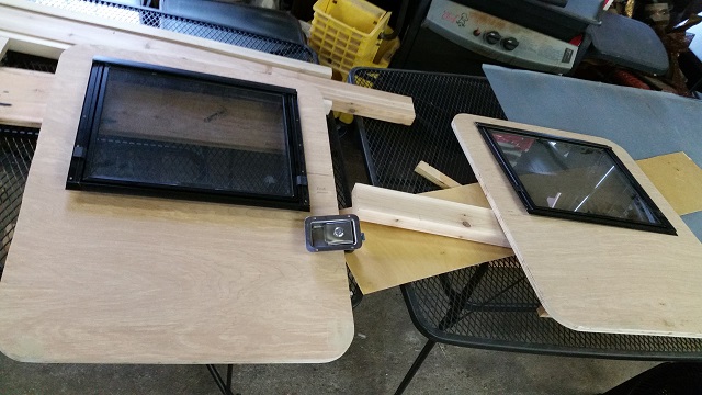

Postby Yukondave » Sun Oct 25, 2015 5:32 pm
Didn't get much done today, did some wiring and cut outs in doors for the latches. Test fit the windows and latches, next step stain and varathane.

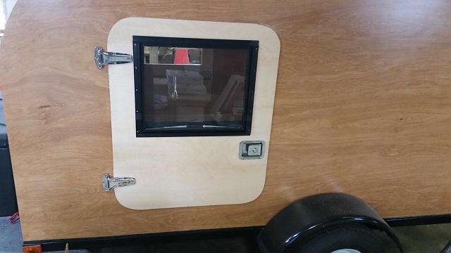

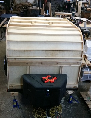

Postby Yukondave » Thu Oct 29, 2015 5:11 pm
Struggling with building the doors, mangled the plywood when my router got away from me. Planning to start again on the weekend after a trip to the lumber yard.
In the meantime I ripped a few strips off a piece of oak lumber to cover up the gaps in the plywood joints that didn't quite line up.

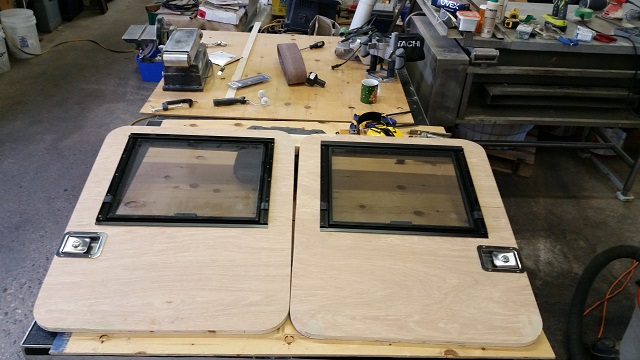

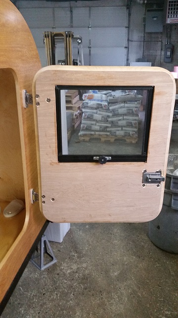

Postby Yukondave » Thu Nov 05, 2015 8:24 pm
I've been a bit of a nitpicker building these doors and have made a few changes so they have taken way longer than I had originally planned. I have some more work to do before I treat them with CPES and 3 coats of Helmsman then I can bolt them on and move on to building the back hatch.

Postby rebapuck » Sat Nov 07, 2015 1:18 pm
Are they awning windows?
Judy
1966 VW camper
1967 VW singlecab
rebapuck
Posts: 2243
Location: Chapel Hill NC
Re: Yet Another Benroy Build
Postby Yukondave » Sun Nov 08, 2015 7:40 pm
rebapuck wrote:Are they awning windows?
Yes they are, I wanted windows that I could keep open when it's raining.

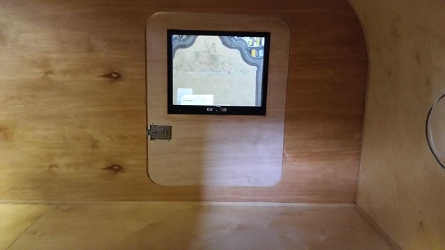

Postby Yukondave » Sun Nov 15, 2015 9:20 am
After taking a week or so off I'm back working on the doors. I'm finally happy with them mechanically, just need to cut some cover plates from 3 mm plywood to cover up the t-nuts them they'll be ready for CPES and varathane.

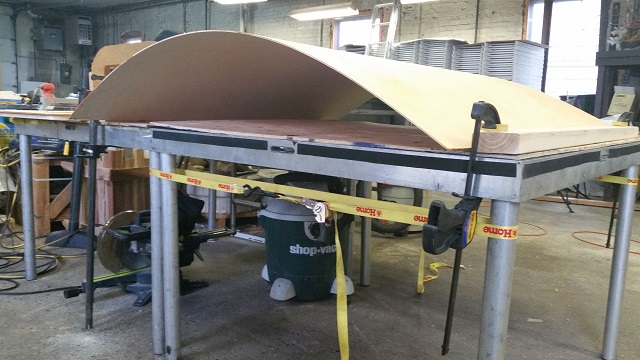

Postby Yukondave » Sun Nov 15, 2015 9:23 am
Attempting to pre-bend the plywood for the hatch, we'll see how this works out.
