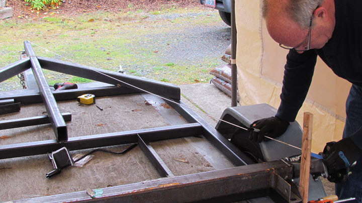

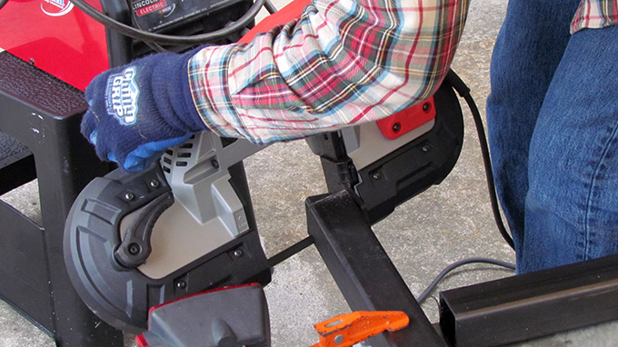

Postby RunnerDuck » Thu Sep 24, 2015 7:13 pm

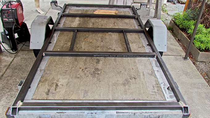

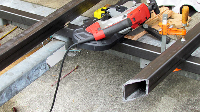

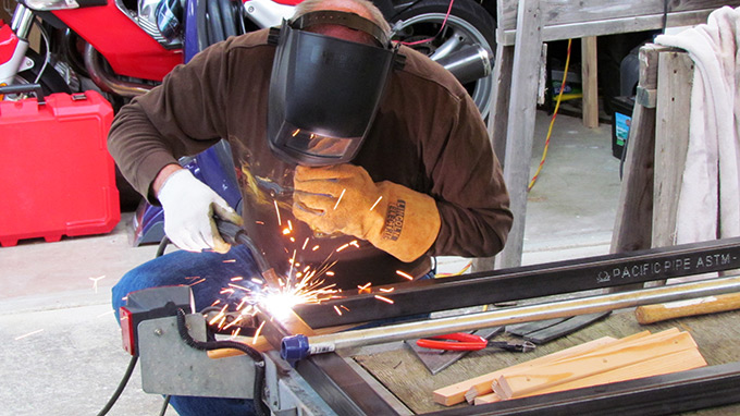

I made some good progress on the frame with the help of my neighbor who recently built a tiny trailer. Neither one of us have good welding skills but his are better than mine.
We started with a pile of cut and uncut pieces of steel.
We built the frame on the frame of a flatbed trailer that he had. It was the most flat surface around.
We cut the end tapers on the side pieces and ground them flat and smooth.
We spot-welded all the pieces of the rectangular frame together after squaring everything up, measuring from corner to corner to verify square.
This as far as we got today, Ken had to go to work around noon so no tongue or "A" frame supports yet.
There is a professional welder that I'll be taking the frame to for final welding. Trust me, it will be perfect! :goodmorning:

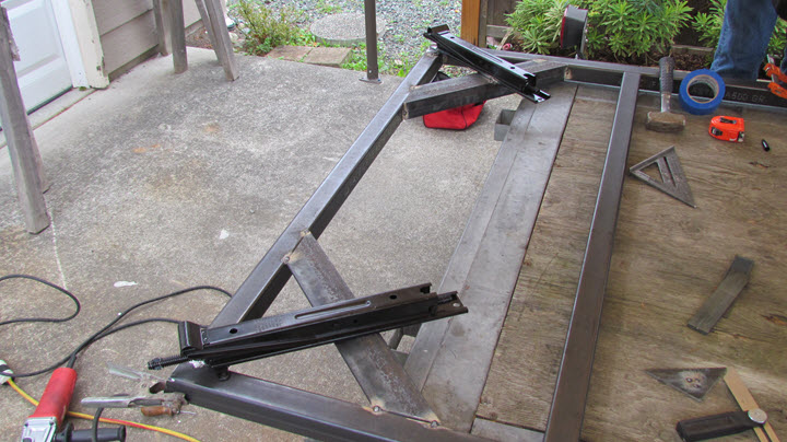

Re: 5' X 10' Grumman 2 Sort Of Day 5
Postby RunnerDuck » Fri Sep 25, 2015 9:30 pm
Today I worked on smoothing out the curves on my pattern. Lot's of hand sanding but I'm gaining on it.
I also worked with my friend to tack weld the tongue and "A"-frame supports. Our little power hack saw had a hard time handling the large angles but we did it.
By the end of the day we had the frame done, at least as far as the tongue goes. Still a little bit more stuff to do for the corner jacks, the tongue jack and possible bumper mounts.

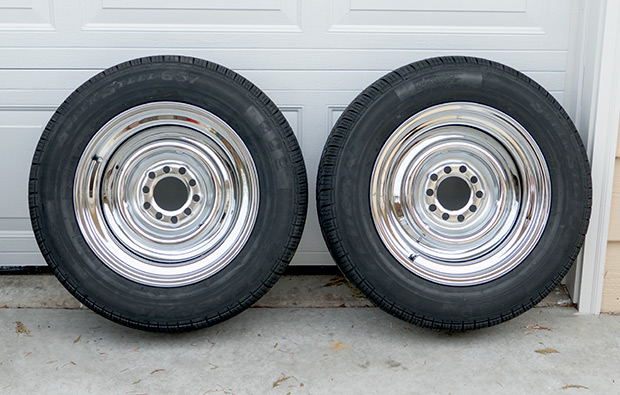

Oh yeah, my wheels and tires arrived, woot!
I don't have the "moon" hubcaps on in this photos but they are going to look great!

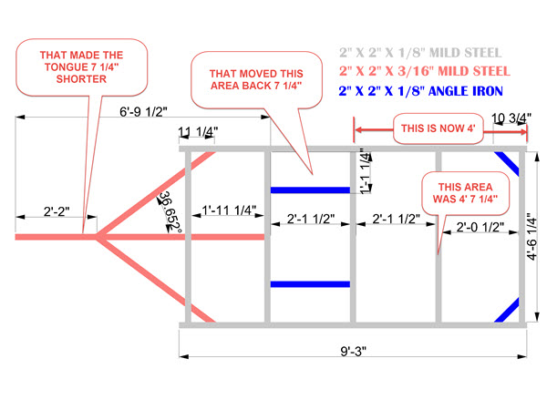

Yesterday, day 5, I realized that I'd made a mistake on day 4! :x
While welding it up I realized that I hadn't spaced the cross members to take the most advantage of a 4' X 8' piece of plywood. I decided to move the center section back so that the plywood would center on the middle cross member.
What I didn't think about at the time was that it would shorten the tongue by moving back 7 1/4"!
Frame Dimensions.jpg (55.01 KiB) Viewed 3751 times
Fortunately I had cut the tongue extra long so in the end only lost 4" or 5" which still leaves plenty of clearance when backing the trailer.

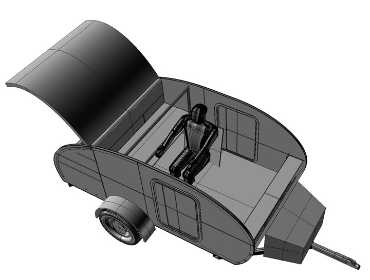

Just to refresh your memory here was my original design:
seat looking back.jpg (38.1 KiB) Viewed 3727 times

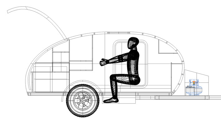

By the end of yesterday I had a new "Sidesaddle" design"
side saddle.jpg (49.67 KiB) Viewed 3727 times
I think this will work much better. I'll be out of the way of the doors and have easier access to both ends of the trailer when the seat is up.
I'll probably spend most of today refining the design and getting better definition of my cabinets.

I have found that printing out shop drawings and taking them to the build site goes a long way toward making the project come out like the plan. Well that, and it also works better if you actually look at the plans! :lol:
I found myself making mistakes when I thought I remembered something and realized that I had gone "off plan". :? It is so easy to remember an original thought and forget that you have made a change on the plan for some reason or another, only to find out that your original thought was okay, but your revision would have solved other issues.
Been there, done that.
Re: the foot well, In your first image ^ it looks like your stand-in's toes are up against the back of the well, while his heels have plenty of room. With the well moved back, wouldn't that have improved, not gotten worse?

KCStudly wrote:Re: the foot well, In your first image ^ it looks like your stand-in's toes are up against the back of the well, while his heels have plenty of room. With the well moved back, wouldn't that have improved, not gotten worse?
Thanks for the "hindsight" :NC
I had already made all the moves on the frame and had them welded when I saw what I had done. While the well would have given more toe space I still didn't like where I would of had to sit in order to access the pull-out desk that will be on the rear wall.
I too take my drawings to the work site but making a change on the fly without going back to fully check the design is my guarantee for failure.
As it turns out I actually like the "Sidesaddle" design better than my first, it's going to work out great!

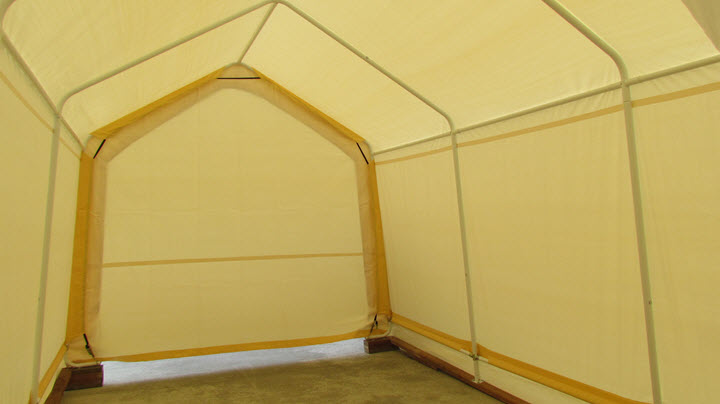

Postby RunnerDuck » Wed Oct 07, 2015 9:17 am

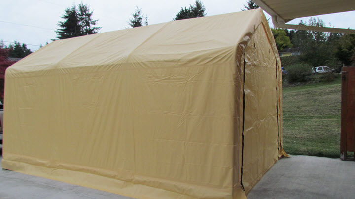

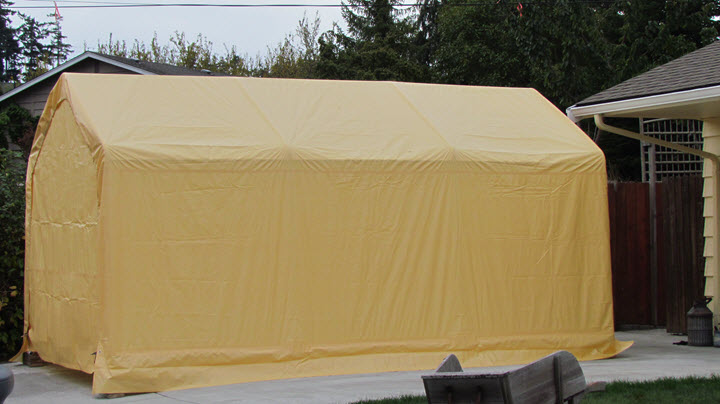

After a few days of waiting for parts to arrive I decided to build a portable garage to put my teardrop in while I work on it. I think this will work out great and provide the space required.
It's a 10' X 17' HF portable garage and seems to be pretty well built. Here on the island we get some pretty good winds in the fall and winter so it will be a real test to see how well it holds up. Hopes are high.
I put the zipper door on the end closest to my woodshop making it easier to get stuff in and out. The other end is solid and will only be opened to wheel in the frame and take the finished TD out. At least that's the plan.
My axle has arrived and I believe I have all the pieces to finish the frame. Once those are tack welded in place the frame goes to the welder for professional welding. That will happen on October 20. Until then I'll start working on the final design and start cutting some wood.

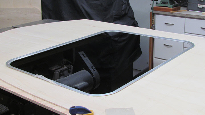

Postby RunnerDuck » Mon Oct 12, 2015 9:24 am

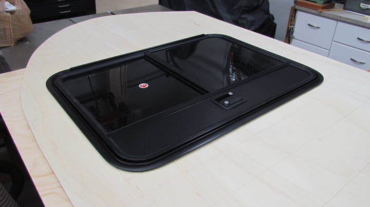

I made a little progress today. I worked on my pattern some more and now have the door hole cut out.
The trickiest part for me was figuring out the corners but after much figuring and hand wringing I went for it. :thinking:
I used my saber saw with a new blade and just took my time. The result was perfection. :thumbsup:
Before I start cutting real plywood I need to figure out my galley hatch. I've got Steve Fredrick's Shop Manual but still trying to work it all through my old brain.

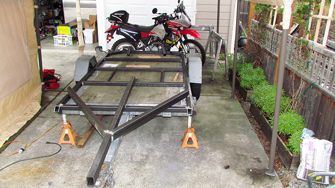

Postby RunnerDuck » Wed Oct 14, 2015 12:26 pm

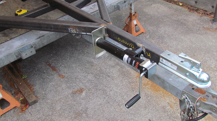

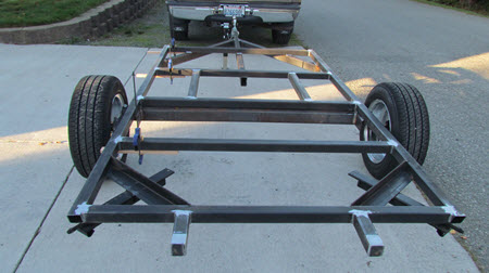

Today I tack welded the tongue jack, corner leveling jacks and axle to the frame.
tongue jack large.jpg (93.46 KiB) Viewed 3491 times
leveling jacks large.jpg (97.54 KiB) Viewed 3491 times
To make sure that the trailer tracks straight I drilled a hole in the center end of the tongue, installed a screw through a long wire with a ring lug crimped on the end and marked the wire where I wanted the axle.
frame1 large.jpg (105.59 KiB) Viewed 3491 times
I swung the wire from side to side to side... to make sure the axle was perfectly alligned and then tacked it into place.
It's now ready to go to the professional welder next Tuesday. I'm getting pretty excited :thumbsup:

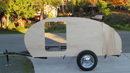

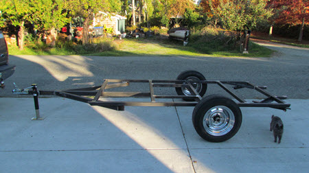

Today I got the frame welded and returned home. It looks fabulous and the good folks at Better Off Road in Oak Harbor, WA , did a great job :applause:
Here is the finished frame with my helper Ms. Kitty Kitty.
Frame 1 big.jpg (45.61 KiB) Viewed 3419 times
Frame 2 big.jpg (31.33 KiB) Viewed 3419 times
And here it is with the template hanging on the side.
