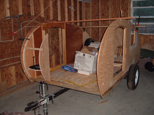

Been making some progress the past few days. A few photos below.
Started my headboard and galley cabinets today. Will post as more develops.
Got the floor framed and insulated
Upper floor skin is on
Got the walls raised for the first time!

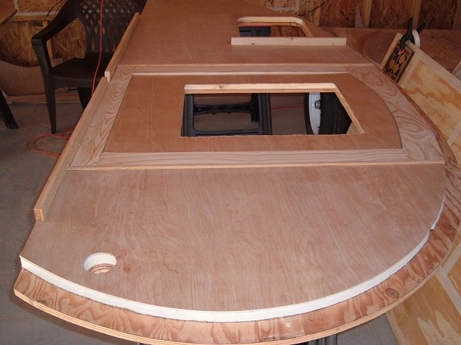

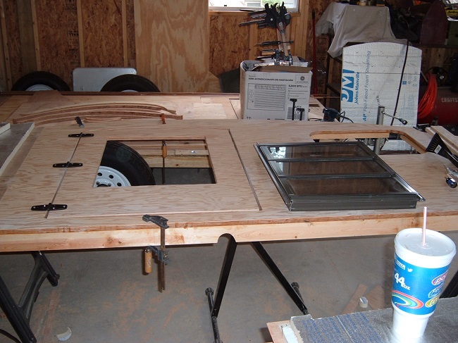

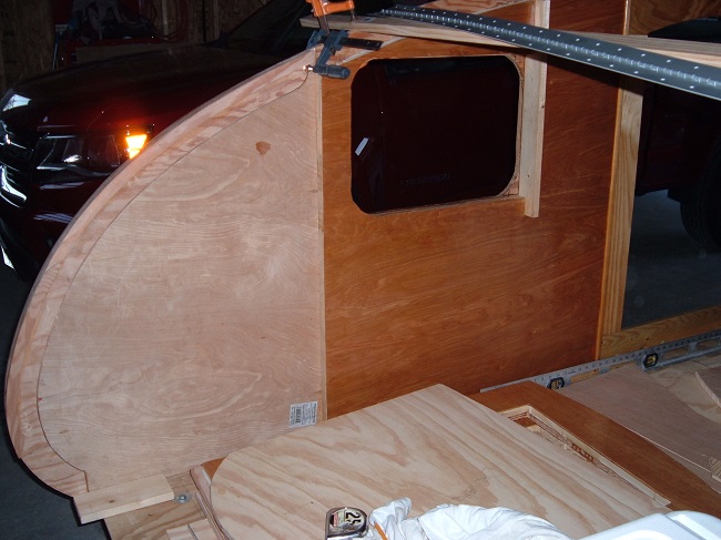

Today is the last day of my vacation from work. I really enjoyed a week of working on the tear full time. Got a lot done. Also had some last minute design changes that worked out very well. It really helped to have the walls up and see what I was doing in full size.
Another thing that really helped was having the items I intend to use, and place them in their future locations. A test fit of my cooler showed I needed to move the galley bulkhead an inch forward. The test fit of my battery tray in the forward headboard area also needed another inch of space to work. So had to move the forward bulkhead as well. It all worked out fine. I'm just glad nothing was glued and screwed in place yet.

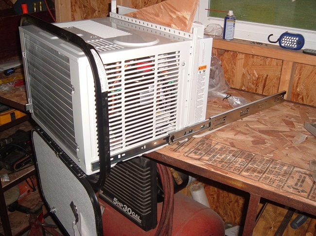

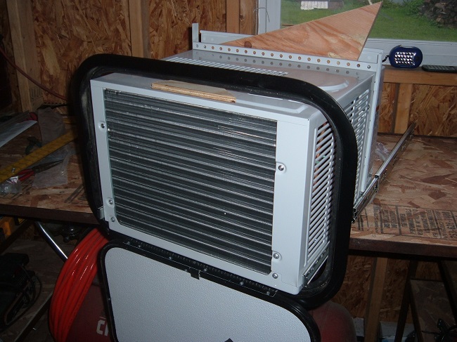

Today I am working on what we be my slide out A/C unit. I'm using some 100lb capacity drawer slides. I'm bench fitting everything first. Then will trial fit it into the tear. I am really threading a needle here with the way this needs to fit together. The hatch I have is just big enough to work.
So far what seems to work best is attaching the slides right to the A/C chassis. The slides will sit level. The A/C nit will be tipped slightly rearward in the slide brackets to provide correct angle for drainage. I am going to build a plywood collar near the front side of the unit. The collar will seal the gaps and will have weather strip applied to it. So when the unit is slid out it will compress the seal between the collar and tear drop wall.
I've posted some photo's. You can see the piece of 3/8" scrap plywood is all I have in vertical clearance. Sides are roomy enough. The hatch is on the A/C upside down for now. Just to keep the door from being in my way while I fit things. Hatch will open upwards on camper and rest on top of A/C when in use.

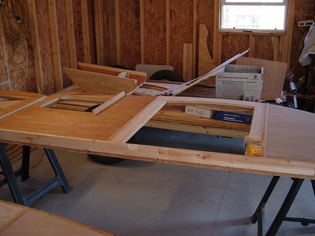

I have the walls back down and flat on the sawhorses again. I am now starting on my wall insulation, door jamb and door seal lip, cutting walls for outer hatch ribs, and interior birch paneling install. Going to try an inside out style build.
Look forward to your input if you have some.

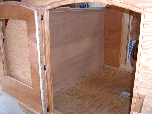

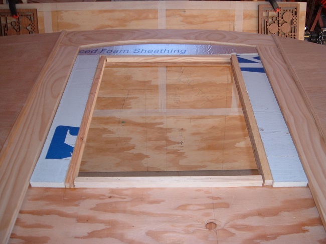

It's been near a year since I have been able to work on my teardrop. The past 3 or 4 weekends I have made some nice progress. I have also scheduled a 9 day run off time off. Just like I did last year. Hope to use the entire 9 days to work on the tear.
I am trying to build from the inside out. My walls are 3/4 ply with 1" foam and 3mm yellow birch sandwiched together. I have both walls ready for interior stain and polyurethane.

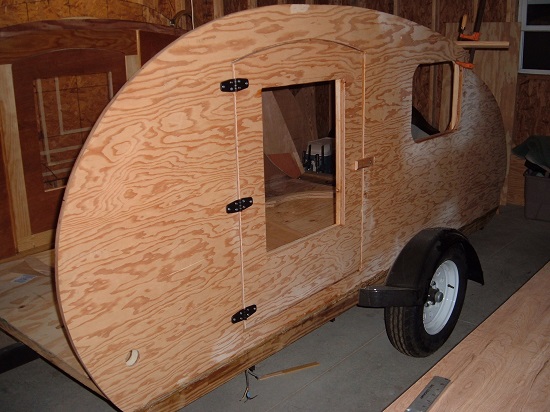

I have one side door fit up with window. Also got it insulated and inner birch skin fit. I'm now working on the door for the other side
My goal for this time off is to have the inner side of walls stained/varnished. Doors hung with windows fit. I then will be ready to mount the walls to the trailer platform permanently. I want the walls up and vertical for storing the trailer this winter. I also will be able to begin working on my interior and galley cabinets once the walls are up for good.
Hopefully I can keep working on it until it gets too cold in the garage.
Fitting door and window
Insulating wall and interior door frame installed
Insulating door

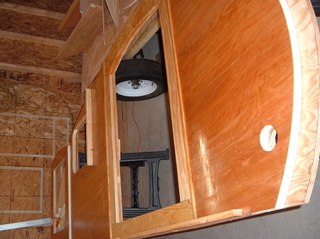

Postby Mr. Lahey » Tue Sep 12, 2017 6:58 pm
Almost ready for final sanding, stain, and varnish!

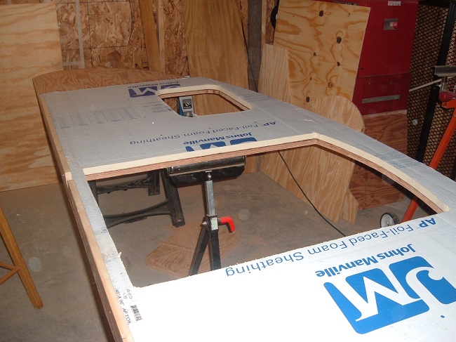

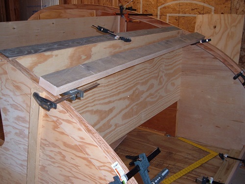

Going to get the main structure finished up now that the walls are vertical. I started with the lower half of my rear hatch seal lip. Photo below shows it clamped up and adhesive drying. I was happy to get this board in place. It showed me that the walls were in line with each other from front to rear. This board is also square to both walls. So the galley area is pretty square.

Day 1 of the staycation has been productive. Cut 2 large beams from recycled oak to mount across the teardrop. Front will be the place to screw hatch hinge. Second large oak beam will form leading edge of hatch to screw back half of hinge to hatch. Cut more oak to form the lower hatch edge gasket seal surface. Got my top half of rear bulkhead cut and fit. Cut the front bulkhead headboard piece. Also cut the interior rear upper cabinets face to rough size. Have many of the pieces mocked in and clamped in place. Headed back out there after this post.

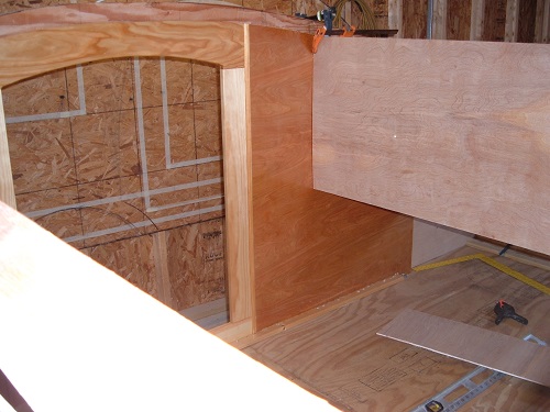

Front bulkhead, soon to be headboard cabinets
Upper rear cabinet face mocked in place
