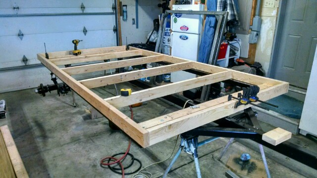

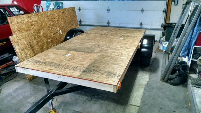

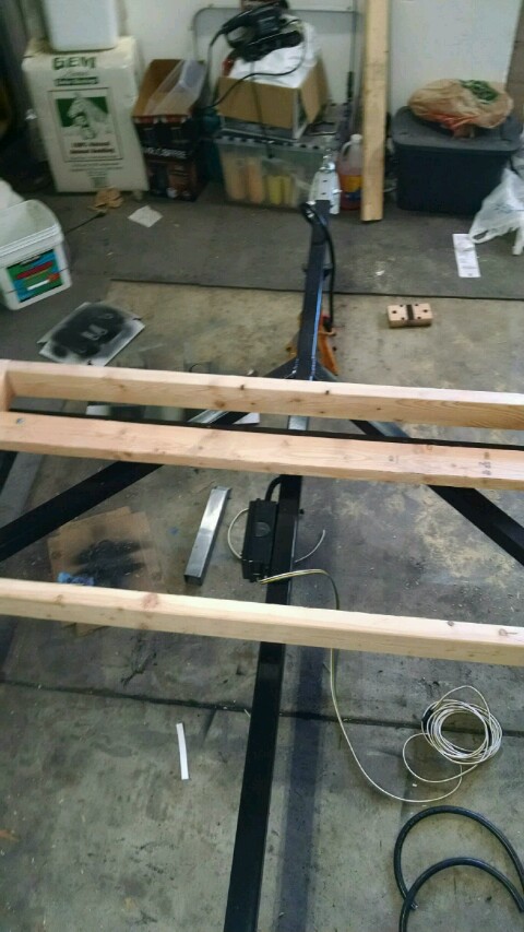

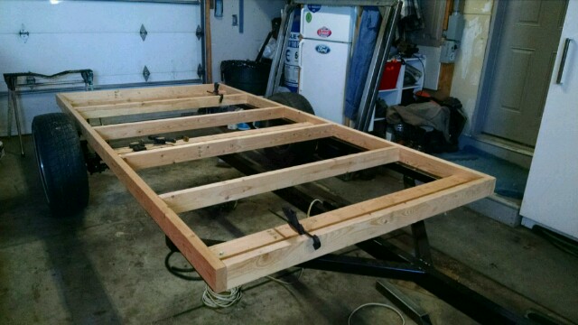

With the holidays over some new work began on the trailer. "flatbed" frame is coming together for registration purposes. This 2x4 frame and 1/2 inch ply decking will be removed after registration and placed on casters to serve as the build work surface for the walls, floor, ext of the trailer.
She's a roller!

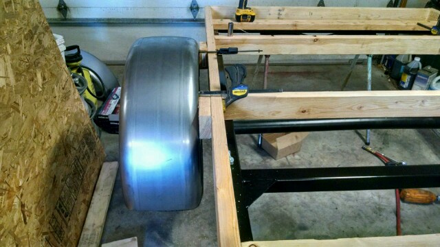

Fenders are offset 1.5 inches because if the massive auto tires I am using. One thing I might change before completion...
2x4 frame for temp trailer deck/ build table

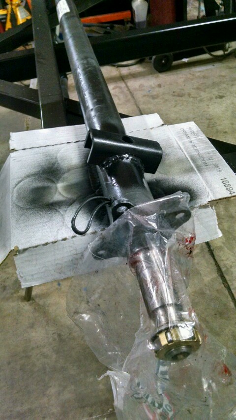

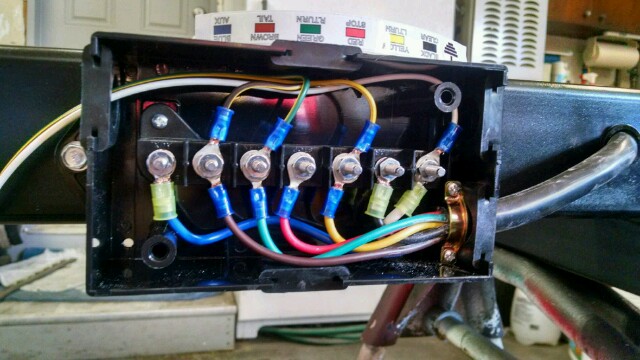

Correct length axle? Check. Mounting brackets welded and painted? Check. Trailer wiring started? Check. Going with a 7 way to have a break line and charge line included from the get go. Will either add a parallel 4 flat to the junction box, or just make an adapter from 7 way to 4 flat to keep with the trailer just in case the trailer needs to be moved and the tow vehicle doesn't have a 7 way. Also, the Outback currently only has a 4 flat, which will eventually be upgraded.
Trailer light junction box
7way plug to junction box just under front of cab
Axle ready to go
yrock87

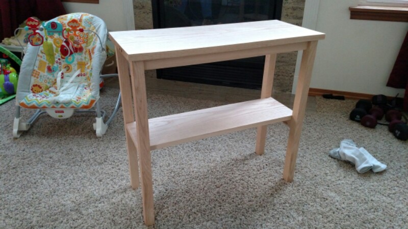

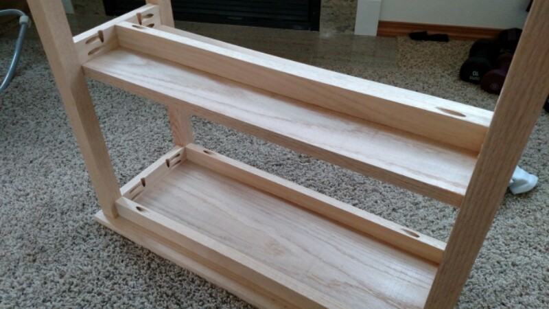

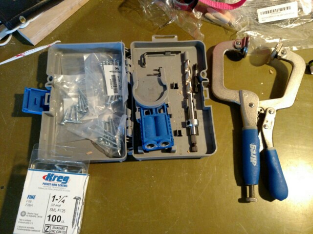

Got some progress finally. Not much mind you, but I at least have some wood cut to size! These photos are the testing of the kreg jig. I made an oak end Table. Need to finish it still of course, but the kreg worked great! Need to ensure I use the correct screw for the right job. Fine vs corse and the right length. Also, got the foam in Stock finally, didn't want to run home for the trailer. So just threw it up top!
All put together. Strong enough for future toddler to stand on! Thanks kreg jig!
Got 12 pieces of 1inx2x8 foam home. Forgot to tape the leading edge. Thumped the whole way when I was over 25mph. Good thing it was only a 2 mile drive...
You can see the excessive use of the kreg jig here

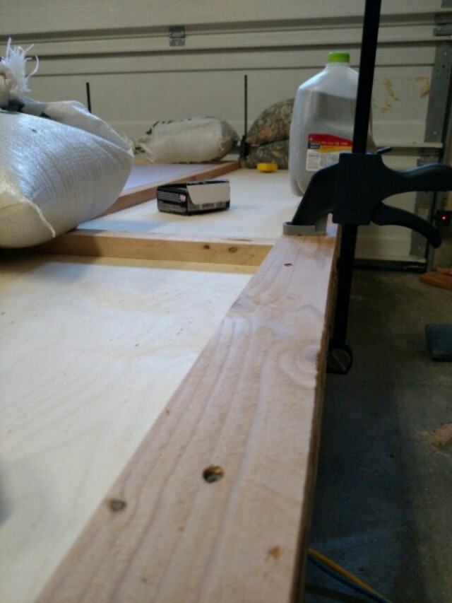

Testing out my sand weights. Need to flatten out some waves that developed in the edges of the ply. It stayed dry but developed some waves whole leaning against the wall.
None of my lumber or ply is perfectly straight or square. Clamping everything in place during a dry fit to try and straiten things out.

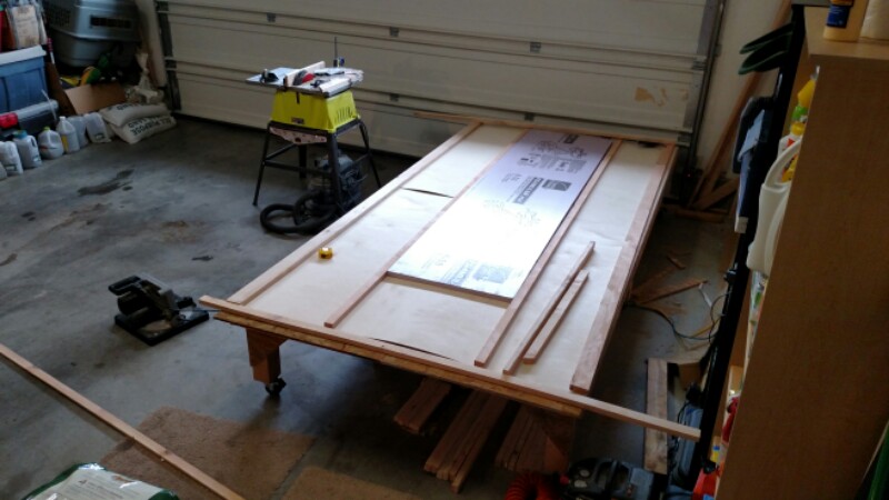

started work a week ago, I will be posting the results of the last week of labor.

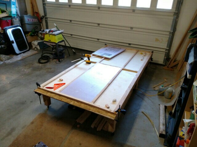

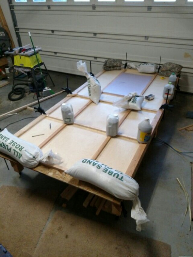

I started off with the floor. I figured it is more forgiving cosmetically with the floor than with the side walls.

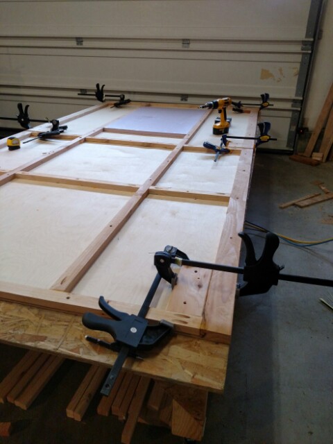

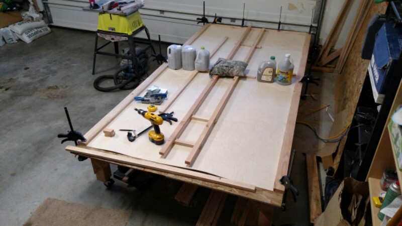

I layed out my two 5x5 sheets onto the work area, along with the four frame members that run from front to back. the two outsides are 2.75 inches wide so that they reach to the outside edge of the floor, and then reach far enough in to rest on the metal trailer frame. I figured I would want some solid wood above the frame to distribute the forces down to the metal frame...
the other two long frame members are 1x1.5 and provide added strength fore-aft. I was concerned that with a butt joint with the ply on both top and bottom at the exact same spot I would be creating a weak spot. these two spars are my insurance to make sure there is not pulling apart or other weakness in the floor. (overbuilding part 1)

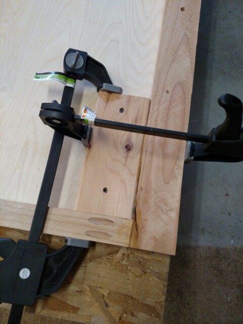

I used the Kreg Jr pocket Jig to attach all the frame members. this thing is great. makes very easy work of joints. after pre drilling and fitting, I glued the joints and then the bottoms of all of the frame members and then clamped and weighted down. I underestimated this portion of the build by a long shot. I only had 10 clamps and 300 lbs of sand. I needed double both of those. I ended up drilling through the frame and ply into the work surface with decking screws just to give myself some compression for the glue to dry. left 20-30 holes in my floor, but I will seal them with epoxy later... at least the glue bonded well.
my biggest hurdle here was that all of my ripped 1x1.5 boards (ripped from 2x6s) started to bend and warp. took some patience and excessive use of tape measure and clamps to keep everything close to square.
Love this Kreg Jr pocket hole jig! makes life easy and provides solid joints.
gotta keep it square, predrilling all the pocket holes
dry fitting the framing and using the foam to get an idea of placement without having to cut down every piece of foam later.

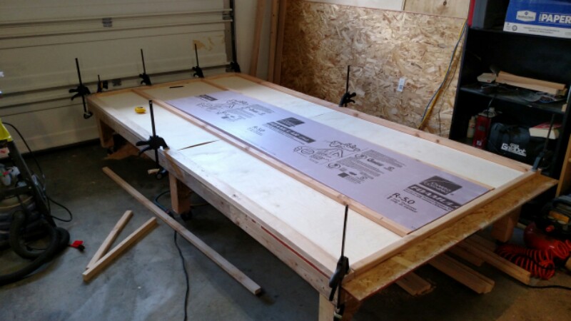

Postby yrock87 » Thu Apr 28, 2016 10:42 am
after an afternoon of drilling, glueing, clamping and lifting sand bags, I was hungry... pre made homemade pizza for a week!! should last me till the wife and daughter get back. :-)
home made pizza break!
screwed down as well
weighted down and clamped

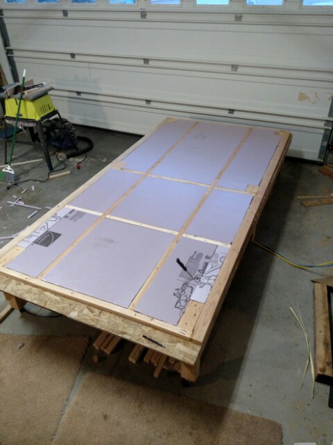

Re: as of yet unnammed 5x10 Benroy in the PNW

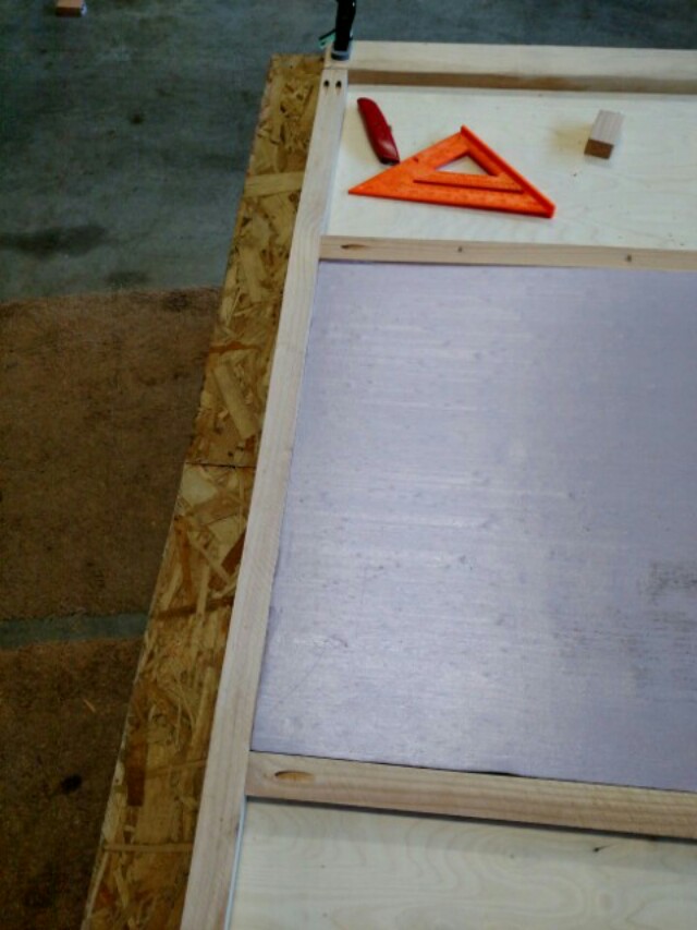

Postby yrock87 » Thu Apr 28, 2016 11:01 am

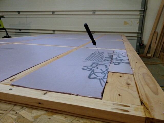

dry fit all the 1 inch foam into the floor. used a steak knife after the box cutter gave less than ideal results. since then have purchased a bulk set of fresh blades. keep the box cutter blades fresh and it will treat you right! also, I figured out that I should err on the side of slightly to small opposed to too big. going back and cutting a 1/4 inch on every piece of foam is messy, slow and a pain in the butt. I figured 1/8 inch gap on each side between the foam and wood framing is not going to affect the overall strength much and makes installing MUCH easier.
used a trusty steak knife. since then I got fresh box cutter blades and those seem to work better.
1 inch foam is all dry fit
