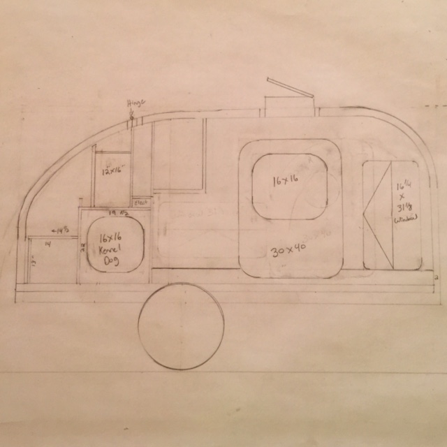

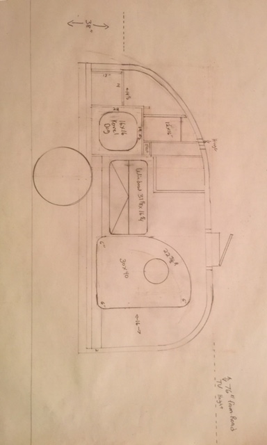

please check over my hand drawing the profile is more less the generic benroy but i change the proportions for a 5 x 10 x 56.5 tall, please point out anything that should or could be changed
Thanks Bill

Postby KCStudly » Thu Jan 21, 2016 11:45 pm
Per your request, here are my thoughts. Hopefully you have already considered this stuff, but if you haven't maybe you will find something helpful.
It is always cool to see someone, such as your self, who develops a special or uncommon feature (like your kennel) to suit a particular need. I'm thinking that this arrangement could also be good for people who want a better storage space for ez-up canopies and bag chairs, etc. If the dog doesn't need the full width of the camper, have you given thought to a camping equipment locker on the opposite side? Probably won't be able to fit a canopy, but maybe chairs(?).
The side door looks to be a touch far forward; I would use a slightly smaller window and move the door back a bit. Sit and spin; you want your arse to land about where it will be when you are laying down.
The radius on the top rear corner of the door looks a little large to my eye. I would rather have the shoulder and head room, or at least have the door be more symmetrical. Maybe it's just me, but I think some of the curvy door profiles people come up with compete with the overall profiles more than they compliment.
Will your dog be able to climb in by itself, or will you need to assist it? If the later, I assume you have a reasonably sized dog. I suppose you could make a pet ramp up the back of the fender and I assume that the fender does not interfere with the doggy door.
How is the kennel ventilated and will you be able to monitor and/or communicate with the dog from the cabin? Even for a working dog (hunting, right?) you are going to want to be able to keep tabs on them.

KCStudly wrote:Per your request, here are my thoughts. Hopefully you have already considered this stuff, but if you haven't maybe you will find something helpful.
I seem to recall you mentioning in another thread that the kennel is just a sleeping arrangement for your hunting dog, not for travel.
As for the dog kennel there will be one on each side, but i could use them for storage when the dogs are not with, ventilation there will be 4 dc computer fans two per side with vents in the door pulling fresh air thru the kennel I have this set up on a homebuilt two dog kennel that I use in my van and works really well, I plan on installing windows inside the cabin to be able to see the dog in the kennel from inside the trailer maybe wiley windows? I will probable have to give them a little help to get into the kennel but that normal there use to that.
The door is 16" from the head of the bed I thought that was a good rule of thumb, no? I will take another look at the door, as for the window I bought 4 windows on a craiglist roadtrip gone bad if I don't use two of them some where I will still have four in the pile

Postby KCStudly » Fri Jan 22, 2016 2:00 pm
Should have known that you would have the dog stuff all figured out, but felt compelled to check in.
On the windows, don't let a small mistake turn into a big one. You would be better off putting the door in the comfortable spot, reselling the "too big" windows and scoring others that suit the preferred door location.
My original hand drawn concept sketch for TPCE had extra windows in the side walls behind the doors, too. But when I did the scale 3D model they didn't make sense anymore. They compete for space with the cabinets and you can't look out of them unless you touch your nose to your knees anyway. I settled for a positive vent system (still in progress) using a 5 inch case fan pulling cool air from under the cabin behind the bulkhead and blowing it forward into the cabin at our feet. Between that, the door windows and the Maxxair shrouded roof vent, I think we'll be fine.
To me, if you want to be able to look out or have fresh air at your face, a couple of small screened vent windows near your pillows makes more sense. A couple of plain roof style screened vents would be pretty thrifty if you don't mind them sticking out on the side walls.

Postby vincigj » Fri Jan 22, 2016 2:21 pm
It's nice to look out the door window laying down however as others stated it would be nice if I could pivot out the door instead of scooting up first to get out my door. Yes my door is 16" back. If one reads further along the corrected profile shows leading edge of door starting at 22". MHO

Postby ibbowhunting » Fri Jan 22, 2016 6:19 pm
ok moved that door and reshaped it and drew the window in front of the door you could easlily see out that while laying down,right? whats your gays and gals input now? any and all input is greatly appreciated :applause:

Postby KCStudly » Fri Jan 22, 2016 7:40 pm
The proportions look much better with the door now. It looks like you will have plenty of clearance for your fenders, and I'm sure you will be much more comfortable getting in and out.
One thing to look out for if turning your existing window sideways is the orientation of the factory weep holes, if present. At least one builder reported having water leak in when he turned his windows from their intended orientation. IIRC it was an easy fix; just seal the old weep holes with some sealant and drill a couple more at the new low point, being careful to match the factory location and angle relative to the extrusion ring.
