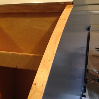

In another thread it was discussed how the generic benroy plans show cutting the rear hatch area down 3/8". Several saying thats to much. So yes, I was disturbed.
Until I realized that it allowed me to cap the raw edge with a piece of birch to hide all of the plys.making it cleaner.
Black drip caps it is.

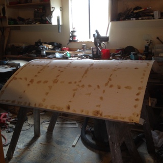

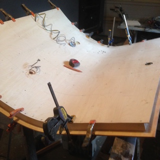

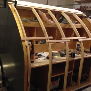

Postby fourbtgait » Wed Feb 10, 2016 12:04 am
Hatch framed, glued, screwed, resting in place to dry.
Finally.....
Tomorrow before yoga starts will be cross framing it.
Remove from hole, add screws to outer spars then abb a 1/4" birch to each outer spar for a clean finish, making them 1" thick.
Inside skin 1/8", outer is 2 layers 1/8" and 6 oz glass.
Need to finalize gas struts for any needed inside blocking, have the t-bar latch system to set up.

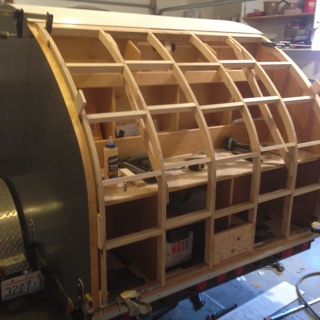

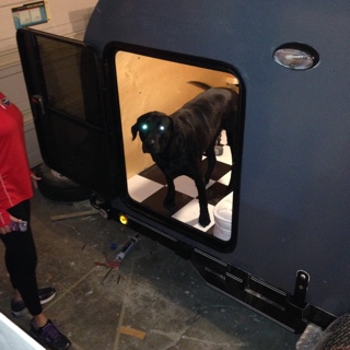

Postby fourbtgait » Fri Feb 12, 2016 11:23 pm
Rear hatch.

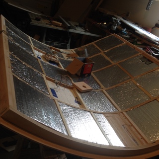

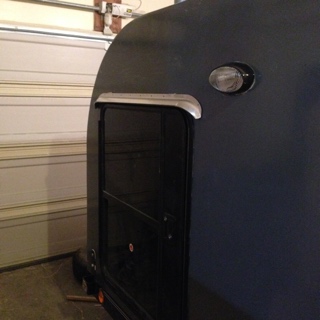

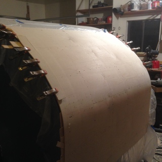

Postby fourbtgait » Mon Feb 15, 2016 8:09 pm
A good weeken. Hatch skinned in and out, wired, insulated, layer of glass on the outside.
In regards to the hurricane hinge, what size, spacing of screws do you like?
Just screws in the top or also some in the sides?
1/2" extra each end?
