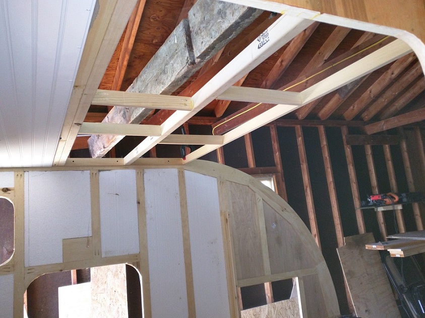

Postby terryutica » Sun Apr 24, 2016 8:44 am

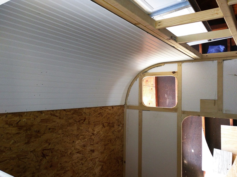

first 1/2 of ceiling up.

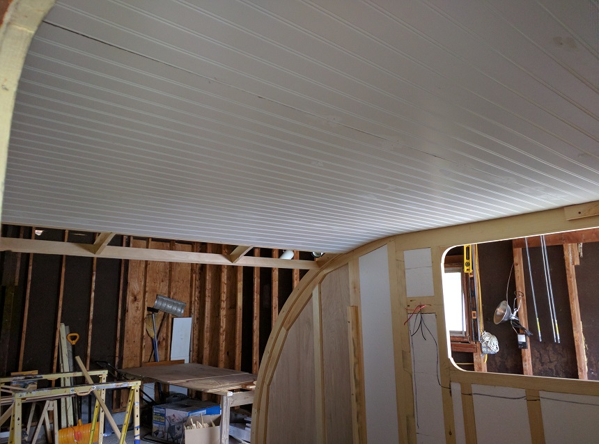

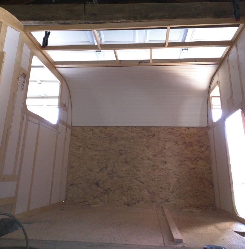

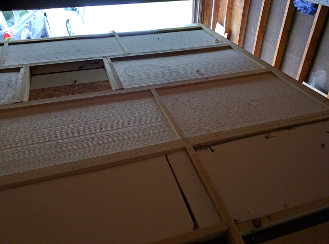

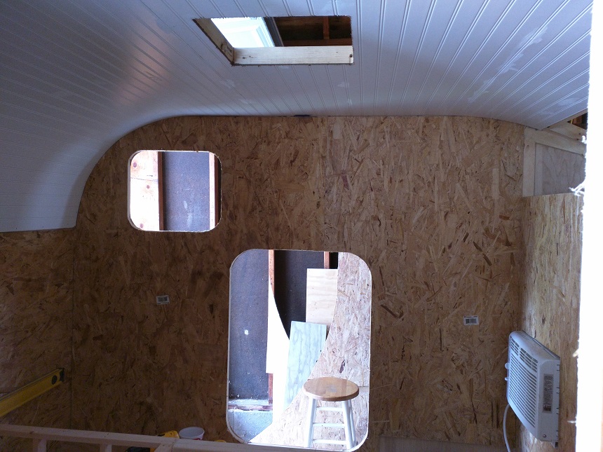

Postby terryutica » Sat Jul 02, 2016 4:01 am

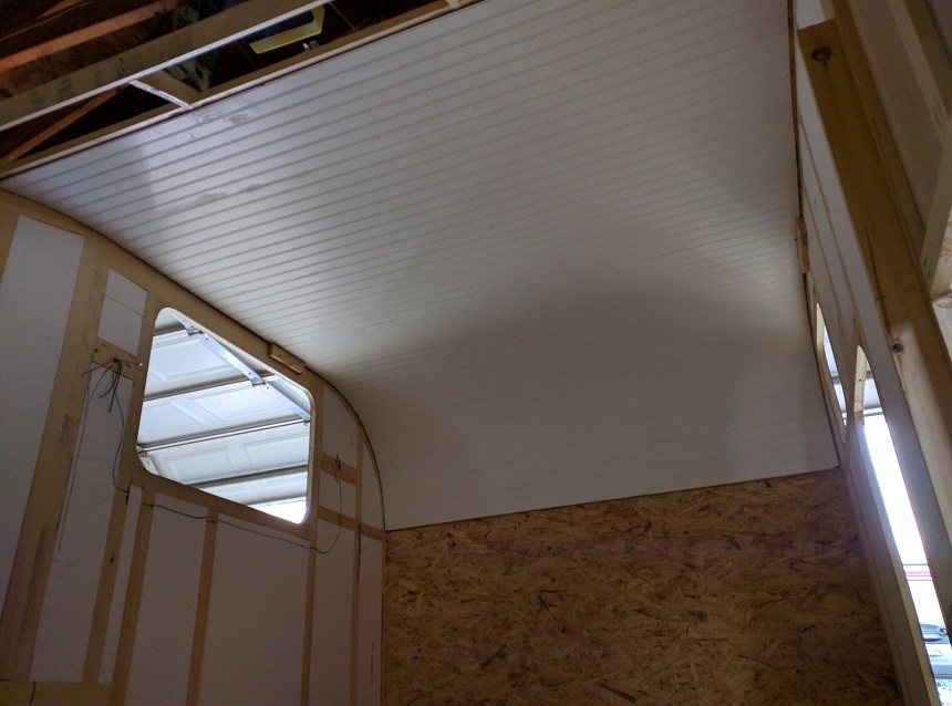

ceiling coming along.

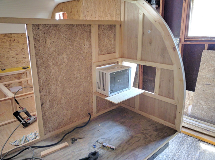

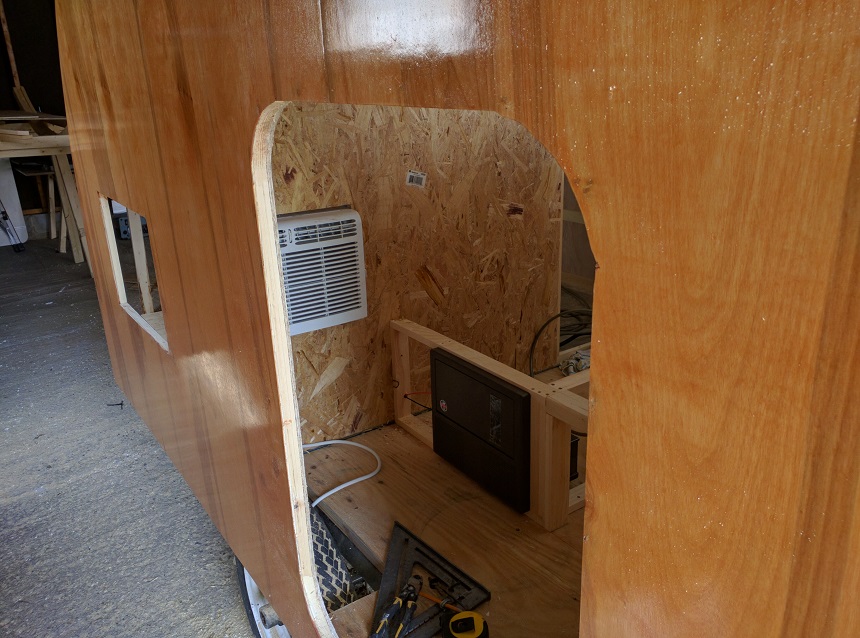

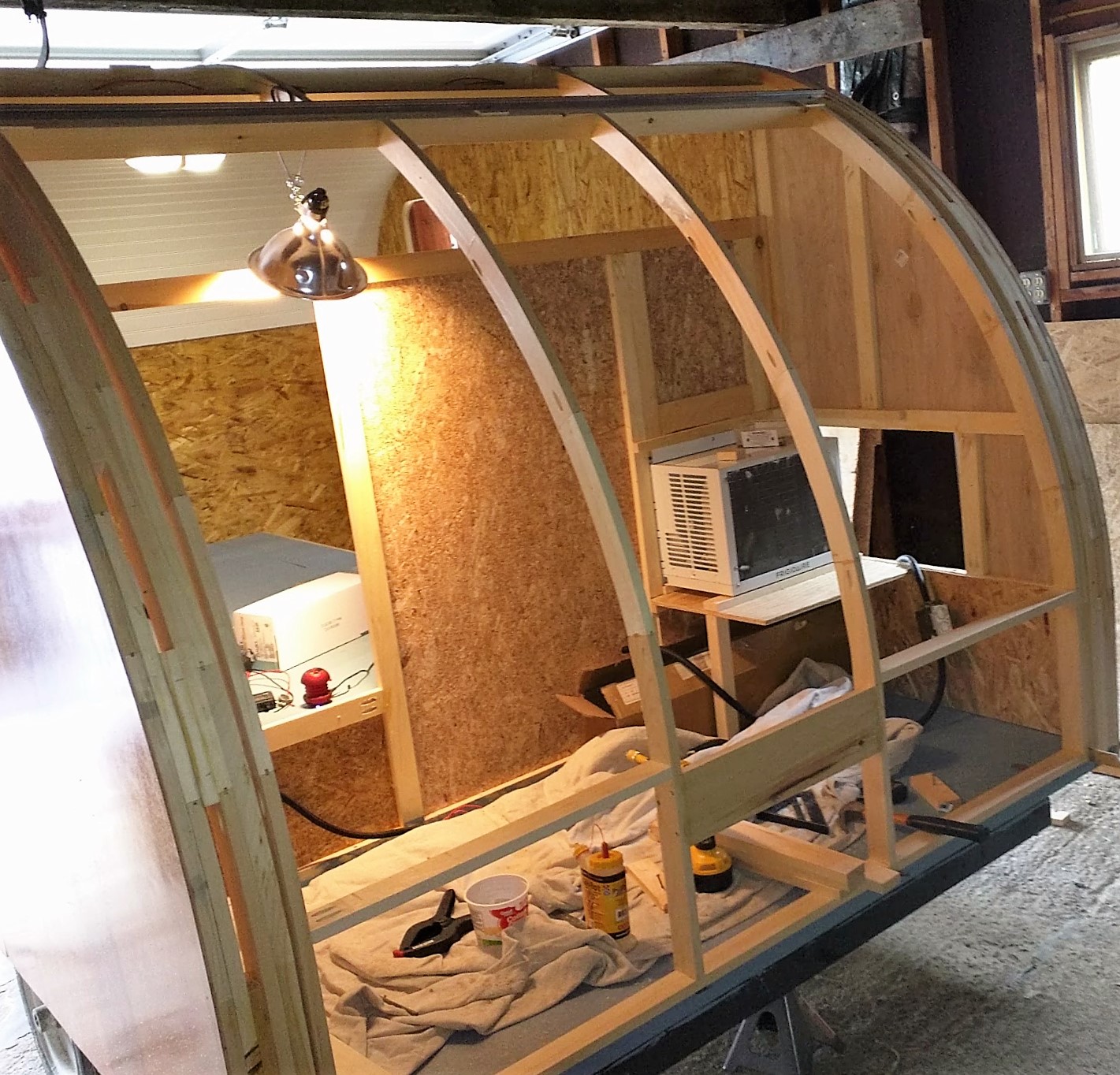

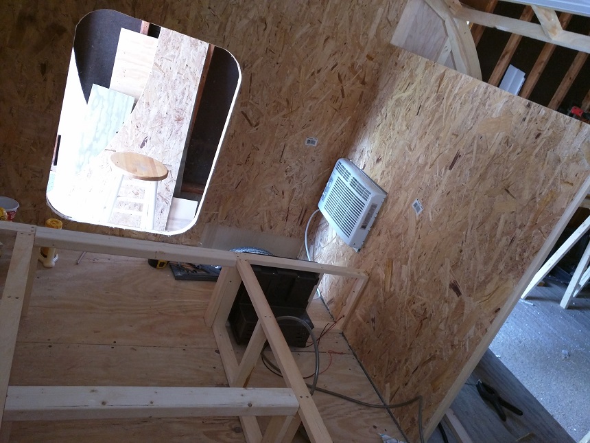

Postby terryutica » Sat Jul 02, 2016 4:11 am

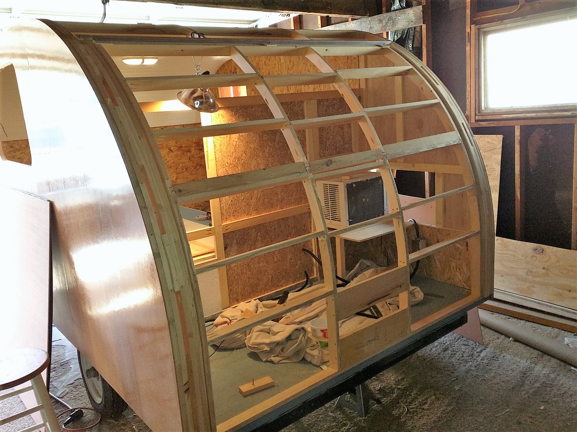

rear bulkhead. large shelf will be on top to close off the rest.

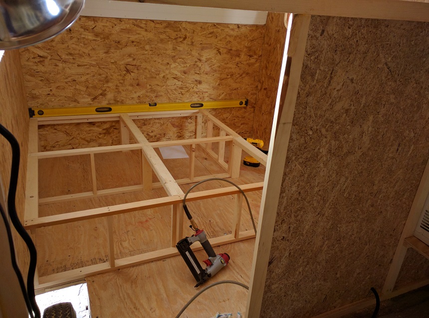

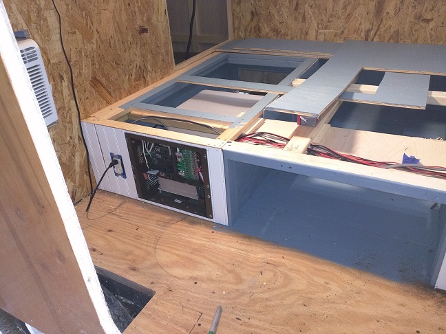

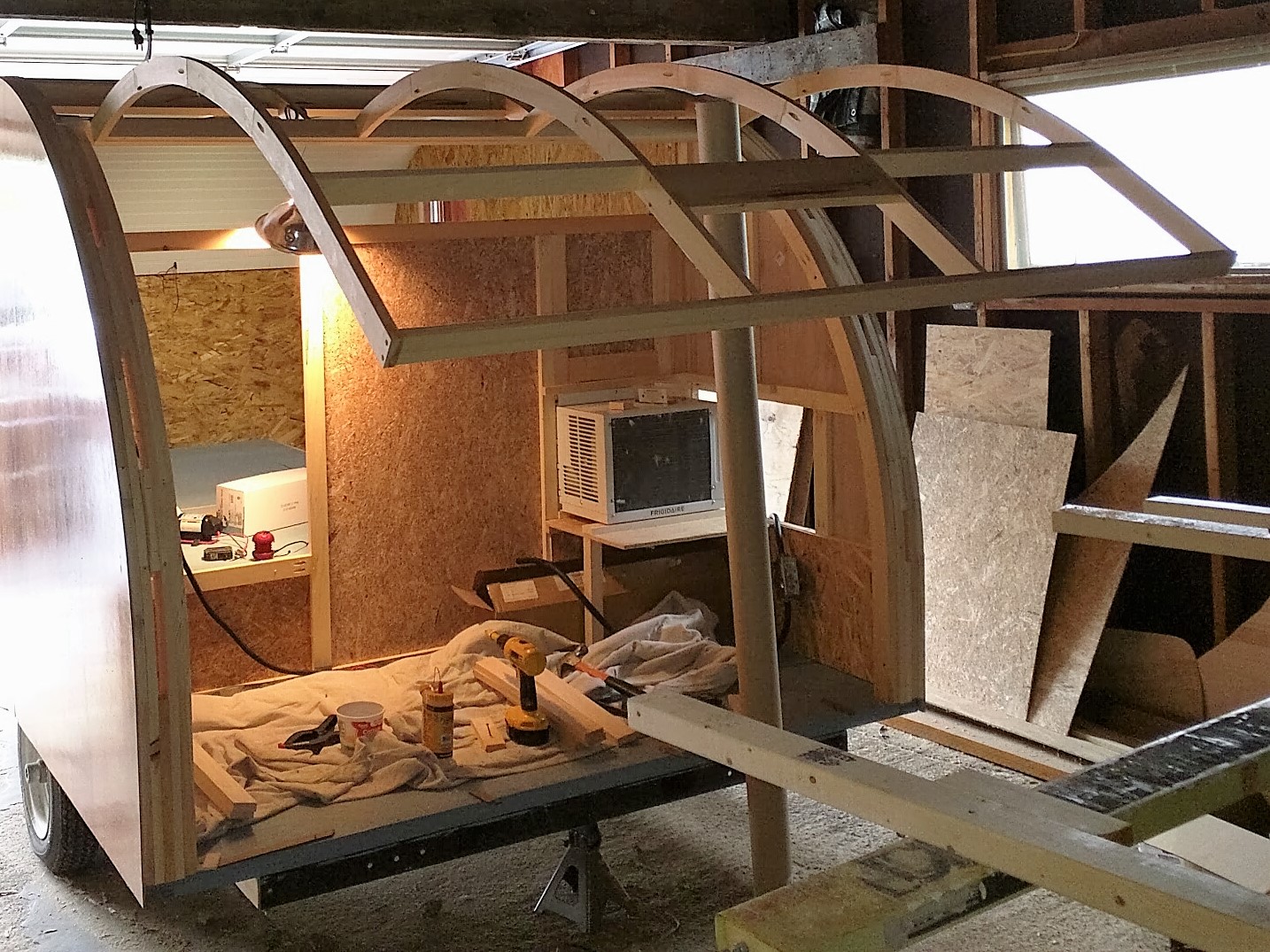

Postby terryutica » Sat Jul 02, 2016 4:20 am

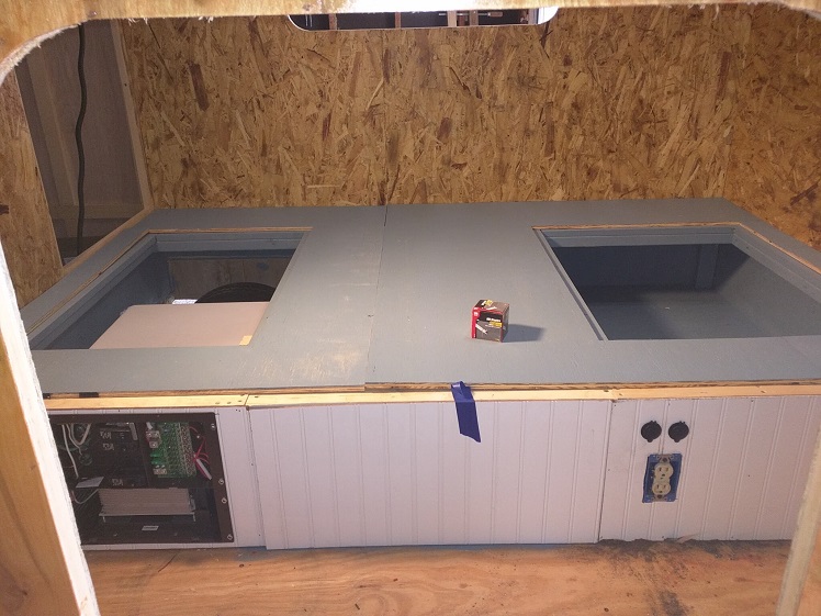

bed frame and the start of the wiring. Center section of bed fACE will be hinged.

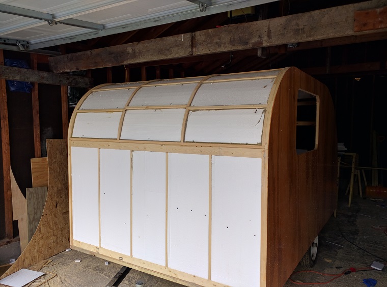

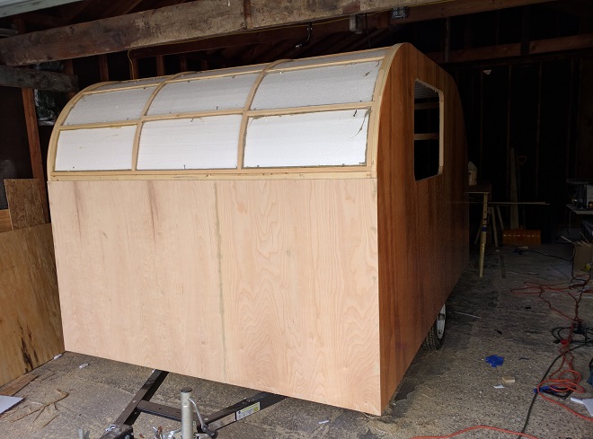

Postby terryutica » Sat Jul 02, 2016 4:32 am
insulted and ready for sheathing. 2 layers of 3/4 insulation .

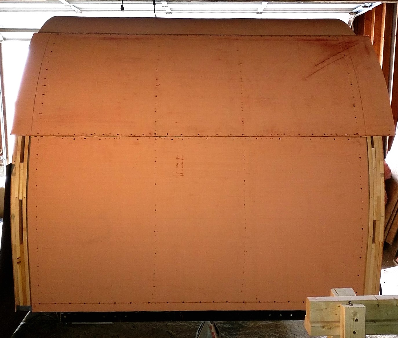

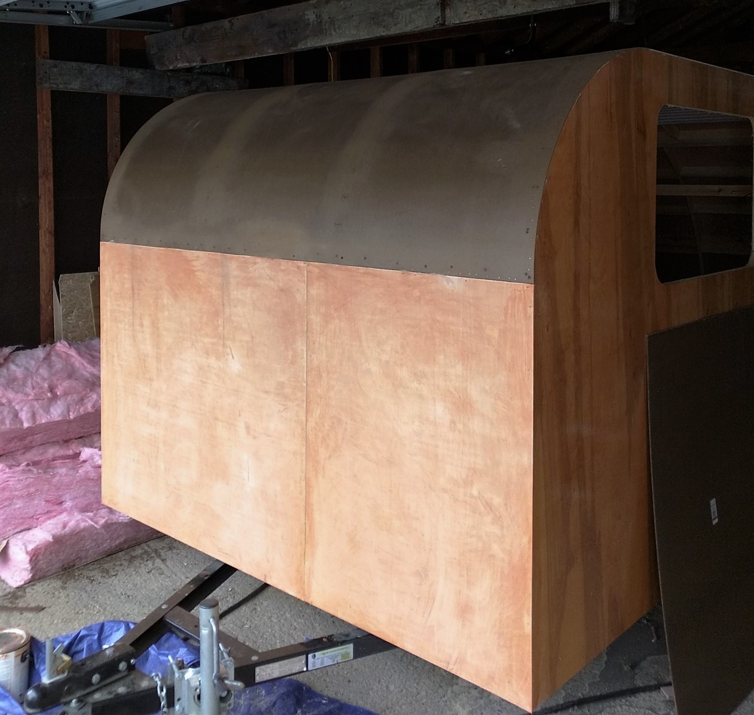

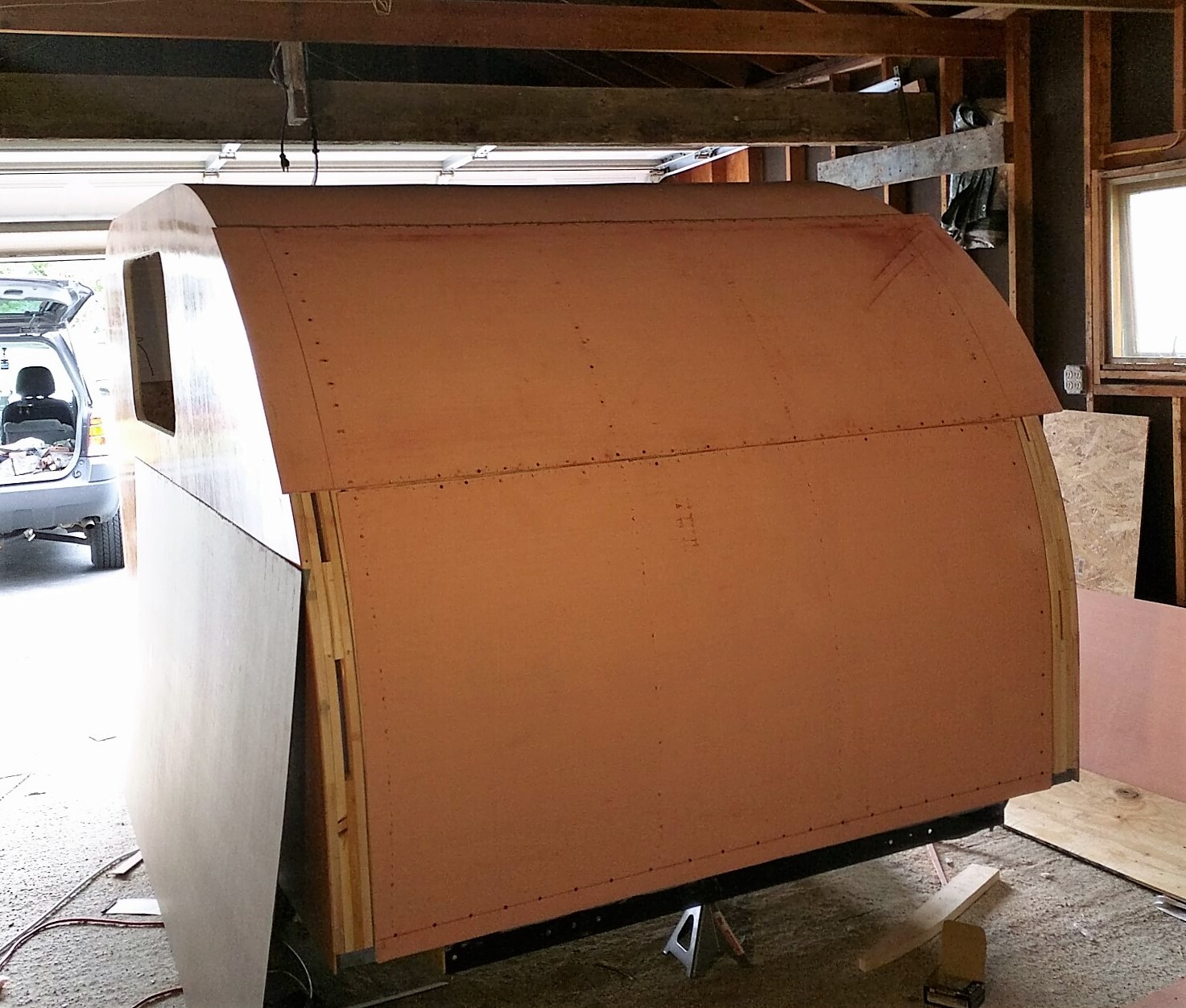

Postby terryutica » Sat Jul 02, 2016 5:04 am
sheathing on ready for paint. Restained the front and it looks a lot better. ended up using hardboard on the front radius HD was out of the 1/8 ply i was planning on using. will see how it lasts was nice to work with.
Have springback on the hatch planning on putting cables and turnbuckles in. might replace it next winter want to get it on the road before the summer is over.

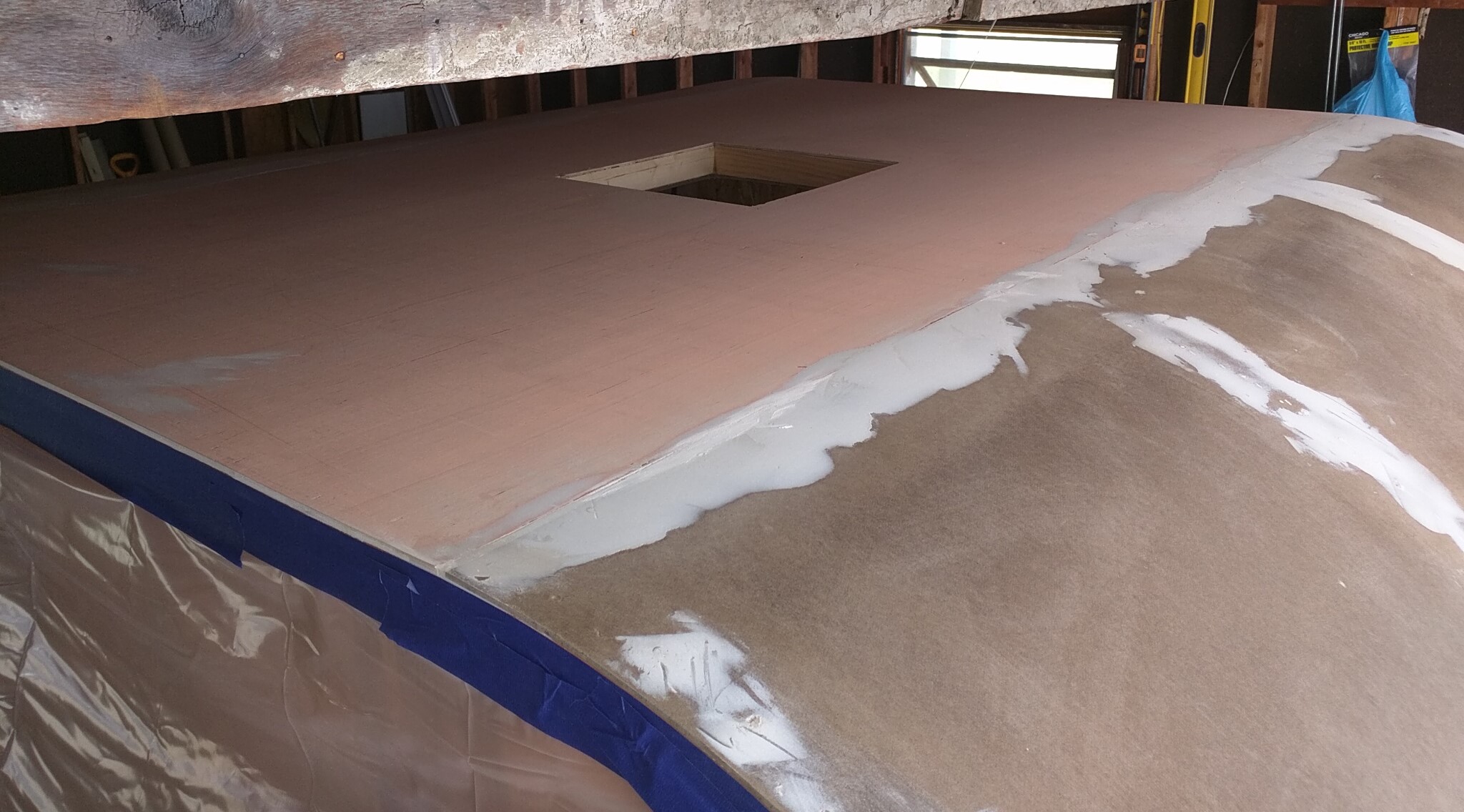

Postby terryutica » Sat Jul 02, 2016 5:10 am

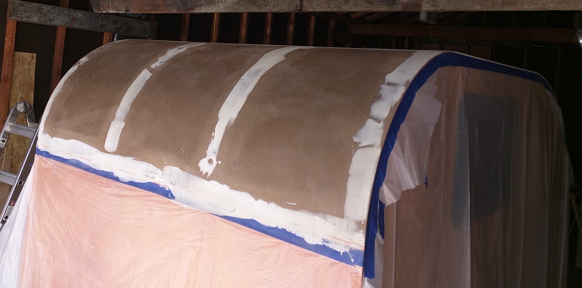

screw holes and seams filled .

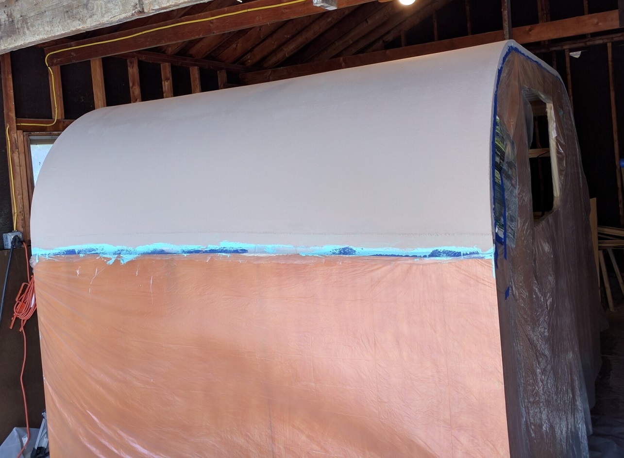

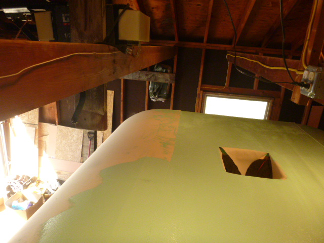

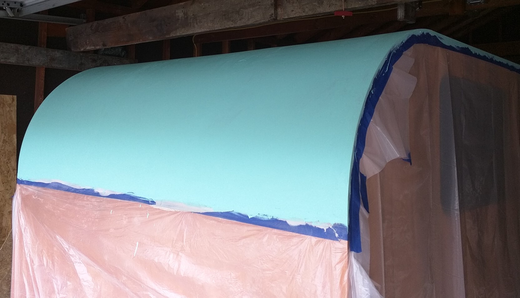

Postby terryutica » Sat Jul 02, 2016 5:16 am
first coat of paint on. using oops paint even found a light tan as my final color. Have canvas all cut . will try to get that on Monday.

Postby KCStudly » Sat Jul 02, 2016 5:58 pm
The work you are doing looks good. :thumbsup:
Re: PMF hints, I'm a little surprised that you painted the wood/board first. You may want to seriously think about roughing the paint up good before trying to glue the canvas on. The TB2 sticks best to raw wood.
Re: The T-Beck? Don't know what else to call it.
Postby terryutica » Sat Jul 02, 2016 8:11 pm
Thanks KC.
Actually I'm going old school and using paint to glue the canvas on. Terry

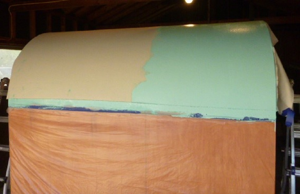

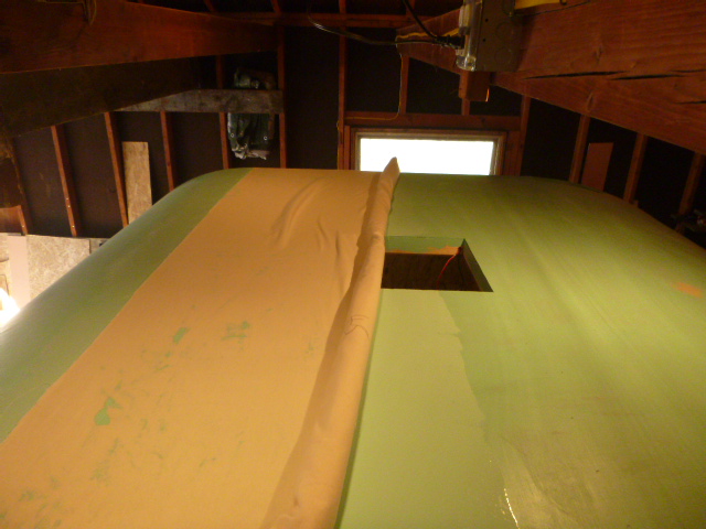

Postby terryutica » Mon Jul 04, 2016 8:30 am
half the roof on

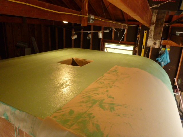

Postby terryutica » Thu Jul 28, 2016 5:45 am

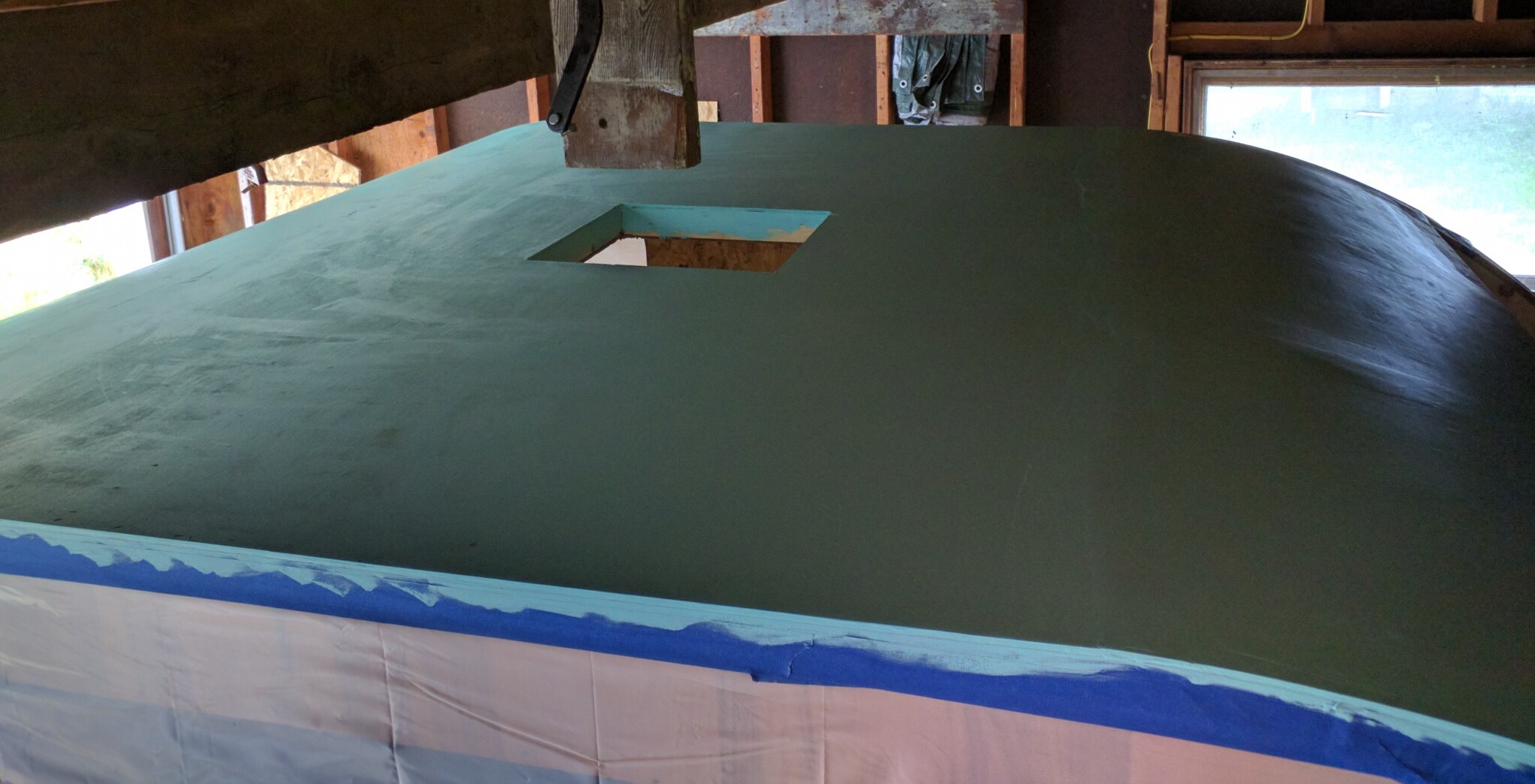

roof painted
