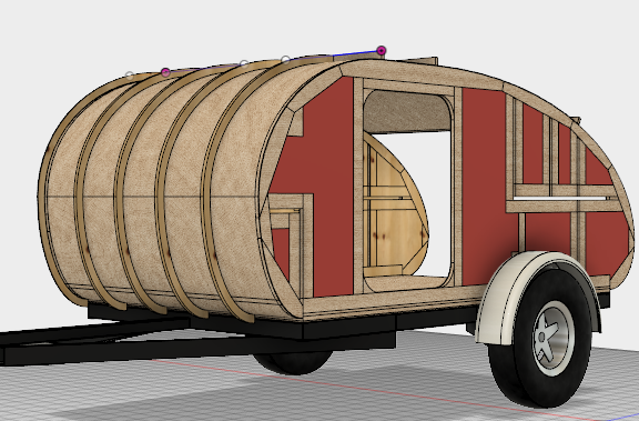

Postby MIB66 » Tue Mar 15, 2016 4:43 pm
Here is is with 3/4 ply ribs on 8.5" centers.
Front ribs.png (96.41 KiB) Viewed 3411 times

Postby KCStudly » Tue Mar 15, 2016 7:29 pm
Seeing it that way on your long arched front, compared to my high and tight front radius, makes it look like a lot more work and a lot more wood with little to no advantage. Sorry if I sent you down a rabbit hole, but for your profile I would just use regular spars. :roll:

Postby MIB66 » Tue Mar 15, 2016 8:28 pm
Thankfully that was only about 15 min worth of effort. In some way the ribs are preferable to spars in the nose area. I would probably have to hand plane the spars to shape one at a time for a good roof to side fit. I'll already have a template made for the ribs as I need it for the roof edge. Would you fasten the wigglewood down, or just glue? I'll probably do the multiple ribs for the hatch too. I could do 4 ribs at 12" centers too if you think that would be enough support.

Postby KCStudly » Tue Mar 15, 2016 9:23 pm
I used screws with small temporary plywood washers (about 2x2 cut from scraps of the same 5mm ply I used for my ceiling skin) and glue.
The washers prevent the screws from pulling thru, spread the load, and also keep the screw from sinking in fully. This allowed me to do several dry fits and train the ply a bit w/o wallowing out the holes in the thin-ish ply. After it cured and I pulled the wooden washers off, I chose to put the screws back in (some people like to leave them out for weight savings and to avoid rust staining later... I used SS). The fact that the screws went a little deeper on the final seating meant that they grabbed a little better than if I had driven them all the way each time.
If you decide to go with the front ribs, why not just two with spars let in? Note that I lined my riblets up with my cabinet face frame stiles.
Don't forget that there are plenty of successful campers with similar profiles to yours that got by just fine w/o these extra ribs.

Postby MIB66 » Wed Mar 16, 2016 5:46 am
This looks a little better:
front ribs.png (251.76 KiB) Viewed 3345 times
