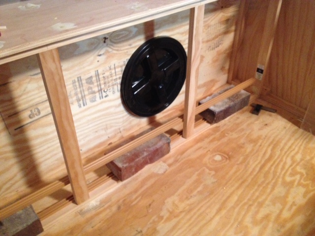

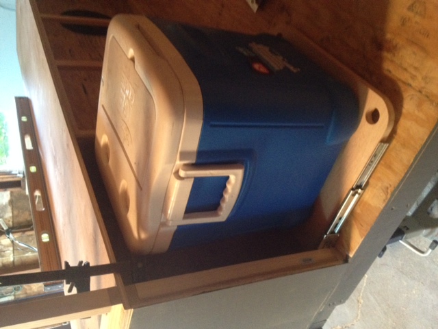

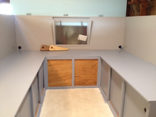

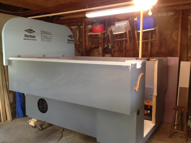

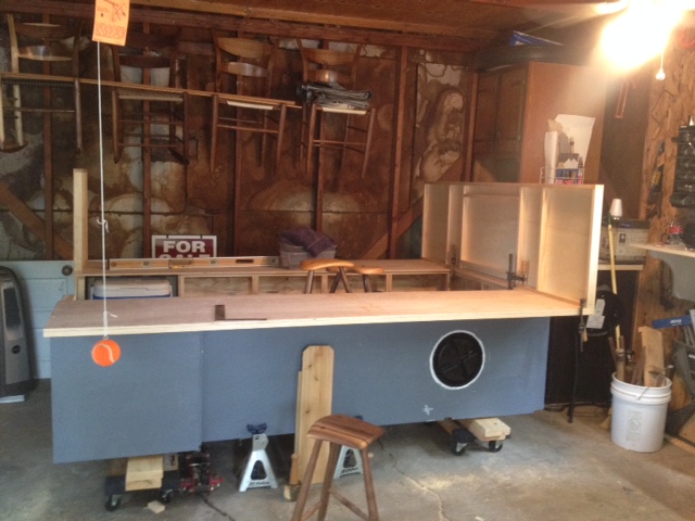

I have made some progress since the last post. The wing extensions are on and the front wall is built. I am working on the rear walls (by the tailgate). I plan to build a wiley window in the front wall to give me some rear view abilities. Tomorrow I will build the other side of the rear wall and begin to add insulation. My goal for this weekend is to complete most of the lower section build, and then do the finish work in the evenings after work. Got a bunch of work travel coming up over the net couple of weeks so progress will be slow. That's good because I have no idea how to build the foam upper section or how to lift and lower it once built....help
In these pics you will see I got the camper off the trailer and onto some ghetto dollies. I guess being from Nebraska it should be red neck dollies. They are harbor freight furniture dollies (4 of them). I paired them up with 2 2X6's. I also built a sliding cooler drawer type thing.

Postby rodtermaat » Fri Aug 12, 2016 2:35 pm
A lot of progress has been made since my last post.

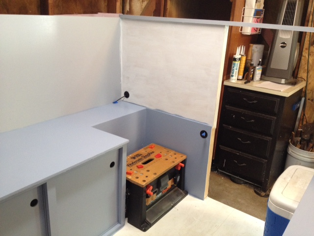

The lower half is getting close to finished - at least the core. The sides are up and some insulation has been installed. The basic wiring is in for both 120 and 12v. I ended up having to add a top brace over the door as it was 1" wider in the back than in the front of the camper. I was able to move it to within 1/4". This will make entering the camper a pain with such a short door, but I could not determine how to correct the deviation. Essentially, I was out of square on the right hand side of the door as the camper was flexing outward. The electric actuators should be at home today after work and I will be working on the figuring out the mechanics of a hardside lifting top section. I decided to work out the mechanics before building the top - not something I am famous for....

First I wired the 12 volt system using some diagrams and forum posts and the zero skill that I possess. Amazingly all of the various outlets and fuses appear to work.
I have a 6 fuse box that is wired as
1. Battery voltage meter
2. USB ports (x2)
3. Cig ports (x2)
4. Actuators
5. Future vent fan
6. Future dome light or?
7. Should have order the 12 bank model - grrr.
Next I installed the actuators and wired that little gem. Essentially there is 1 line from the battery to the switch and then the switch is daisy chained to each actuator around the camper. I decided to forgo the remote control wiring until a later date and my brain would not process the extra wire schematics.

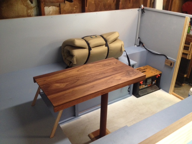

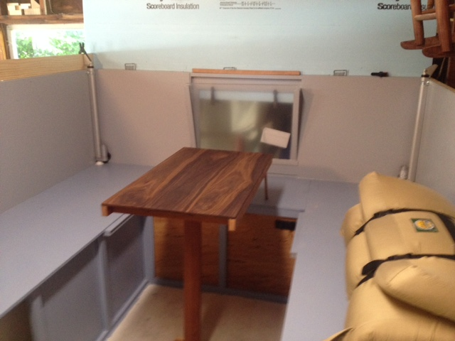

Finally, I built a collapsible table out of some scrap walnut and cherry I had in the shop. It still needs some work to increase the stability when deployed. In the stowed position it builds out more the sleeping area making it full width to almost our hips. Not sure if we plan to widen the leg portion - probably do a test run or 2 before decisions are made.
Believe it or not that finishes the lower half for now. Of course there is always some fiddling to do, but I plan to keep it open until we start using it and determine what works for us and what needs changing.

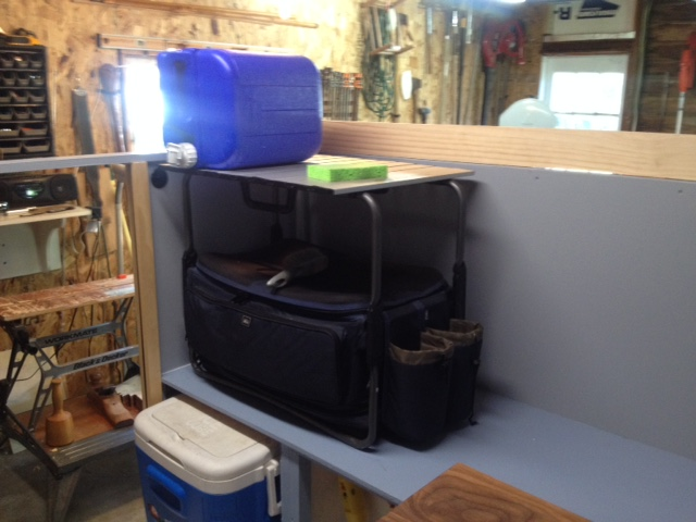

Here is what we expect to use for the mess kit for now. Just the cooler and the REI food thing. I do not see it as a long term solution, but will as least get us out there.

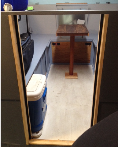

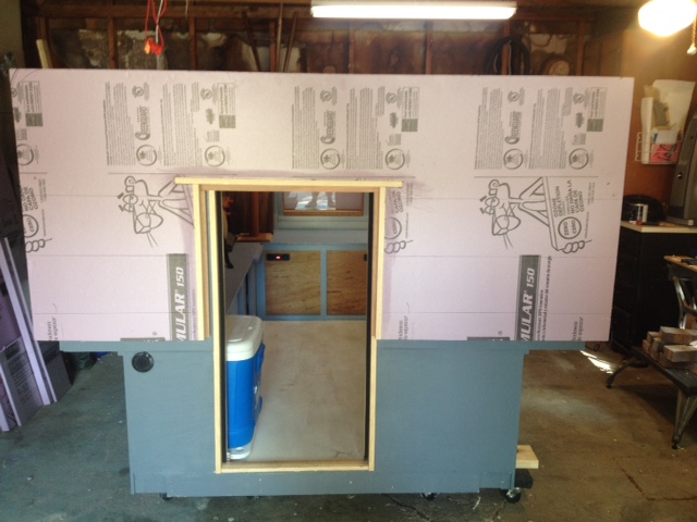

Here is the door frame under way. Finally decided to just build this out like my house exterior door since it will be 80% covered when the camper is down for traveling. I built the threshold out of some scrap cherry and the frame and stops in pine. Need to build out the door next.
nebraska rod

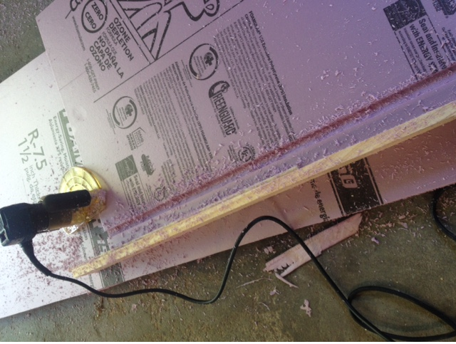

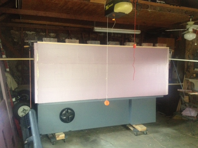

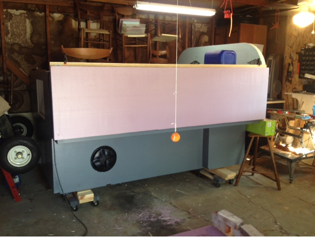

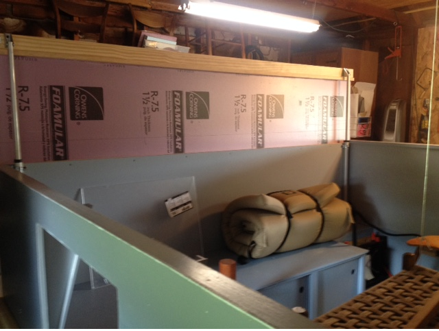

Working on the upper half now. I first started with routing a channel in the side panels that will attach to the actuators and well as provided the seal when the top half is lowered for travel, stealth, and poor weather.

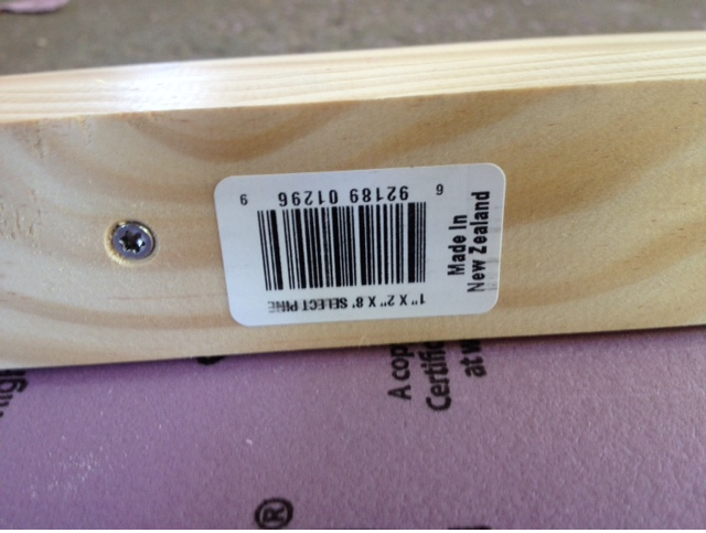

My personal commentary on what a sad state of affairs it is that somehow it is more economical to ship wood from New Zealand to Nebraska than somewhere more local.

Postby rodtermaat » Tue Aug 30, 2016 4:20 pm
I next mounted the side panels to the actuators and tested that they moved up and down as expected. Success and a #%$@ moment. Now I have to actually figure out the whole roof thing.

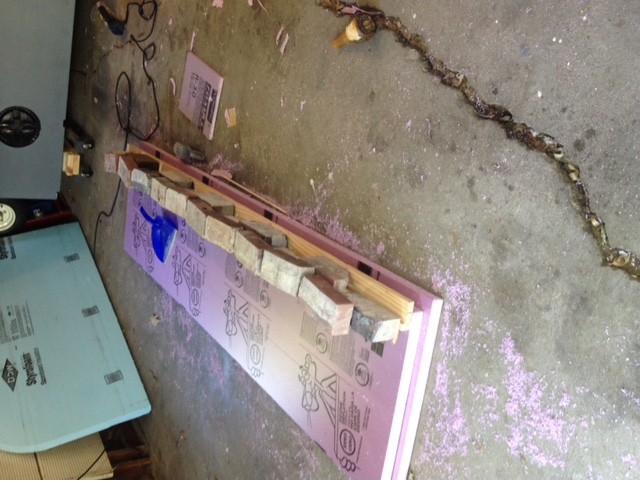

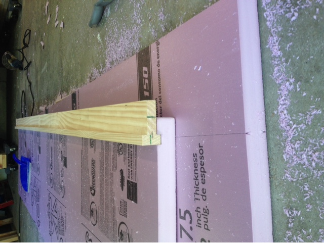

Postby rodtermaat » Tue Aug 30, 2016 4:27 pm

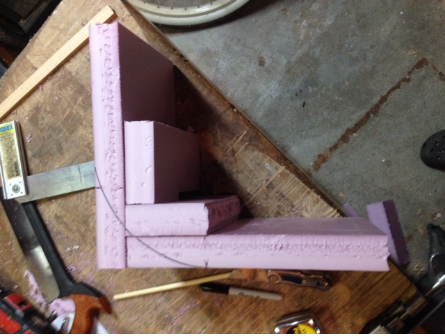

Well it's not going to build itself. Therefore I started with some profiles.
This one would be impossible for me to do given my tools and talent. Non starter.
This one looks like a winner? This should ensure a solid connection?

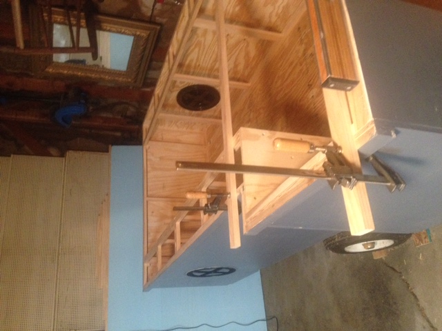

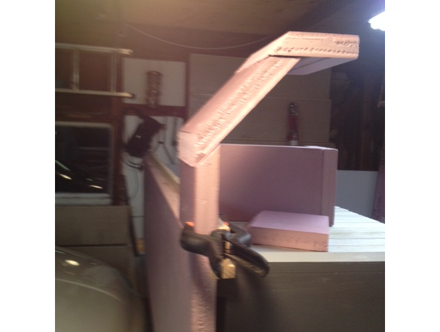

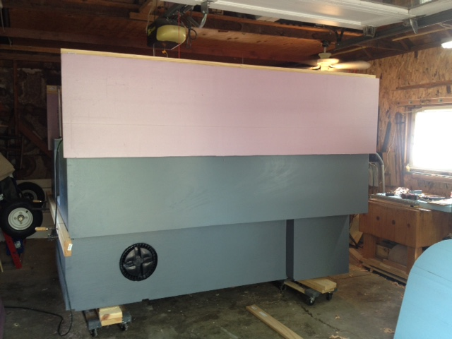

Not a ton of progress the last couple of weeks. Work and class are firing up at the same time which leaves little time for camper building. Anyway I managed to get the rest of the sides on the camper, and with some creative clamping the ends went only a little fuse.
Here is a pic of the upper door framing. I am pretty sure this is going to be a lift up, making a small awning, and not an upper door like the real Alaskan.
