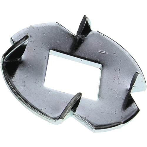

I don't think those bolts you showed are appropriate. The heads are relatively small and the countersunk head will only wedge the wood apart.
Elevator bolts or plain hex head with flat washers would be better.

[quote="KCStudly"]I don't think those bolts you showed are appropriate. The heads are relatively small and the countersunk head will only wedge the wood apart.
As a matter of fact I used a torque washer with a carriage bolt and almost the same result. The deck is already cut and in the dumpster. New framed deck is halfway finished.

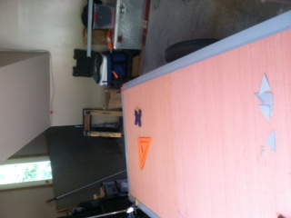

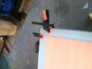

Here is a pic of the deck. It was made from 2x2 framing and 2 inch foam sandwiched with 1/2 ply on the bottom and 1/4 on top. I am a big guy and was leery about using 1/4 inch but with the foam in between it is strong. All of the edges were wrapped in fiberglass and epoxy. Crack filler was rolled on the edges and bottom. A PVC deck ledger was used as a frame.

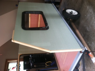

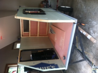

Postby greygoos » Thu Aug 18, 2016 4:35 pm
I decided to do a dry fit just to convince myself I was making some sort of progress. I am happy so far. Now I get to tear all it all down and do the filling, sanding and covering. I dont know why my pictures keep coming out sideways. I am open for suggestions.
