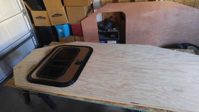

Picked up some 1/2" 4x10 pieces for my outer sidewalls yesterday. Since it is going to be a "Woody" wanted some better grain for the outside. Thought I picked out some better pieces but have some oval patches. They actually look pretty cool with the stain but may look a little weird on the end product, if I hate it I will just paint.

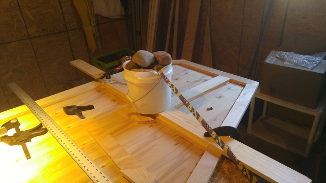

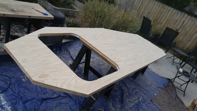

Got my deck plywood cut and covered in Henry's
After attaching the deck I found that my side cuts were not so true so I decided to get some trim, or what is actually roof flashing
Filled the deck bolt holes with wood filler
Closeup of the flashing
All sanded up, decided just having the trim on the sides looked weird so went and picked some more up at my favorite place HD.
Attached my cleats to the deck....split the ends a little bit when drilling into the metal flashing so glued them up and clamped.
Alas, had something to secure my sidewall too! Used to some clamps to finally get an idea of how it will look. (that is actually going to be an interior wall it was just the easiest to move off my horses at the time)
After the cleats were both installed I primed the deck and installed 12x12 vinyl peel and stick.

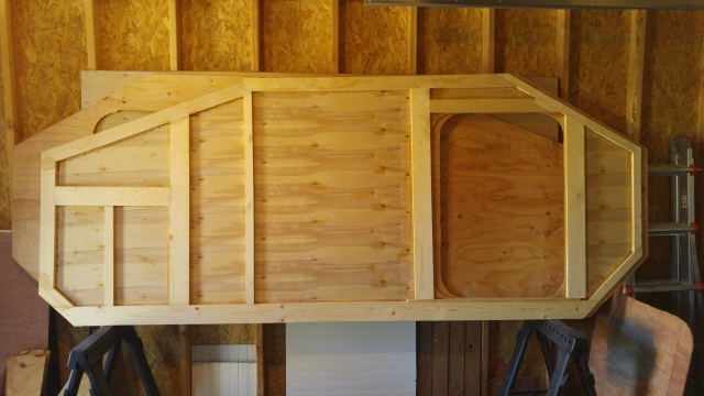

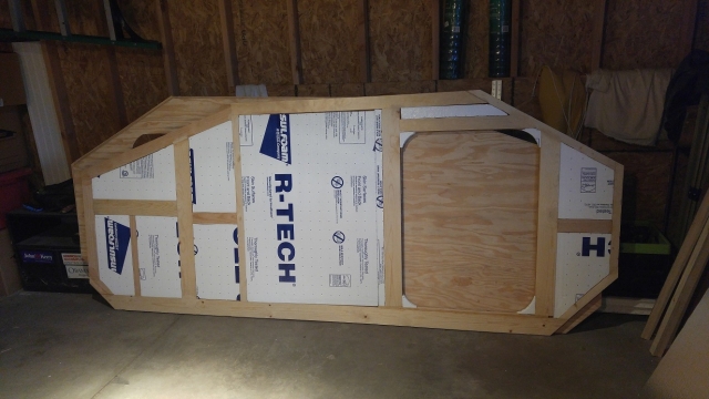

Finishing up the sidewall framing
All framed up (a couple more cross members added later)

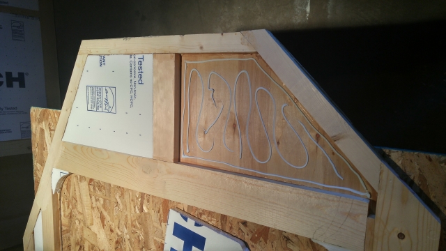

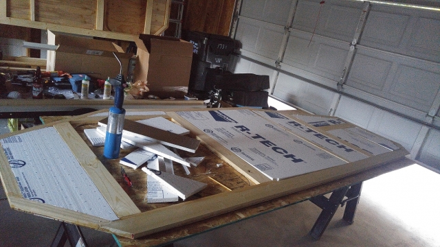

Blow torch and a box cutter to cut the foam insulation

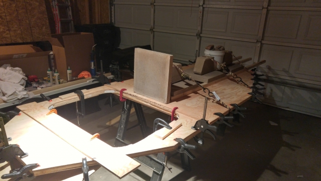

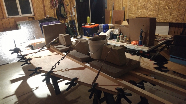

Sandwiching together

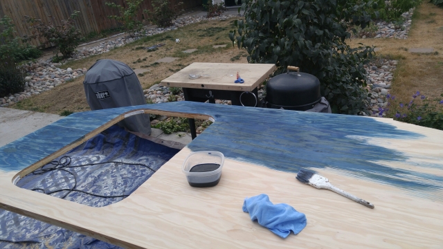

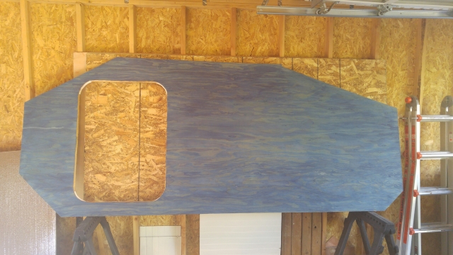

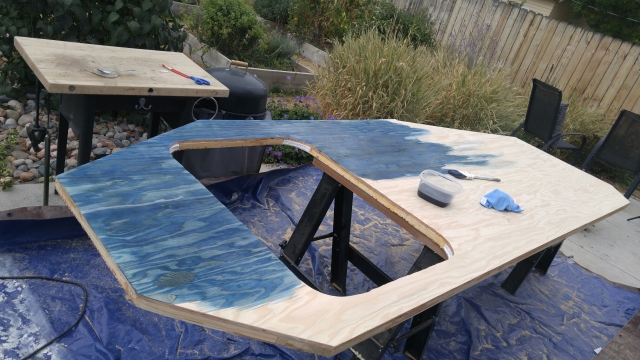

First coat of aniline dye
