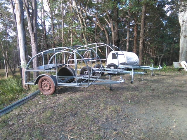

Any how I spent yesterday making two more Chassis because My brother Pete wants one and so does his mate Don and today I expect to have two New friends friends for my Tear that will be built at the same time, These ones will be single door jobs the same shape as mine but running a commercial axle and 14inch wheels rather than my vintage Morris wheels.
Chassis 003
Chassis 002
almost enough curves to make two sets of profiles
This tear drop building thing is infectious! :D :thumbsup:

yesterday My brother peter and I manged to make the foundations for two more Teardrops

More progress on two tears being made for my brother and his mate
yes its starting to look like they are -Breeding!
The one for may brother is actually about 100mm longer than mine

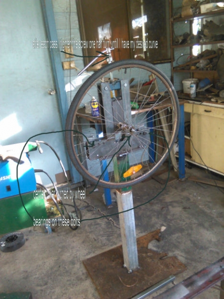

On your homemade roller ~ can you explain how that works please :-)

The principle of the roller is quite simple really there are two fixed points with bearings that allow the tube to roll between them and there is a third roller in the middle that can be screwed down and this roller is turned with the central wheel because of the pressure of the central roller as you turn the wheel the tube moves and each pass puts a curve into the tube. You keep rolling the tube back and forth until it has your desired curve.
I'm at Ocean View just north of Dayboro BTW :beer:

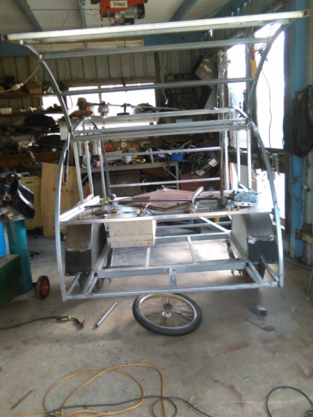

Is this a milestone?

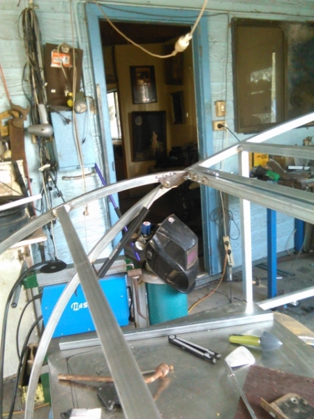

Anyway I now have my hatch on its own struts
Image Description
By putting my top mount below the frame it creates an over center action that makes the struts try to close the hatch rather than lift it which is the ideal situation

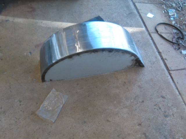

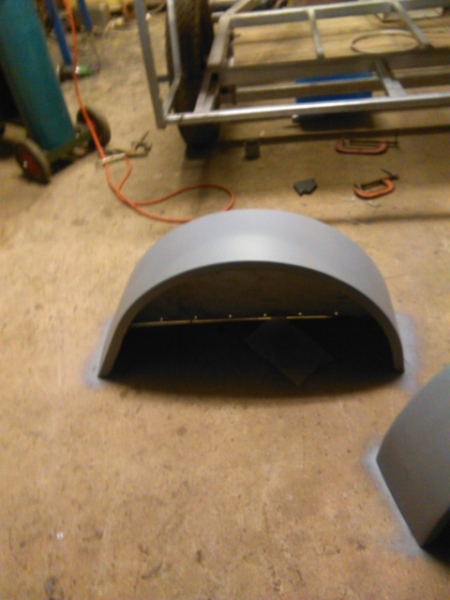

My guards were starting to rust so when I had to remove them I cleaned them up with a flap wheel and used a tiny bit of bog on the join then I undercoated them

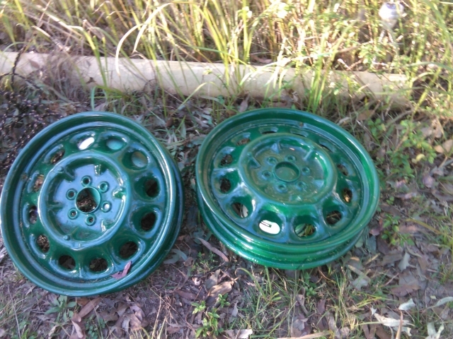

The wheels that I currently have on the trailer have 50 year old tyres on them so I have restored another pair from my collection and painted them Green I have some NOS motorcycle tires that will be fitted next week

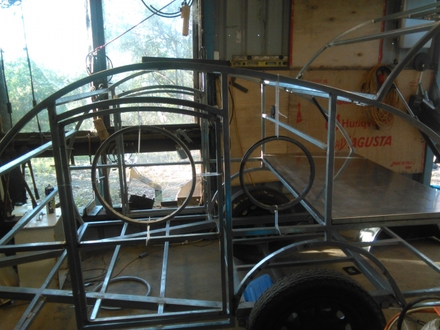

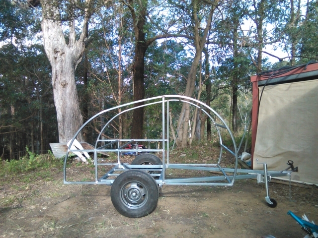

To work out my window placement I have used cable ties to suspend the bicycle rims I will split to make the dress rims for the windows
