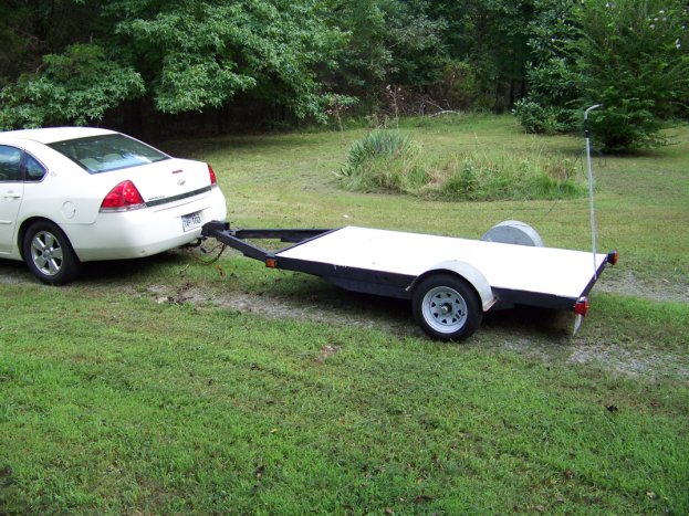

It's been a while, but I got it stripped down to a bare frame..cut back to what size I wanted. And re-welded the whole front A-tongue back shorter. Added a couple pieces of 1/8" x 2"x2" angle from the tongue angling under the tongue A-frame part to 2' back on the frame. Put a 1/2" exterior rated ply deck on it after a couple of heavy insurance coats of "the Mix". Put the trailer light kit on.. got the title and license. And took it out and around the country side to shake it down...changed the hubs out to no brakes with new bearings too.. removed the surge hydraulic brake assembly on the tongue. And took it out to town today and loaded some 3/8" plywood for the walls. It pulls straight... the deck and corners of the trailer are within 1/16" of square... new tires,,and hubs and bearings.. Tires seem very balanced and round even... the Chinese tires and rims are getting better I guess.. we managed to get up to 68mph and it seemed like it wasn't back there on gas mileage (still 34mpg) . Will be a different story when it gets more facing the wind when it's built though.. The fenders are temporary old tubs from the pop-up.

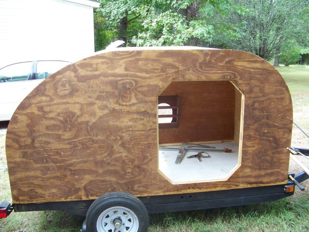

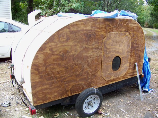

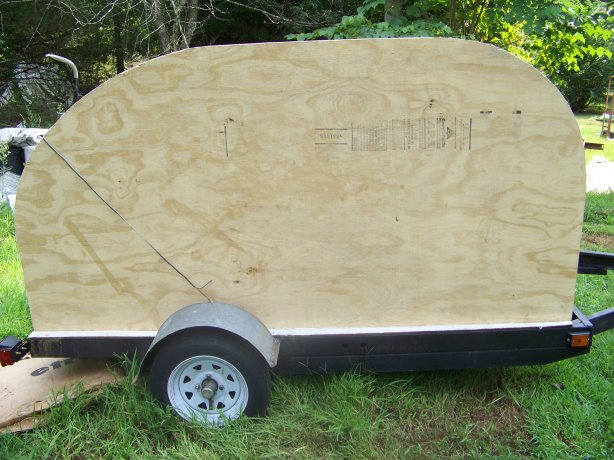

Drug the plywood off the trailer and cut it to modified Benroy...but a 24" front radius. Regular back. Still needs door cut out but looked like rain so I took both sides to my shop to work on them out there. It's a start.. Now to figure out if I want thin 1" sides and top or 1 1/2" by turning the "studs".. The side looks pinched in at bottom edges cuz it's tilted out on that wire to hold it upright.

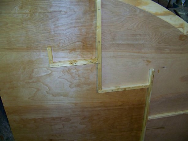

I have the yard kind of cleaned up from the demolition of the pop-up. I took the scrap alum into the scrap yard and got almost 70% what I gave for the trailer to start with. Even with today's low alum prices. I took the sides out to my shop to work on. Sides are sandwich 7/16" CDX outers, with 3/4" spars/studs and then 1/8" interior Luan. Outer is stained a Honey Oak with some dark Red Mahogany mixed in for some reddish tones and then one coat of thinned stain and 50% reduction of "the Mix". Interior wall is plain jane Honey Oak stain, with one coat over the stain of Marine
Spar Varnish/Poly.
Panels weigh 54/55 pounds with the Wiley windows cut in (door is included in right side weight) Trailer weight with the deck on and primer painted--lights-wiring, etc is 340 pds now.
Top panels are ready to install in one piece......they are lapped with some 1/8" ply reinforcing and all glued up to extend all the way back to the hatch hinge spars area. Not any finish on them yet. Probably will slap a few coats of "the Mix" on the top outside after the poly glue sets for a day or two. Then it's 2 coats of Kool Seal type roofing on the top. Nother month maybe?
Left side upside down.
Right side, the galley shelf attachments are mirrored with bracing/spars inside the wall.

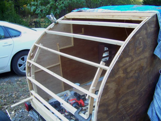

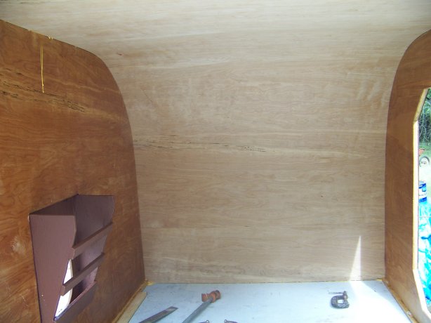

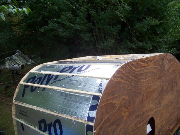

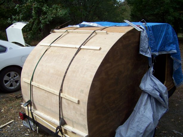

Some progress.... mounted sidewalls and interior roof and spars.. Insulated it with 1" rigid insulation. Had to cover it cuz I was getting tired.. I think I chatched up to the flu Friday nite about midnite. Nother story...nother time.
It's square!...waddya know.
Looking at the inside shot I think I need to go get that TBII run before it sets tight.. :roll:

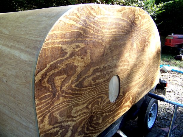

3 coats of the mix...now 3 coats of clear metal base untinted on the sidewalls. It's shiny. Tomorrow will be the hatch hinge and a couple of coats of elastomeric roof coating on top of the 3 coats of the mix on the roof.

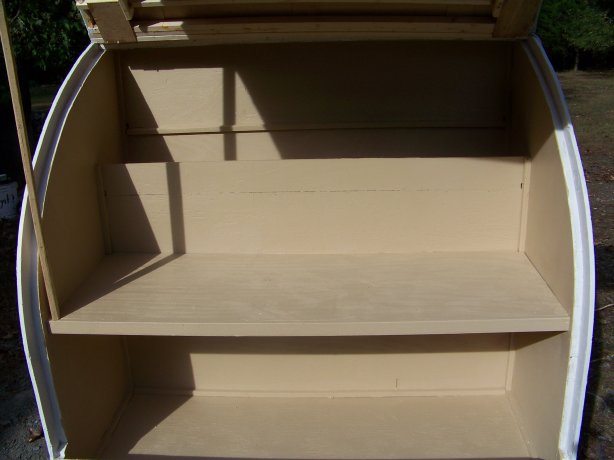

Light tan latex paint on shelving...left over from painting my front room a few years ago. Inside sleeping area is light stain and poly.
