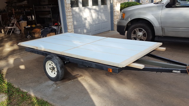

Today, after work, I got the rest of the floor insulation panels cut out and epoxied into place. It is supposed to rain over the next few days so I will have to do something else instead of dragging the trailer out into the driveway and sand down all the floor insulation panels level with the floor framing. Maybe I can start laying out the profile template for the sides.

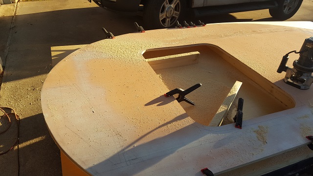

I got myself a dust mask and started sanding down the overly thick insulation in the floor panel, and sanded, and sanded, you know the story. After 3 hours I got it all sanded down level.

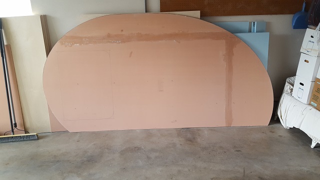

Rather than continue with gluing down the floor's top layer of plywood I decided to treat myself and work on the wall profile template. Here is the profile for one of the two configurations I am thinking of. This is the "door forward, raised bed platform" version. On the other side of the profile I am going to draw out the more tradition "mattress on floor with door in middle" version.
The door is drawn in pencil, I hope you can see it. I'm about 70% sure I'm going with the raised bed platform and the forward door. I don't like only being 70% sure of any design decision so I'll finish off the floor panel and continue to ponder before I go any further forward.

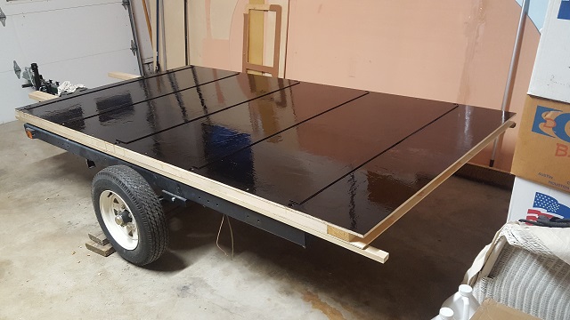

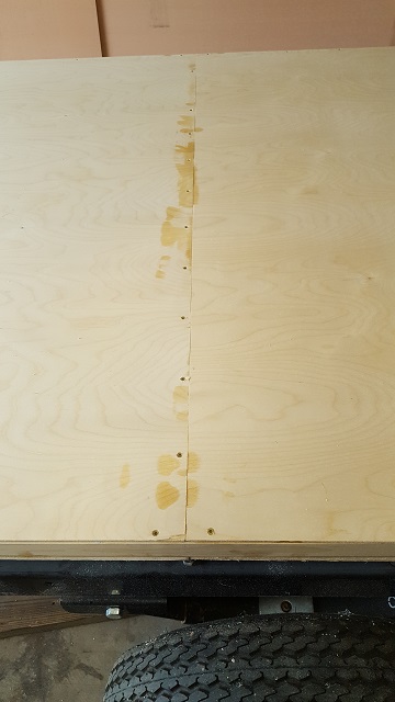

Today I glued down the two sheets of 1/4" baltic birch that make up the top layer of my floor. I used epoxy to glue down one one sheet and on the other one I used PL300 adhesive just to see how I liked it before committed to using it in the walls and roof for gluing the XPS sheets in place. I have to admit I was a little disappointed by the PL300. It seems to have glued the foam to the plywood okay but it did not glue the plywood to the poplar framing nearly as well as I expected it to. Even with a lot of heavy objects piled on top it did not glue down wood to wood very well. I wound up having to add some screws to the seam between the two sheets of ply as well as along the port and starboard rail.
After some plastic wood for the screw heads and much sanding I have an acceptable floor so I put down some Minwax Poly. Here is a picture after the second coat.

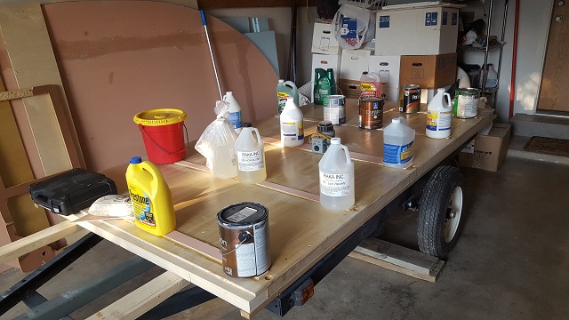

After two months I've finally gotten a little time in on Learning Curve today. Part of the delay is that I'm building in an un-air-conditioned garage in Texas.

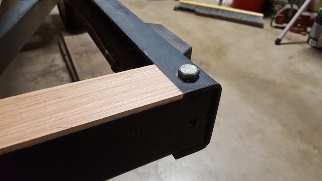

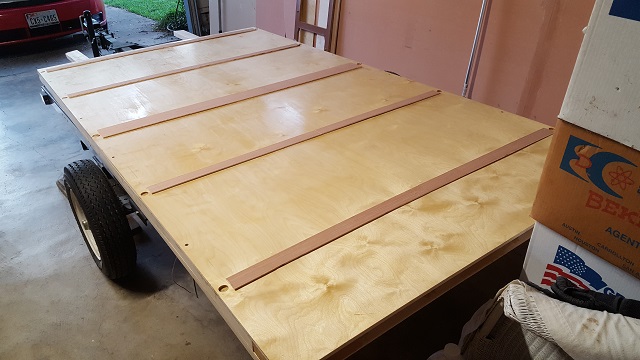

I've gotten two coats of poly on the bottom of the floor and I've cut some thin plywood material to fill in the gaps formed by the bolted pieces of the trailer frame cross members between the longitudinal rails.
I'll glue these strips to the underside of the floor so the wooden floor will be flush with the entire metal frame of the trailer. The bolt heads at the frame junctions will be recessed into the floor.
Here are the strips laid out on the flipped over floor. After gluing them down I'll continue with the poly and asphalt waterproofing and then I can finally flip the floor back over and bolt it down to the trailer frame.

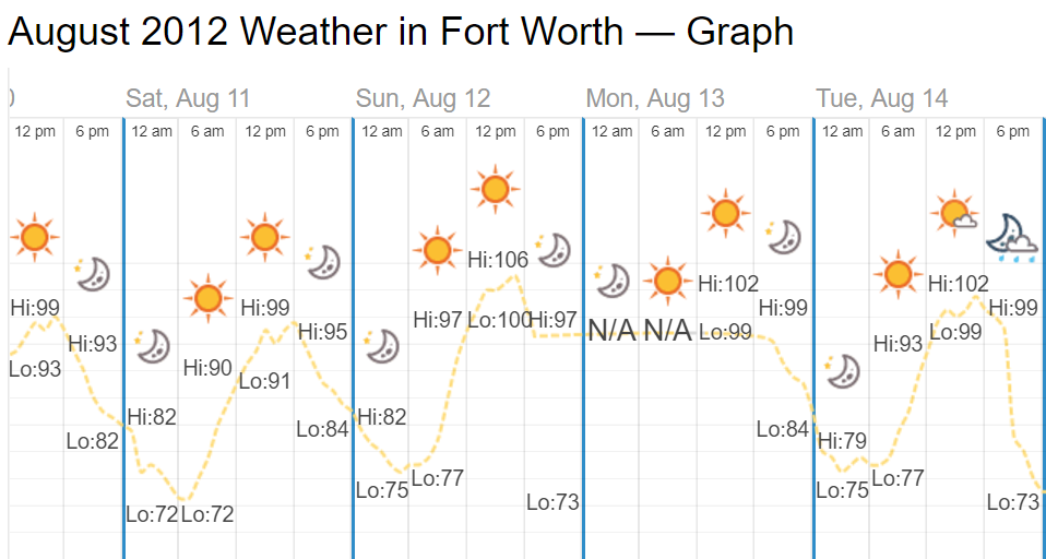

I feel your pain on the heat! Here's a pic of the temperature at 8:00 p.m. in Watauga (NE Fort Worth) on the day I was applying the poly to my teardrop's cabinets:

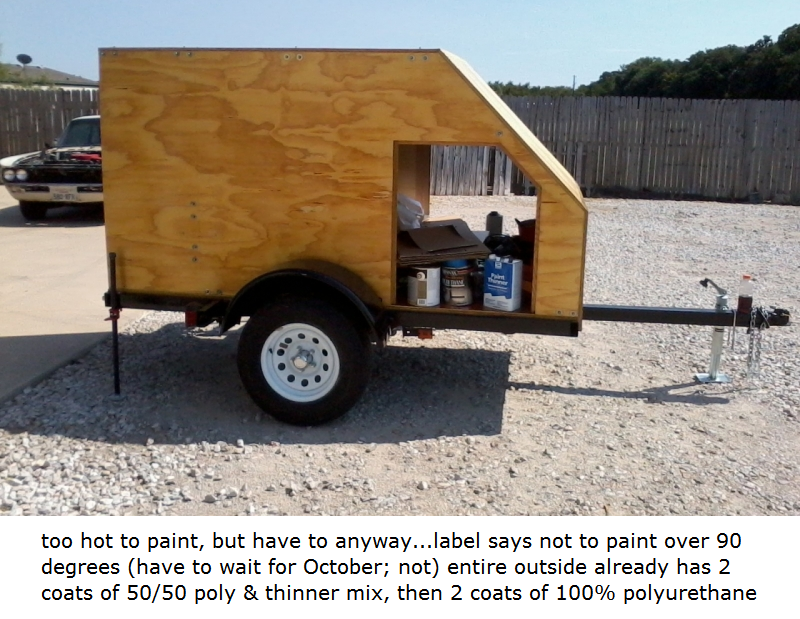

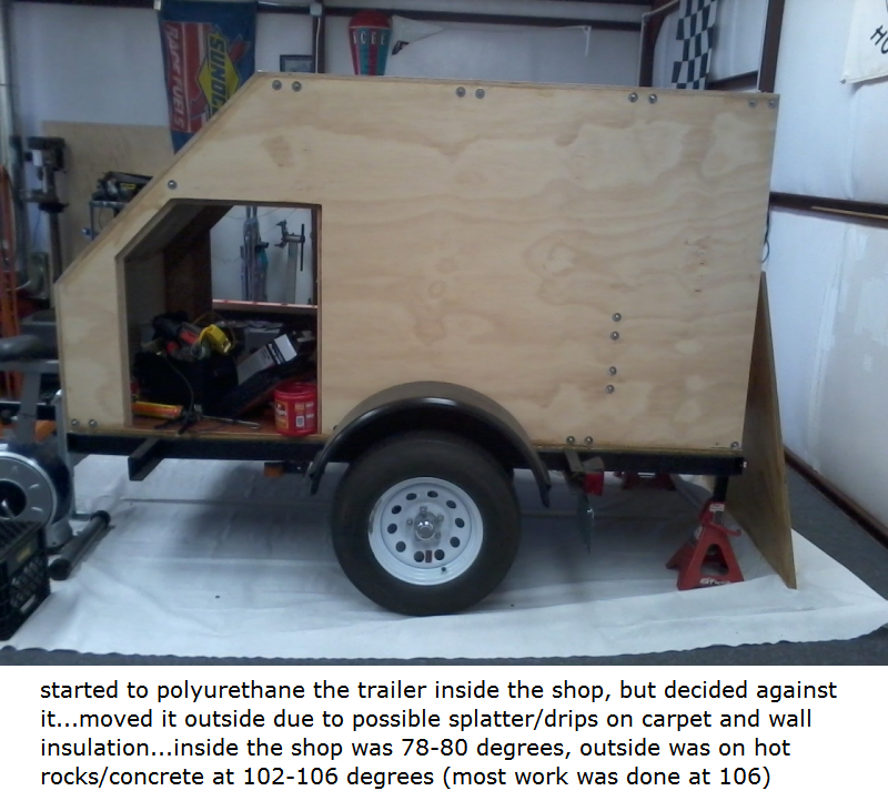

  • Been there, done that. The first 11 months of my build took place at my friends' shop/garage, a large metal building that was heated and airconditioned until the bay doors were opened for the constant flow of project vehicles into his shop. 90% were friend/family/race team cars which he and I worked on at the same time as on my trailer...sometimes inside and sometimes outside, depending on what was needed. Engines were pulled and degreased outside, as were heavy welding and larger paint jobs (no pro-type painting, mainly rattle can on frames and such).
  • Believe it or not, his shop had a turnover of 4-5 vehicles a week, plus 2-3 longterm projects, and 1 of his cars ('66 Nova wagon) inside, along with my trailer and crane/massive toolboxes/fans/2 shop vacs + a Dyson for the 90% carpeted floor/mills & drill stands/grinders & welders & torches (plasma cutter, too.)/etc. There wasn't much room to spare, so we were always moving things around for the best access (most cars were on wheel dollies, some on jackstands -he had 12). My trailer was the easiest to move, so it moved the most; I kept my parts & supplies inside it, for that reason. The inside storage precluded me from doing much work inside the trailer, so I had to do the entire interior at my garage, after I finally brought it home on the 12th month.
  • When I felt it was time to polyurethane, then paint the exterior, preparing it for transport; I wanted the exterior finished and sealed before the trip home (you know, Texas weather is unpredictable, so prepare for any/all conditions!). I started poly/paint inside his shop, and was worried by the proximity to top-notch paint on nearby project cars, the freshly carpeted area my trailer was on, and the insulated (spotless) walls nearby, despite my best efforts to avoid a mess. So, I moved a car or two, and rolled the trailer outside onto the chalk rock surround (to not drip on the pristine concrete, where only burnout marks were permitted...after all, we built drag cars here!). So, for three days (with the trailer back under cover at night), I poly'd/painted it outside on the hot rocks (reflecting/refracting heat back up towards me) under the brutal sun. The official high temperature the first day was 106 degrees (though I saw 110 on the gauge outside the shop). I was on vacation, so I spent upwards of 8 hours each day outside, painting, relieved only by 8 hours inside, under and over project cars, in the cooler shop.
    ready to start poly; moved it outside.png (900.24 KiB) Viewed 3928 times
    best not to splatter paint on expensive cars, walls, or carpet!
    outside in 106 degree heat.png (903.27 KiB) Viewed 3928 times
    wow!, it was hot; the reflected heat from the rocks made it worse
    painting temp.PNG (113.5 KiB) Viewed 3928 times
    Sunday, Monday, Tuesday in the heat (actually hotter than the recorded data, at that location)

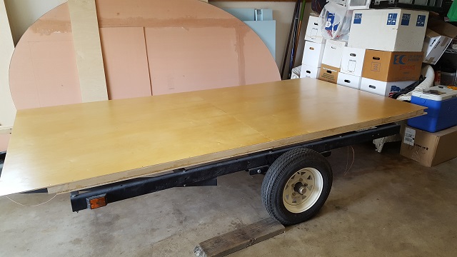

I got a little more time in today and epoxied down the plywood strips to the bottom of the floor. The thin, cheap plywood had curled a little so I had to weigh them down with whatever I could find.
Maybe tomorrow I can get another coat of poly on the bottom and then start with the asphalt roof coating that will be my final waterproofing for the trailer bottom.

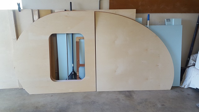

The Texas weather, family commitments, spare time & energy, and the stars all aligned this past week and I got some great progress in on Learning Curve.

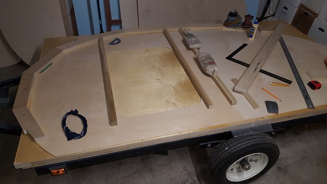

I have been able to cut out the outer wall skins from 5'x5' sheets of 1/4" BB and I have started framing up the starboard wall with 1.5" poplar. If it looks like the roof plate is made from 2x4's it is because it is. It will be routed smooth with the edge of the outer wall skins and then a ledge will be milled into it for the roofing material to rest on. The roof is going to be made up of 1/8" BB headliner, then two layers of 3/4" XPS foam board, and then two layers of 6 oz fiberglass cloth and epoxy.
