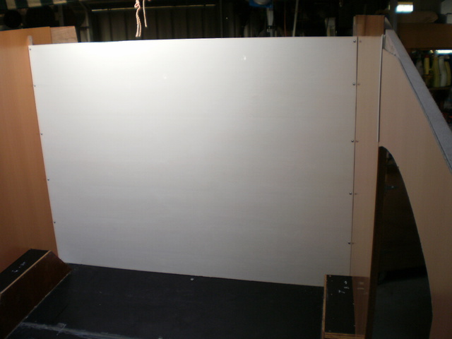

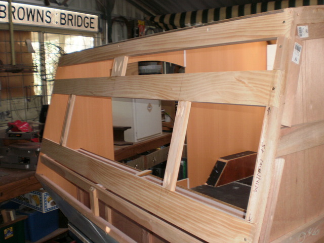

Internal cladding (3mm ply) and the front storage box

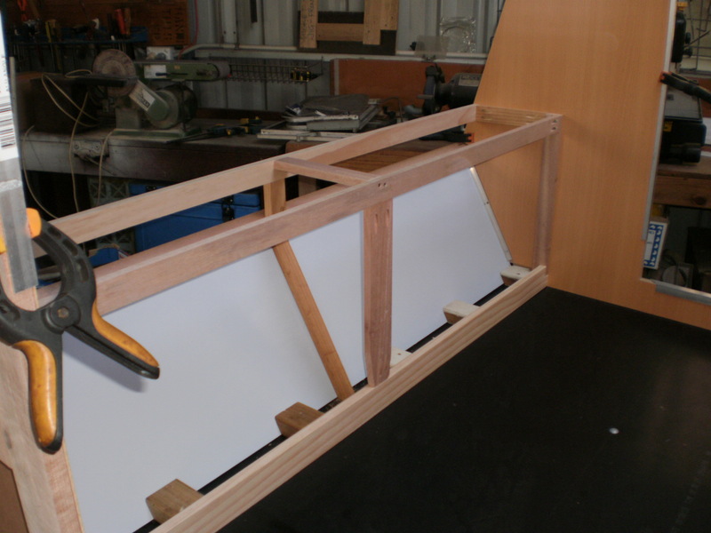

Bulkhead between sleeping area and galley added
Frame for front window

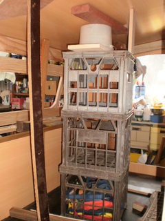

Galley with countertop, IKEA Trofast drawers and sliding door cupboard

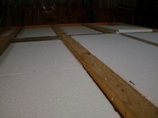

Roof framing. I used 90x45mm CCA treated pine ripped to 45x45mm sections
I used anything I could lay my hands on to support the ceiling whilst the glue dried

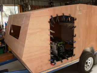

40mm polystyrene foam insulation in the roof space

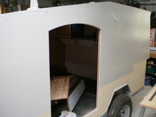

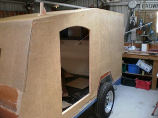

The outer skin being installed. It is 6mm marine ply
I decided to go the PMF route but a bit more heavy duty. I used hessian (burlap) as the covering, glued with Titebond 2.

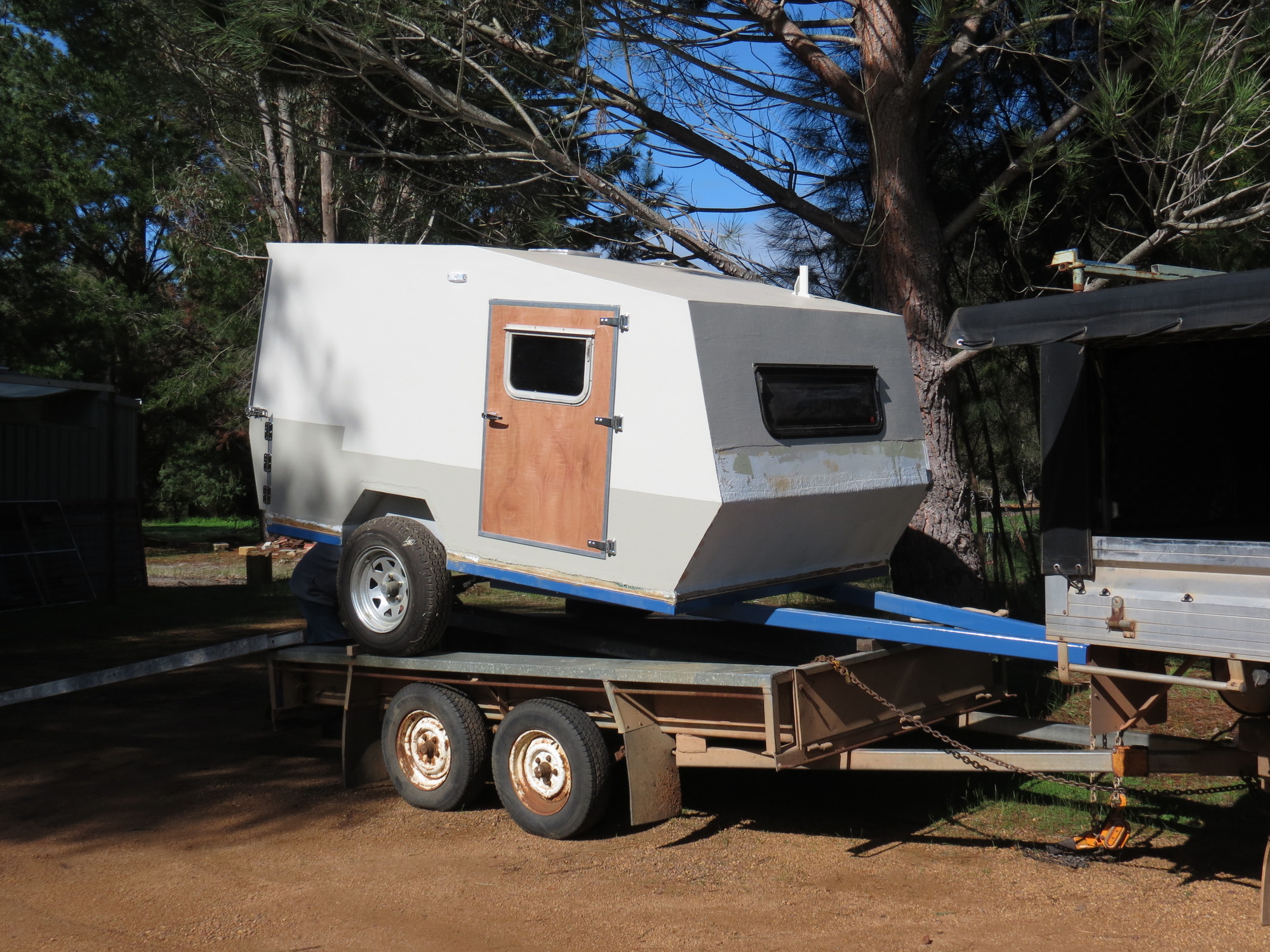

I applied 10 coats of paint but still ended up with a textured surface from the hessian. I decided it didn't look too bad and left it that way.

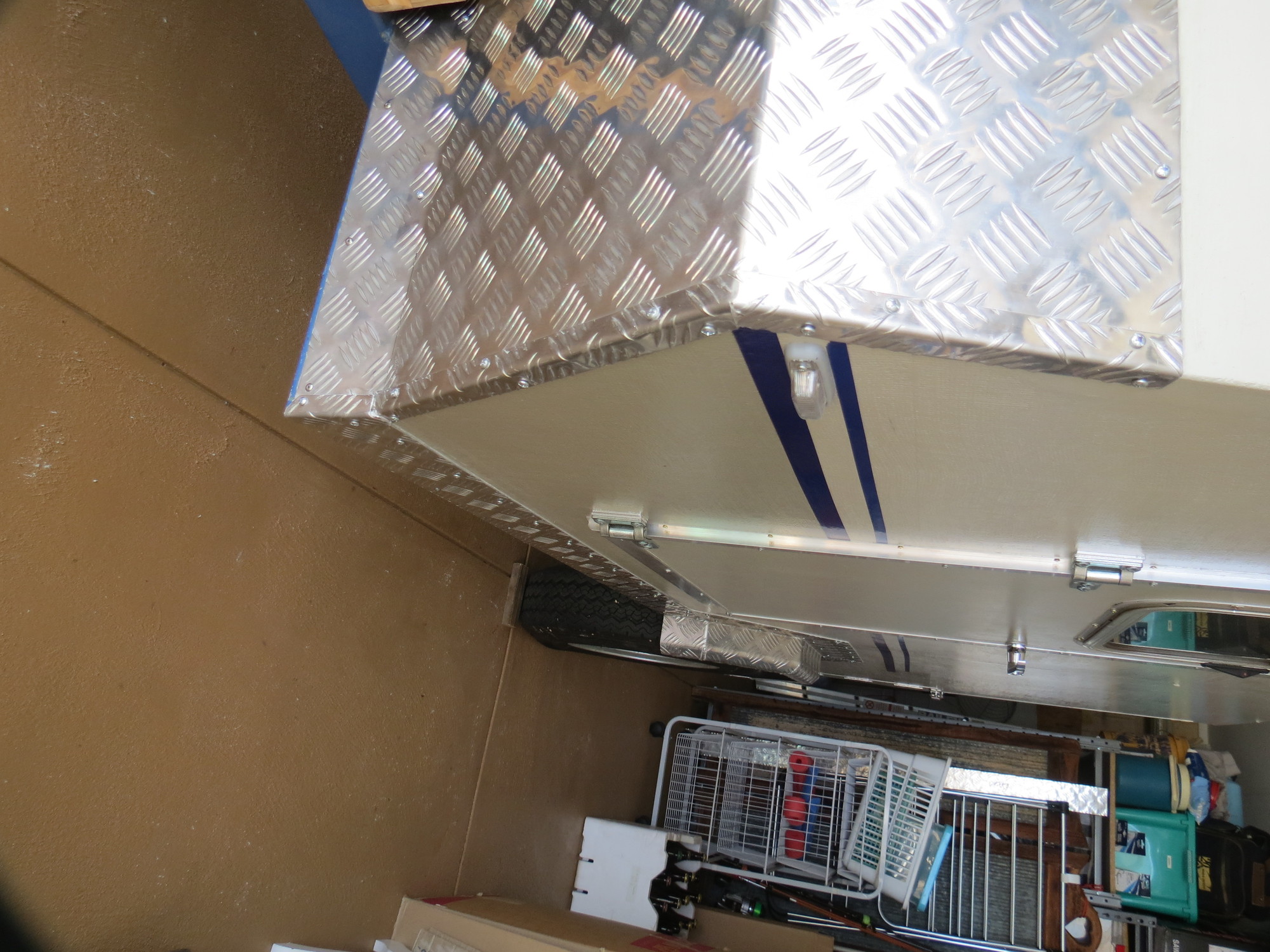

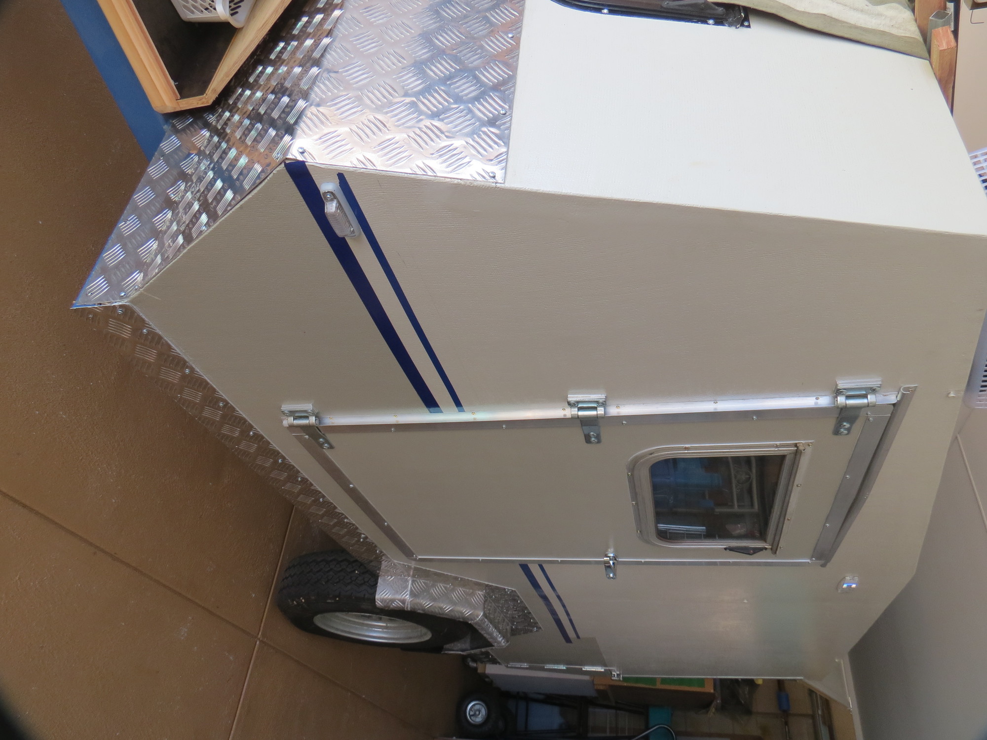

Loaded onto a trailer to take to an aluminium fabricator for the trim and mudguards. Note the new door profile. I had trouble making a seal for a curved door and decided to "square" it

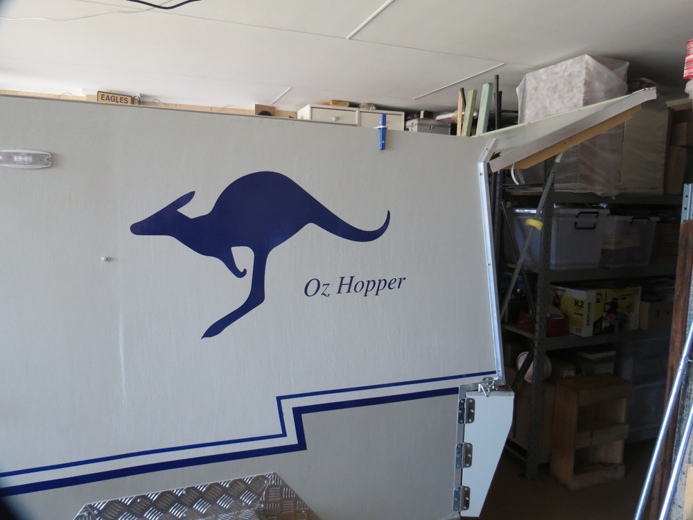

Aluminium trim, mudguards installed. Doors finished and sealed, marker lights as per Australian Regulations installed

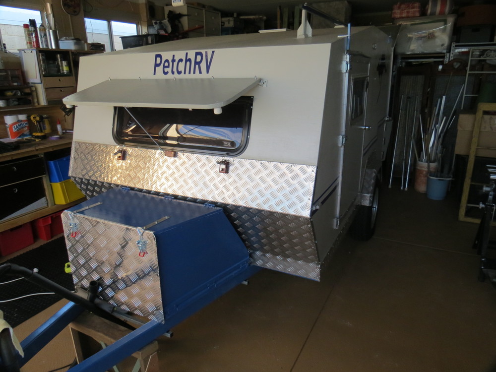

Corner trim is complete and almost ready for licensing
I hope these photos have been of some use.

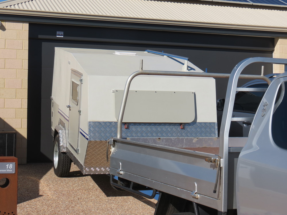

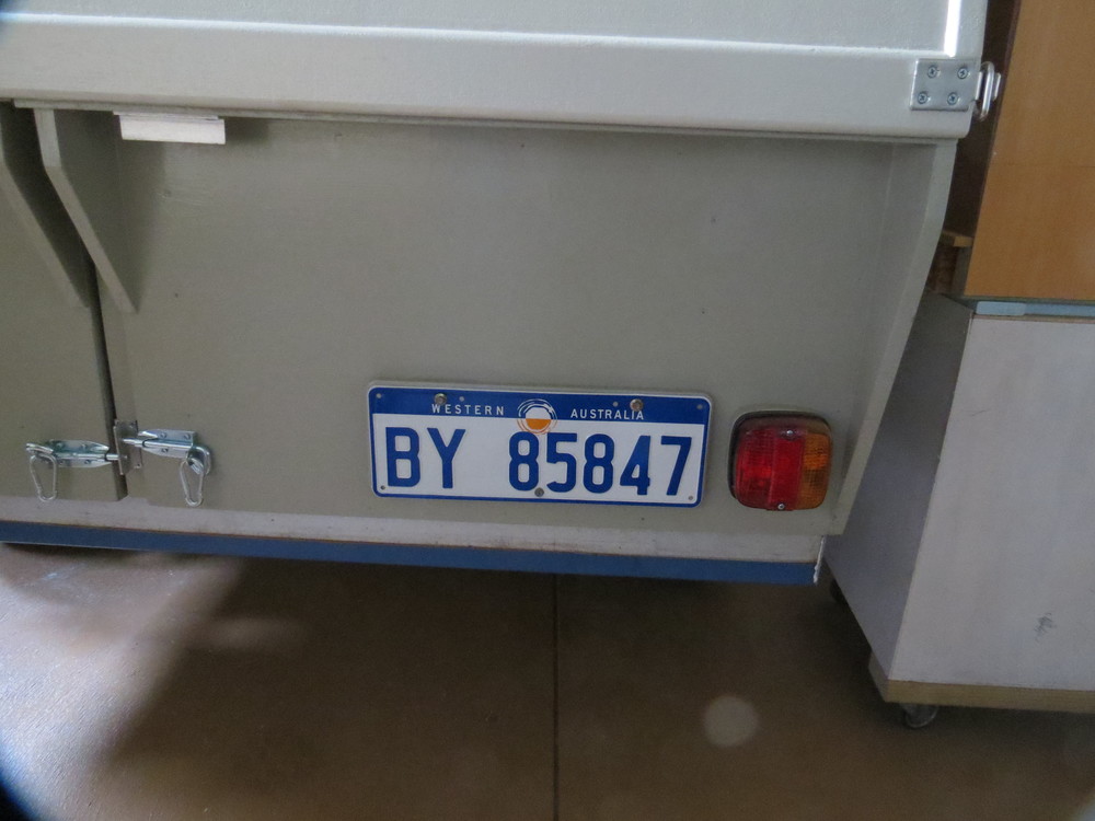

Today I took my hopper into the local Licensing Inspection Centre
All legal and licensed
Just a bit of dust sealing and other minor jobs and it is ready to go.

The time has come to test the Oz Hopper on the road. Since my last post I have been applying the final touches, building a combined battery/Porta Potti box for the front of the trailer and applying some relevant decals. The "Petch" in PetchRV comes from a combination of my first name (Peter) and the start of my surname Ch........
