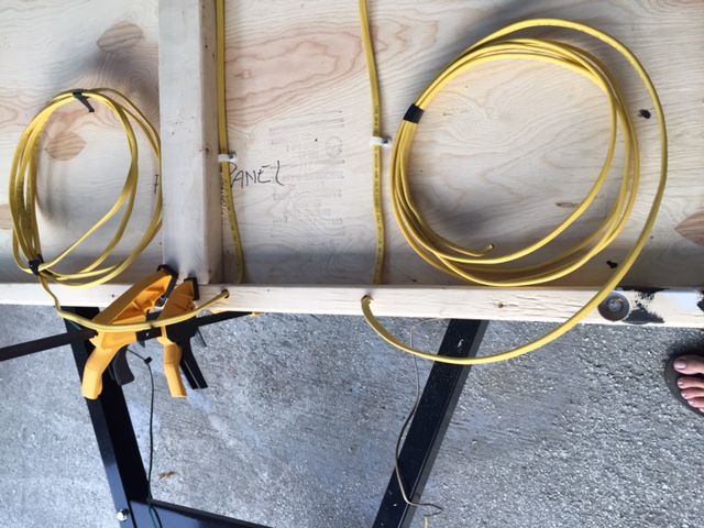

I was able to finish what I wanted to get done yesterday. Completed laying the spars and screwed them together. I ran 2 separate 12 gauge from the galley to the header. I made a 90 in the header at each location. the wires will be ran through the front bulkhead. The wire near the center spar will be ran up to the cabinet above the head of the bed and 1 exterior outlet (used to run the A/C Unit).
The other wire will be used to run to the battery on the tongue to the smart charger on the mighty mini that will be installed in the galley. All the DC wire will be ran through the ceiling.

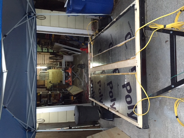

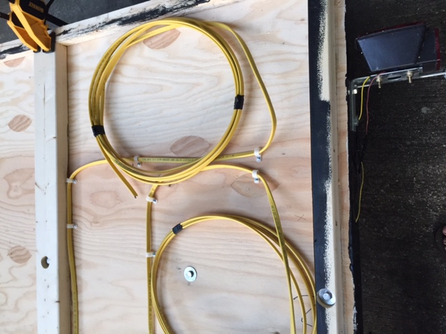

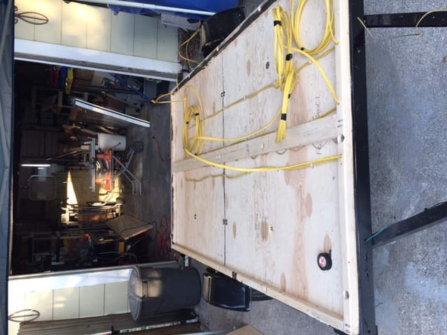

Before i put down the insulation I decided to run another electrical line to the front. After reading through some previous posts I took m.colley's advice about running the A/C off a separate breaker. (Pic 1)

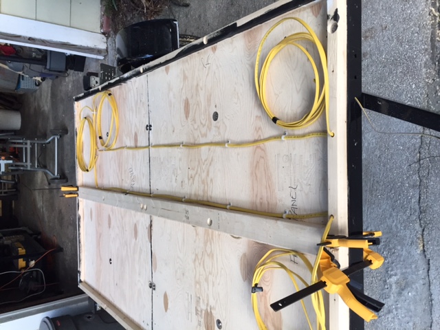

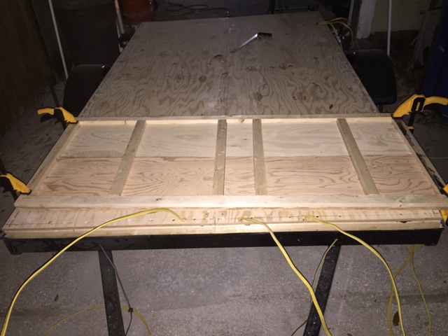

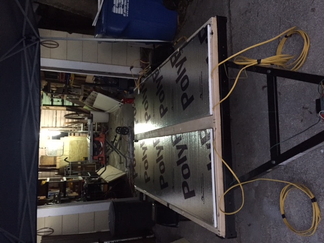

Finding 1.5" insulation was just not happening locally. I decided to go with separate sheets of 3/4". this actually worked out better. Instead of carving channels in the full 1.5" panels for the electrical wires as I planned, I put down the first layer in sections. (Pic 2)
I then used a 3M Heavy Duty spray adhesive and put down a full panel on top. (Pic 3)
After that I drilled hole locations where my wires will run through the subfloor and placed them on top to hold it all together. (pics to follow soon) I haven't secured it to the stringers yet. I still have to dress the rear edge and cut it to size.

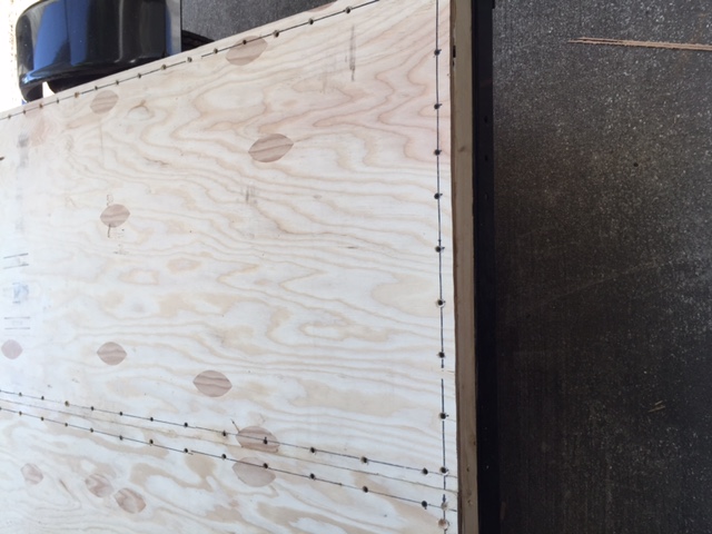

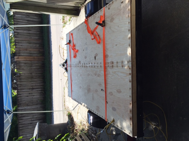

Sunday, September 11, 2016 - Finishing the deck
I put the glue down and strapped the deck down. It is as square as possible. The top plywood will require a little sanding on the sides so the walls fit nicely bu only 1/16th" and inch at most.
Once the glue set, I countersunk and screwed the deck down.

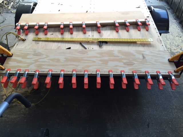

Sunday, September 11, 2016 - Bulkhead

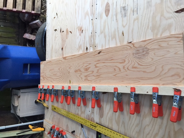

The plans called for a single sheet of plywood 24" x 58.5" I did not have any remnants of the marine grade plywood available thats size & I did not want to buy another sheet, so I improvised and used (2) 12" x 58.5" pieces. I aligned my top and bottom spars, glued, clamped and once the glue set, countersunk the holes and screwed them in.
I then aligned the 2 pieces and glued on the side spars and cut the spars for the middle to create the channel for my electrical to go to the overhead cabin cabinet. The other 2 wires do not require a channel as they will be going a short way and will be run to exterior electrical boxes.

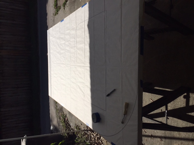

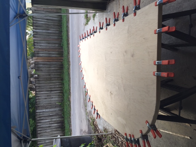

I put both of my sides on top of work horses. I used the template provided to me from Big Woody Campers. Lined it all up and made sure the length was at 8'. Pic 1.

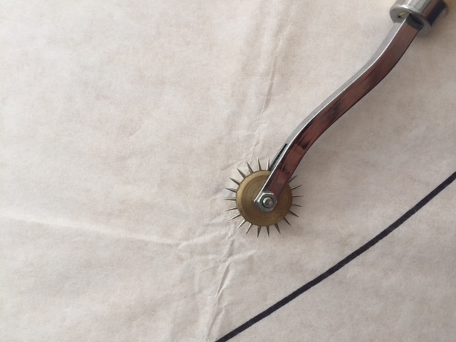

My wife is an artist and has all kinds of little tools. I used this spiked roller to trace along the lines on the template. (Pic 2)
I then took a black sharpie and traced over the lines. This left me with a nice connect the dot pattern underneath the template. My wife has a much more steady hand than I do so I had her connect all the dots for my outline.
Used my little Rigid jigsaw and changed the blade often, moving the workhorses underneath to either avoid the blade or support the cut edge from drooping down and jamming the blade.
I left about 1/8" off the line and used the belt sander with 80 grit to get in closer. I'm having a hard time getting the 2 edges square (switched to palm sander with 100grit). I posted a question in the general section about using a electric planer to square the edges. Anyone ever try that method?

Postby KCStudly » Thu Sep 15, 2016 7:04 am
One of the big things I have stuck to on my build is the theory that, "I can screw up so much faster with power tools." If it was me I would try a hand plane and then maybe switch to a hard sanding block for the final "perfection". But then again I may have more of a critical eye for the details than some (and my build has not been a quick one).
Another trick would be to keep a small combination square handy and check as you go.
I picture your walls laying down and you holding the sander sideways looking down at the profile edge. Have you tried standing your walls up and looking along the length while sanding? It is important to position your work (or yourself) so that you can see and control whatever tool you are using. This may seem obvious, but since you didn't mention it...

Postby noseoil » Thu Sep 15, 2016 7:36 am
The best tool would be a router with a flush-cut bit. A 1/2" flush-cut bit has a bearing on the bottom, which acts as a pilot for the cutter. Basically, clamp the two sides together with the larger side on top. Then set the depth of the bit so the bearing rides along the bottom side's edge (this is actually your pattern). The router will then take off the extra material & leave you with two perfectly matching sides. This would be the best, fastest & easiest way to do the job.

Postby KCStudly » Thu Sep 15, 2016 7:51 am
To elaborate on what noseoil said, I would agree on the router if you have taken the time to make a pattern and get that pattern exactly the profile you want. the pattern can be made from thinner, less expensive material and would be easier to sand accurately. Also would come in handy throughout the build as a reference.
However, like I said, you can screw up really fast with a router running freehand, and just matching one imperfect profile to the other doesn't necessarily get you to the line, or square on both sides.

Postby toconnor602 » Thu Sep 15, 2016 1:05 pm
KCStudly wrote:One of the big things I have stuck to on my build is the theory that, "I can screw up so much faster with power tools." If it was me I would try a hand plane and then maybe switch to a hard sanding block for the final "perfection". But then again I may have more of a critical eye for the details than some (and my build has not been a quick one).
I started out standing and sanding exactly how you described. Once I got down to the palm sander I put my butt in a chair and got eye level with a combination square, but saw no signs of improvement on the areas I was working. I was too reluctant to go back to the belt sander sitting down since I dont want to remove too much material.
